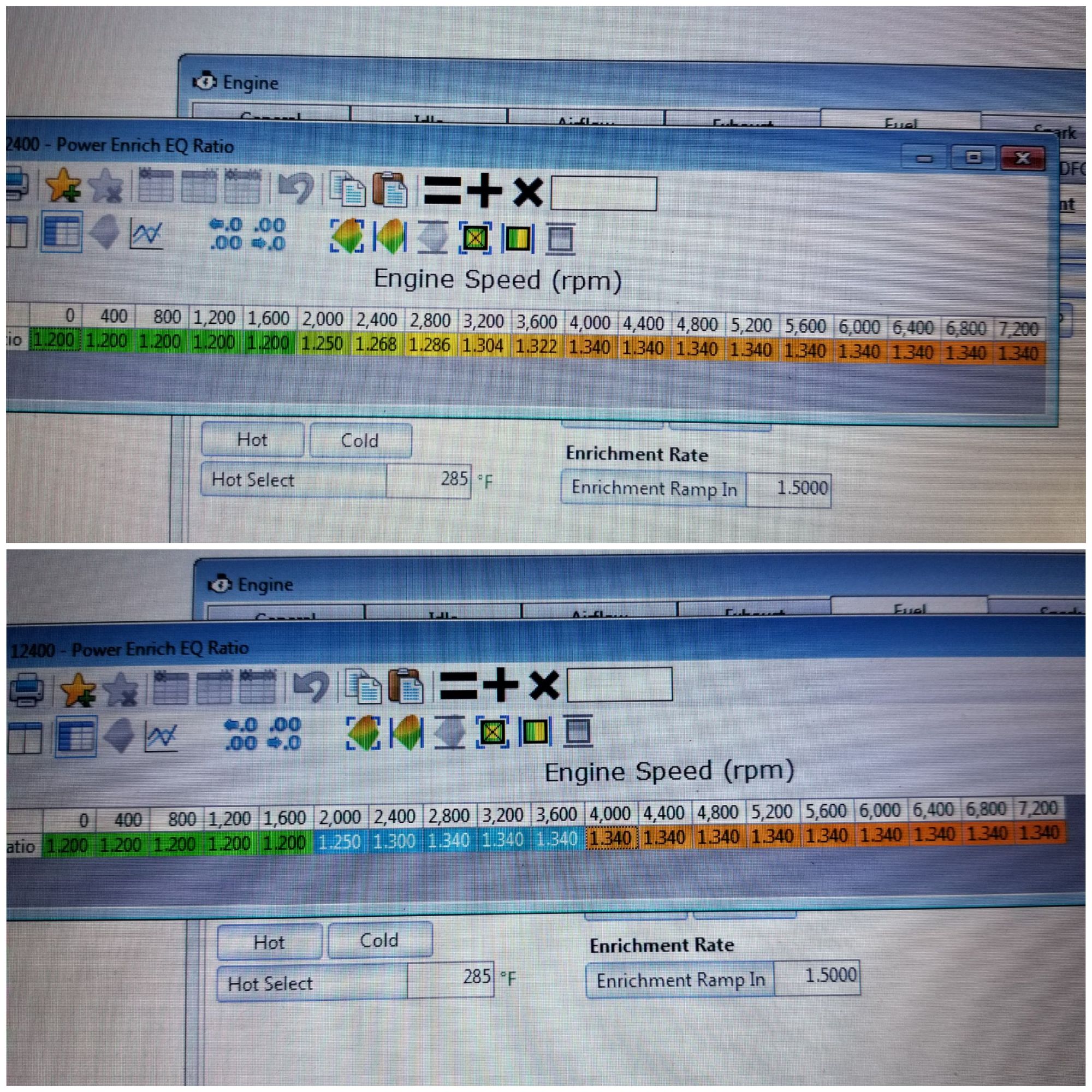

Below you can see how I have my PE setup. The bottom table is what I had when the car ran good. I was told that I had it ramping in too Rich too early in the rpms so I changed it to what you see in the top table.

Have you tried going back to the old tune when you said it was too rich on tip in? Your timing falls off pretty hard when youre barely in boost. Your absolute pressure is only a few psi and you chop the timing down to mid teens. That seems very conservative on E85. Your leaner than commanded on tip-in but nothing crazy.
Yes, It was doing the shuddering with the old PE table. I was told by a tuner that I had the PE setup to where it was too rich too early in the RPM range. I was commanding 11.0:1 A/F at 0 kpa and was told I didnt need to have it that rich that soon. So blended it some.
About the timing: Before, when the car was running good, I had the timing at 18* at wot. Ever since it started shuddering and popping out the exhaust, I dropped the timing down to 12* to be safe until I fix this issue. After I installed the new spark plug wires the popping out of the exhaust went away.
Yeah 11.0 right when entering boost is too rich. I guess Im curious if you go back to your old timing how it would run too. Just seems odd that youve changed the tune AND had fuel system issues when the problem started. Logging fuel pressure would be useful but the measured AFR looks ok. What do all 8 plugs look like. Did you just do wires or replaced the plugs too? Have you tried a temp gun on the primaries or killing each injector 1 by 1 to see if maybe youre down a cylinder?

The good news. adjusted my PE table EQ ratios, and installed new plugs gapped at .020" and the car ran great. Smooth and powerful. I made 2 4th WOT pulls up to 4800 and got the AFR error within 1-2%.
