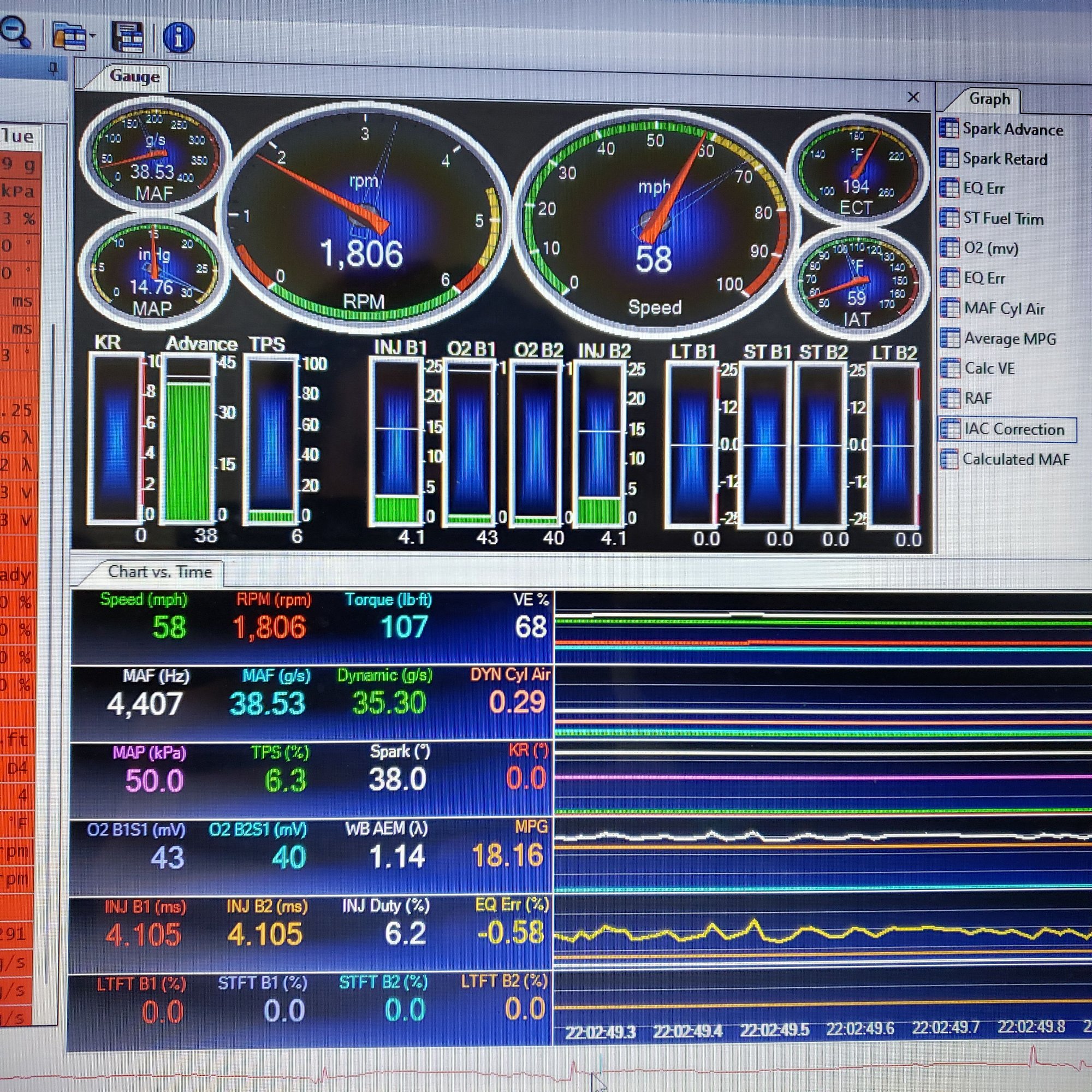

So I decided to play with lean cruise a bit in my GTO again. I did it years ago and found it was not worth it, but I got bored. The factory Aussie tunes have spots that go as lean as 17.8/1, but that gives a lot of lean misfires on the GTO. Long story short, after putting in values to equal about 16.3/1 in several cells, the computer glitched on me and started commanding exactly 32/1 while I was driving down the interstate. It did not quit below 47mph, either, as it was supposed to. It only returned to 14.68/1 after I pulled over to 0mph. After that, it ran fine. No idea what may have caused this glitch, but I am going back to my previous idea that lean cruise is not worth messing with.

Would you mind posting the tune where the computer was commanding 32:1 in lean cruise?

I changed the tune without saving it, but here is the log from that fun little ride. Don't mind the screwed up fuel trims, I had just re-enabled the maf and had not finished tuning for it.
