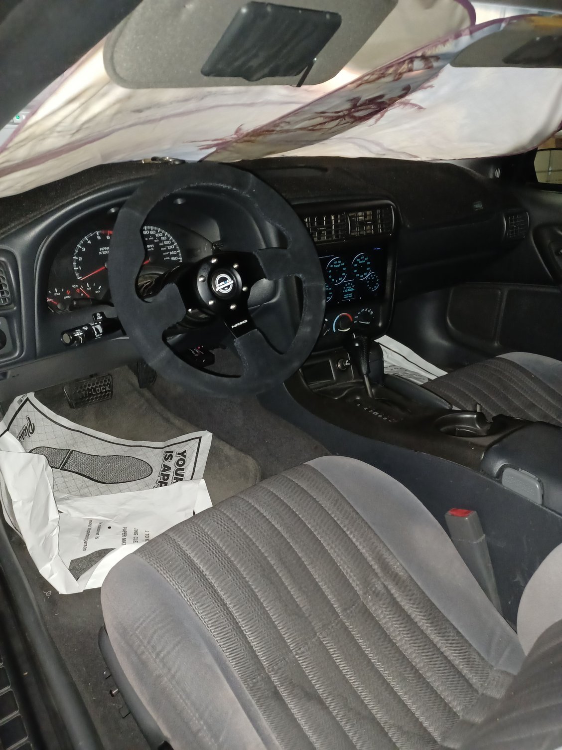

So you want it as factory as possible? Easy. Hp tuners. Windows based tablet where radio goes. Bluetooth amplifier. Run hp tuners data logging to the tablet. Or build a fiberglass dash bezel and remove guages. Just Keep guage wiring intact to swap it back for emissions. Done.
Old Aug 25, 2023 | 01:25 PM
Bspeck82's Avatar
Joined: Jan 2017
Posts: 1,758
Likes: 442
I use the torque app for data logging. May switch to a windows based tablet soon. But this has everything I care about, primarily trans temp.
I'm already using HPTuners. I freakin' hate Windows; no way I'm permanently installing it in the car. It's bad enough that I have to use it for tuning.
I want something with wideband closed loop, where I can set my own AFR targets at different RPMs and loads. HPTuners can't do that, as far as I know. I am 99% sure it would be possible if they'd put in the work on a custom OS (and in fact I'm told that someone has done that work; it's just not available commercially). For example, you can wire a wideband in to the EGR sensor circuit, which is unused on '01-02 cars; from there it's only a matter of using that data in the software instead of the narrowband O2 data. If they did that, it would cover 99% of the reason I want a custom ECU. I'd still be interested in aftermarket for a few other reasons -- CANbus integration and datalogging being the most interesting.
I do want to do a custom digital dash someday. It'd be full custom software, because I'm a software engineer and that's where the fun would be for me. That of course means I'd have to custom build some hardware, and for that I'm going to need to partner up with someone with that skillset. I have some friends who could probably do it....
I live in Michigan -- no emissions inspections or anything like that here.
