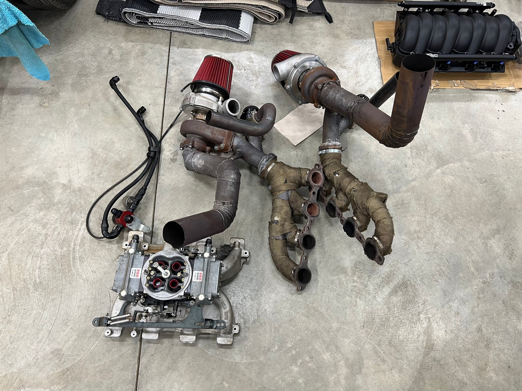

After doing blow through and catching my car on fire, and having terrible tip in response, and only having 3 companies really rebuild blow through carbs I've decided to ditch the carb set up and go EFI
In addition to this I realized a lot of the street car classes specify that I need a hood covering the entire engine bay. So I will also be relocating turbos to fit inside the engine bay so I can put a hood on the car. I got the cheapest mirror turbos I could find which so happen to be T4. 67/62's by vs racing. The turbos should be good for 1300whp+ but I'm pretty happy with 430 ish wheel on 8lbs on street tires when it's dry outside. I want to invest in some traction control so I can get more rowdy with my boost levels and tunes without writing off the car.

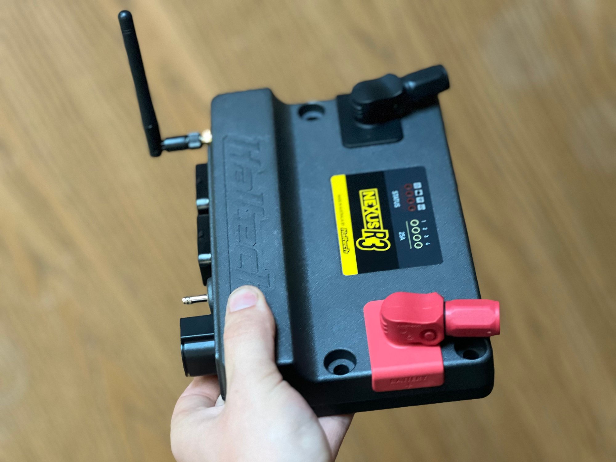

I've never tuned before and I had some members from LS1TECH give me their nexus R3 LS tune files and I've been slowly chipping away at it. I've also got a harness made by Tuned By Shawn that should be plug and play
Today I need to keep working on the base tune file, and working on assigning outputs for the correct wires and sensors on harness as well as CAD some brackets to get sent out for laser cutting
Right now the Slova is at a friend's 40' x 80' heated barn shop for winter and I'm excited to get the band saw and Tig welder out to work. I've never tiged an exhaust before so this will be a learning experience. Going to have many after work nights working on the car and sleeping in the barn
I spent the money for 1 months subscription of Ewans Performance Acadeny for Haltech NSP software and I've been trying to absorb as much as I can as fast as I can

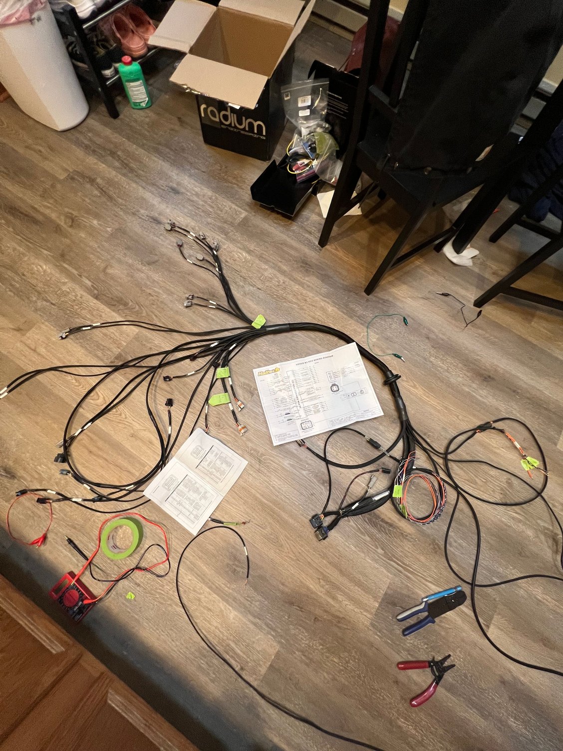

If you want to be amused, I just spent 3 hours checking and correcting pins only to realized I was counting pin numbers backwards
Anyhoo
Trying to figure out if I need the alternator wires (18 gauge exciting wires?) if I have a 1 wire alternator I plan to use.
Also I want to use the on board map sensor, but still have the hole and wiring connector for the one for the intake manifold. Wondering if I can acquire a junkyard one and have it just kind of there as a reference and using the on board one for all the offset tables
Also not sure what to do with steppers if I have dbw and no IAC

But my confusion came from the harness that I purchased. It has 2 wires that say "alternator" on em, and they are wired to 25 amp output on the VCU. Which doesn't make sense. One of the "alternator" wires goes to the injector power, which makes sense as a DPO, but the other end going to the alt doesn't make sense.
I think it's because the harness I have is a converted elite harness and it got its power from the alternator to the inejctors
The alt I plan to run says it's a 1 wire with no need for an exciting wire

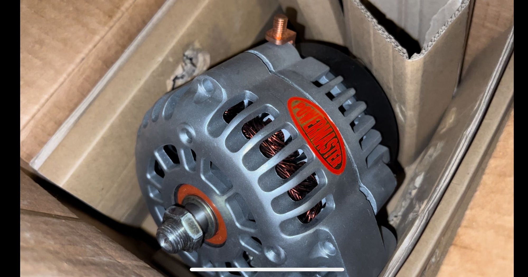

See the big copper lug on the case? Don't ignore it. Run a 4 gauge cable from that lug to the engine block. Also, be mindful of alternator RPM. PowerMaster clearly states not to exceed 1.85k RPM. Do the math with your crank pulley and select the appropriate alternator pulley. I'd guess a 2.85" pulley should meet your needs.

PWM-482478
Yeah I got a 3" one, may under spin it at idle but hopefully everything I have draws less current as I wanted to run a 14 volt battery. I actually forgot to add it in the parts list I first ordered
When I get time at home where the harness is I'll explain the pins and wires going to the alternator that do not make sense. The r3 vcm should only need it's 1 big positive and negative to get enough current to all the pins and having a 25 amp DPO doesn't make sense to be hooked up to vehicle + voltage since it won't matter the state of DPO pin if it's hooked up to +12 v source all the time

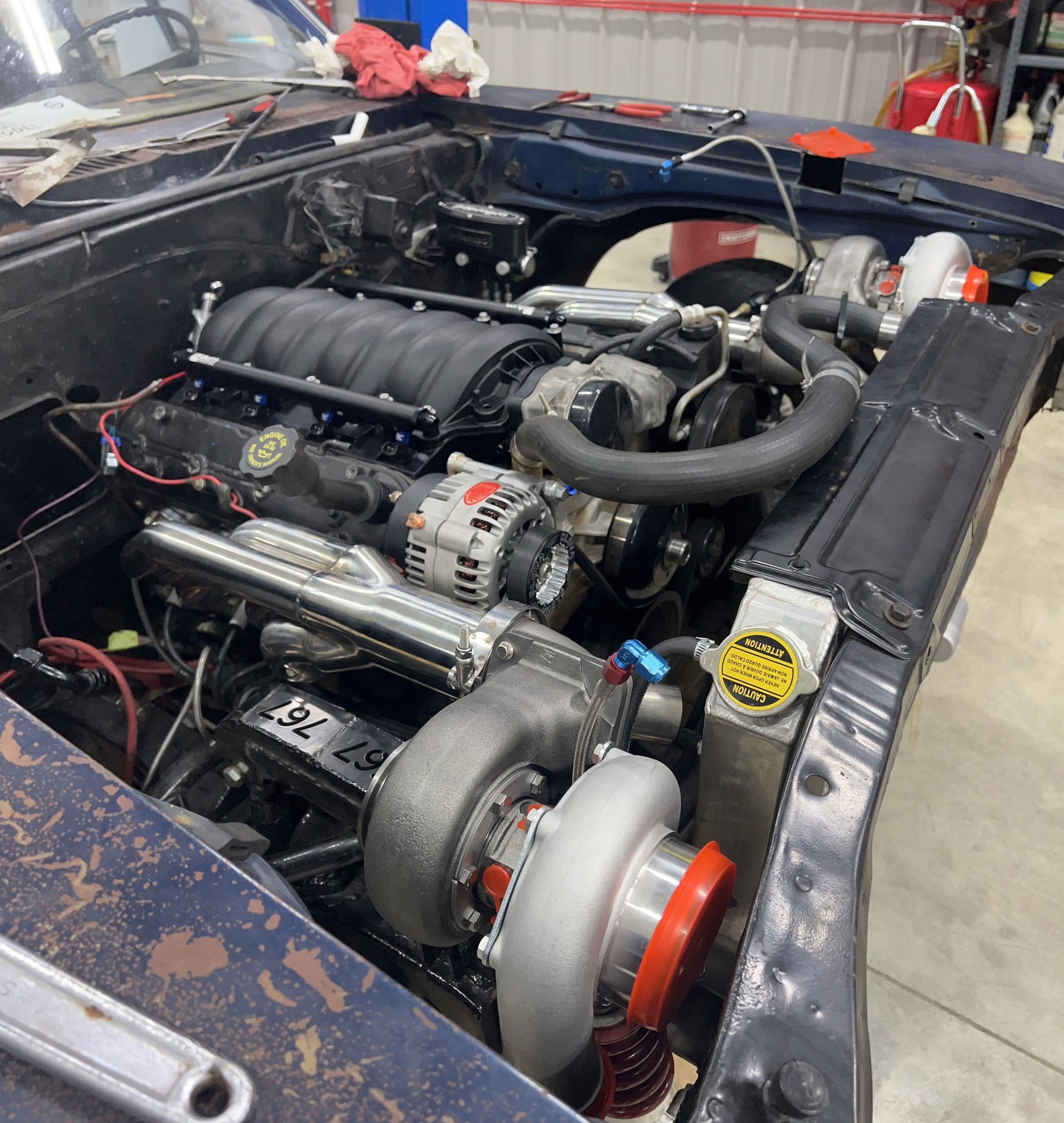

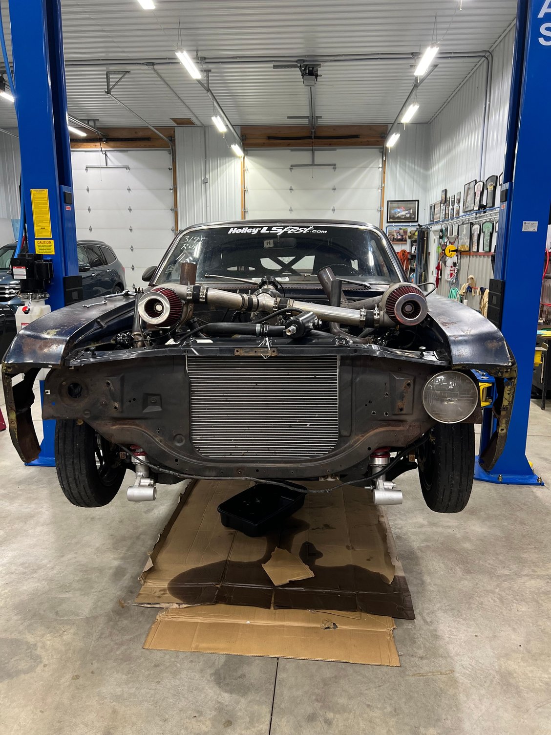

Here's how she sits

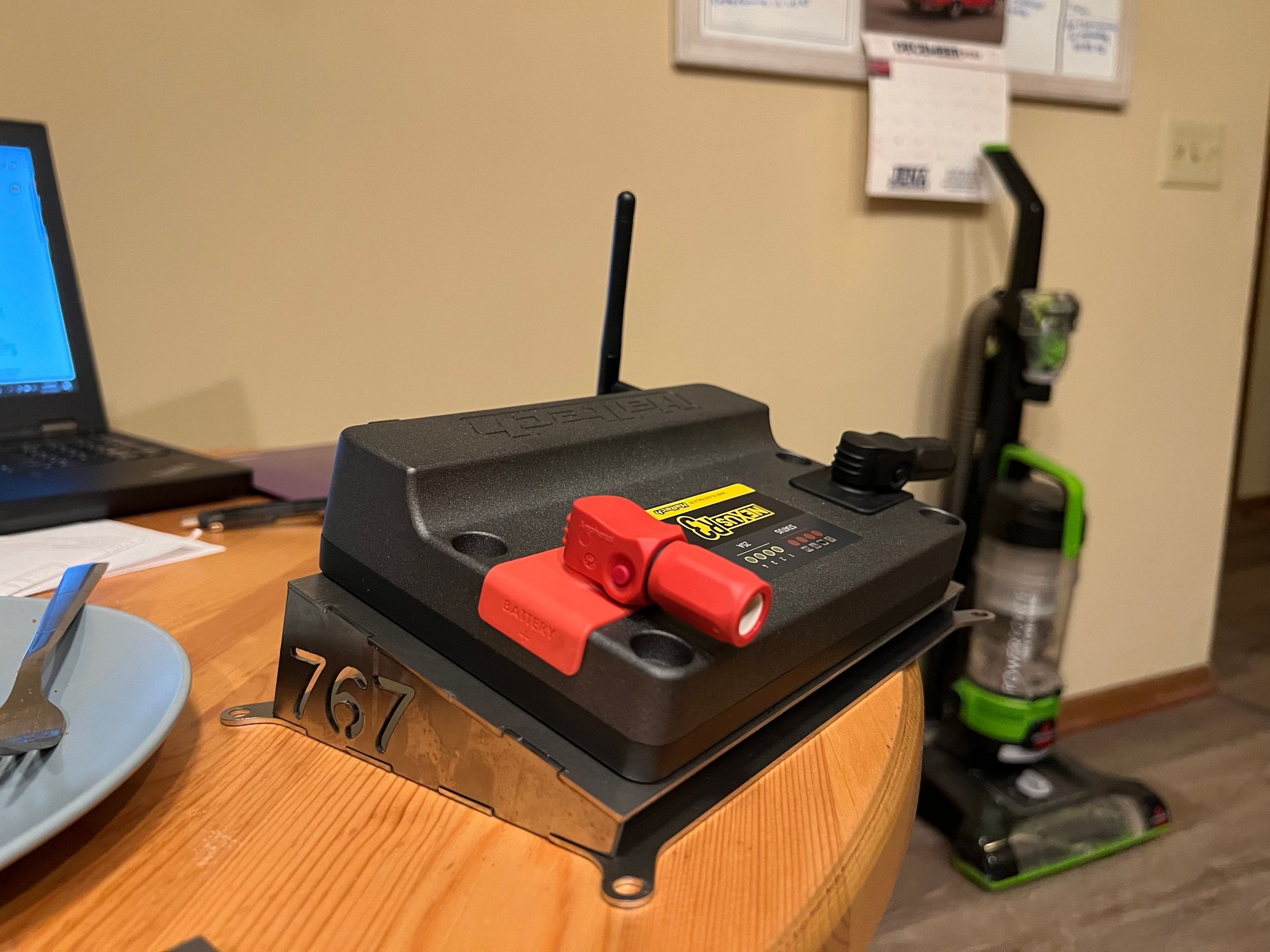

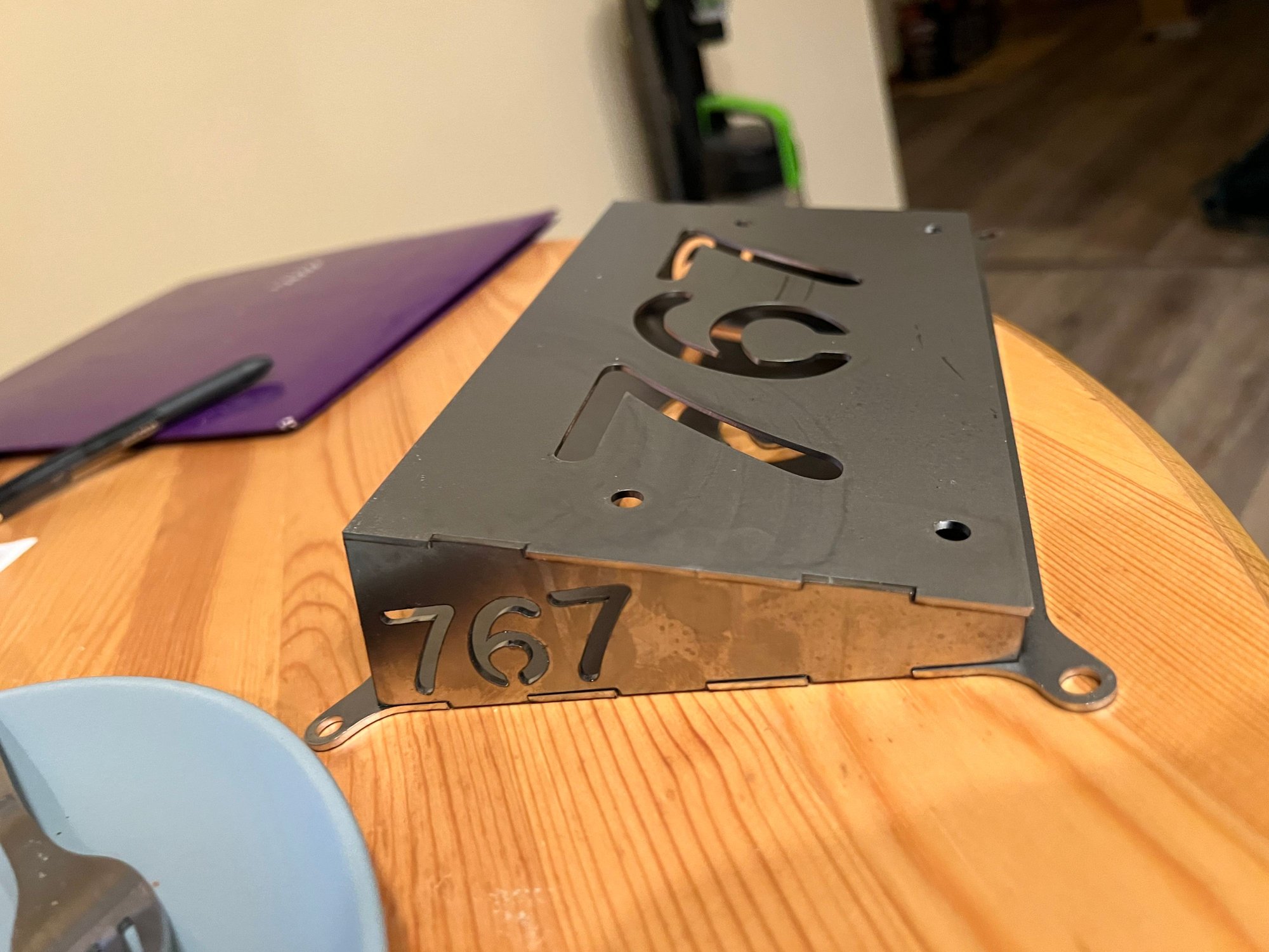

CADed me up a dash stand, hall effect sensor bracket to pick up off the steel bolts for the wilwood brakes, a nexus stand/bracket, and some rad support brackets since I deleted the entire front frame. Parts should be in tomorrow then I'll need to get to welding

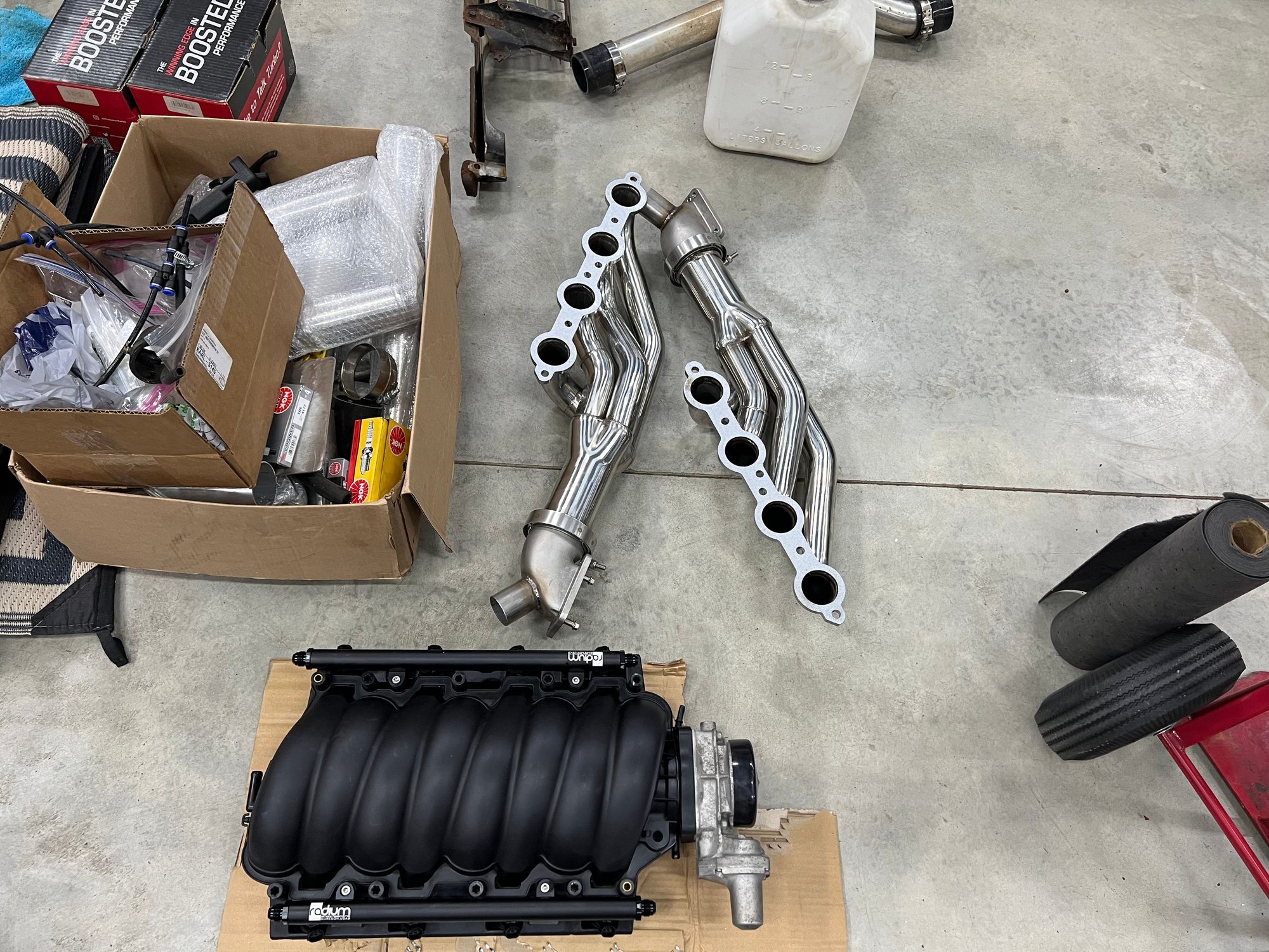

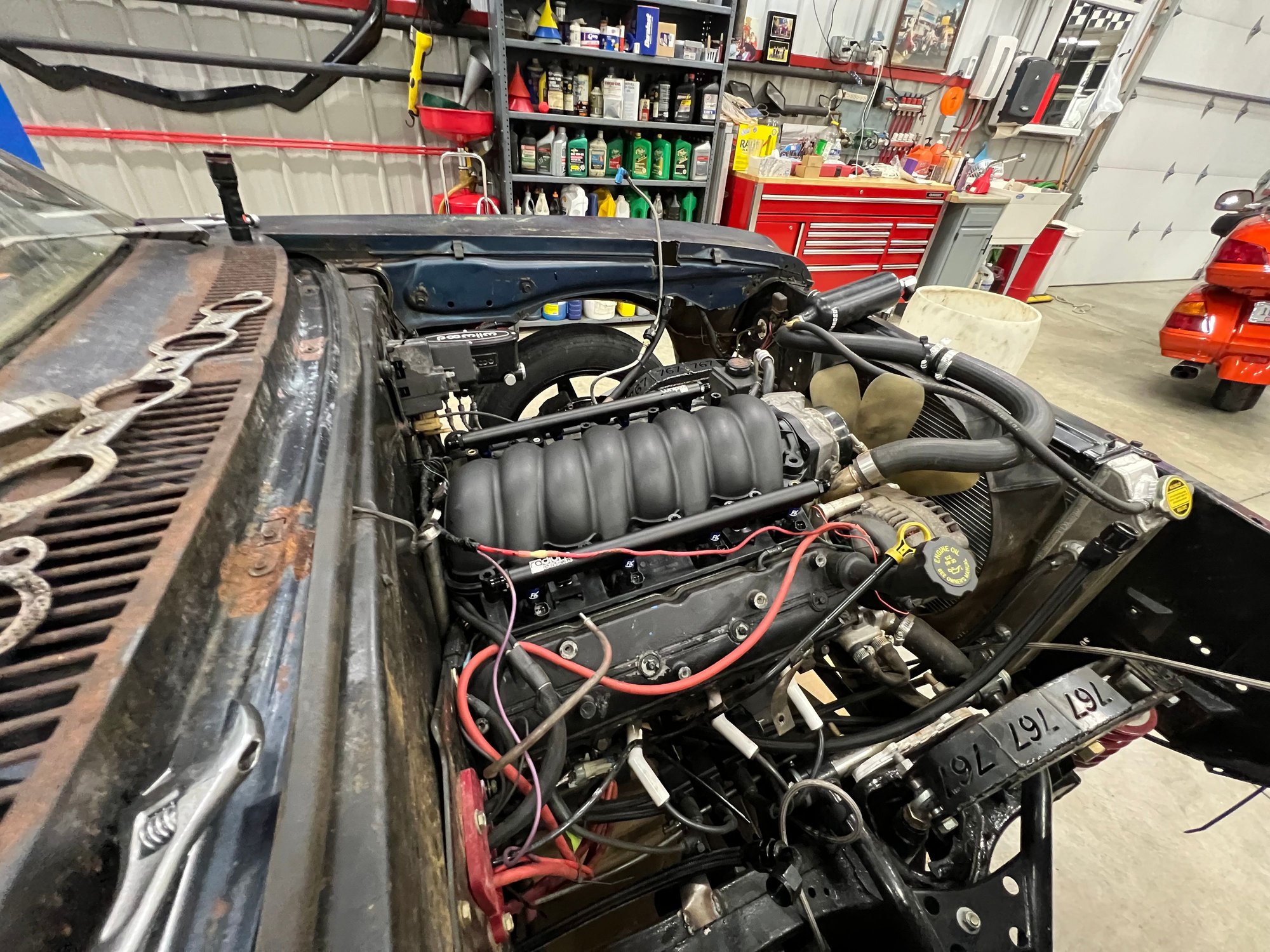

My ls2 intake makes slight interference with the truck water pump neck, also makes interference with the trans dipstick tube, and the valley cover bolts. I want to get some fresh junkyard knock sensors and knock harness, and I've been thinking of countersinking the bolts on the valley myself for the clearance.
My mechanical fan is going to have to go. I'm going to run a spal 2,000 cfm fan to the rad instead and run it as a 25 amp dpo from the nexus, I want to have one 25amp dpo on the nexus in case I want to run the headlights off of it. The fuel pump I'll keep wired on a switched relay as I have it already

Laser parts in
Needa weld em up
Thinking of 3d printing a throttle body spacer

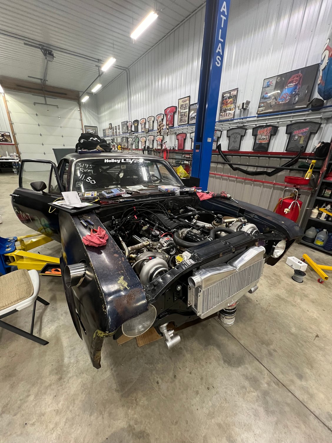

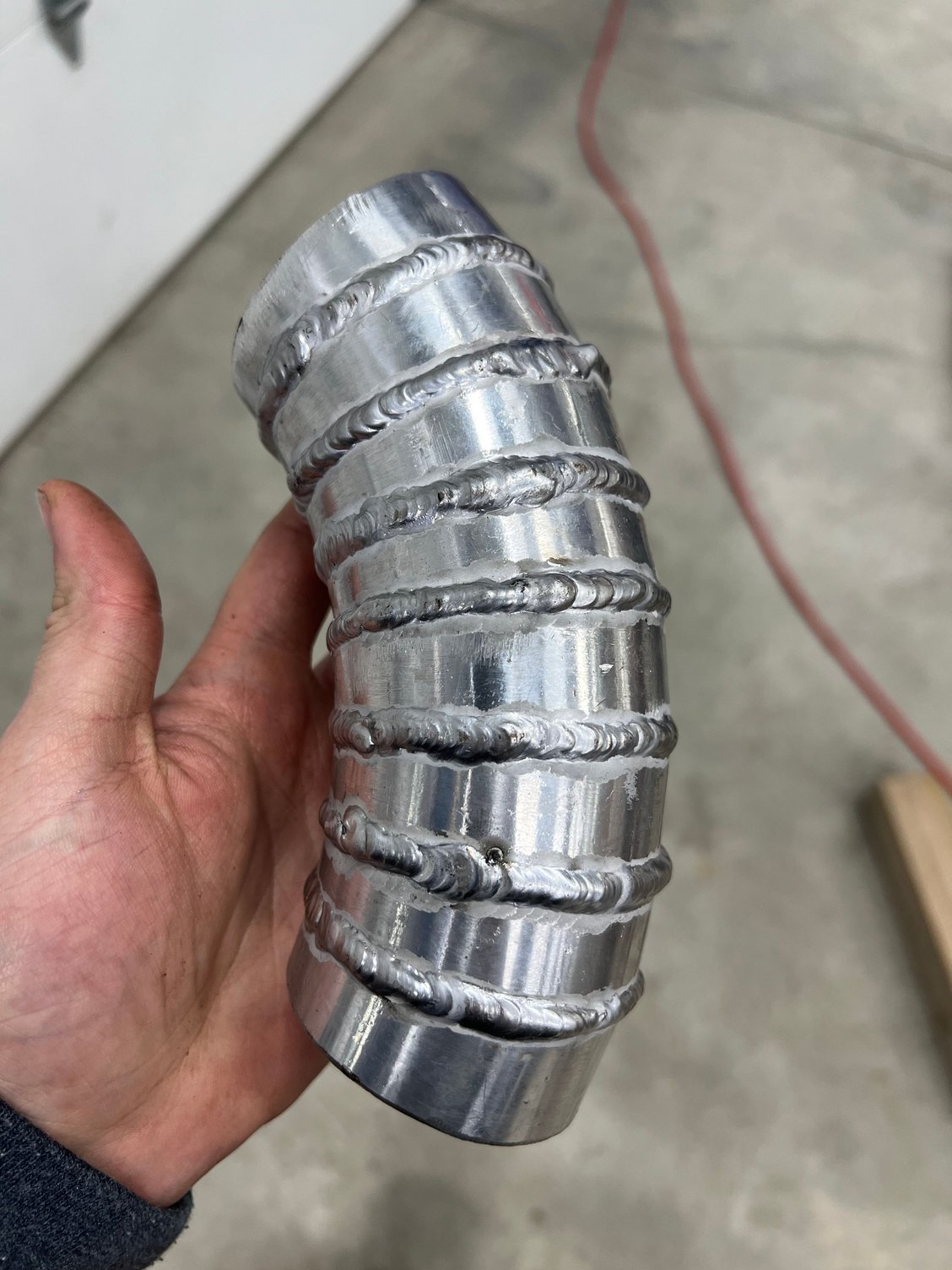

Plenty of room under the hood. I tried welding thin stainless thinking it'd be easy like aluminum. It was not haha, still learning. Ordered wheel speed sensor a. Hoping I can get my intercooler mounted today

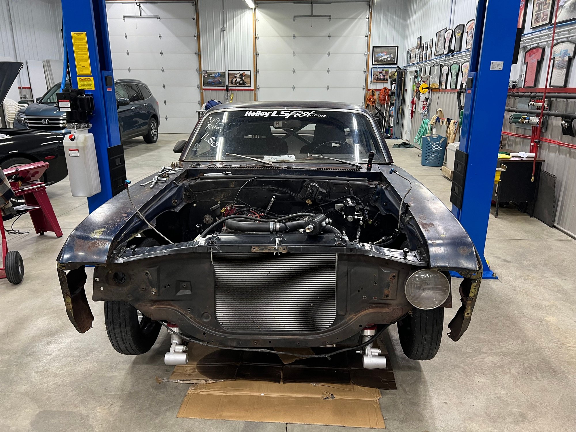

Completely forgot to plug -8 orb ports on the radium rails, and due to that completely missed my first start calibration appointment with tuned by Shawn. 1 day shipped the plugs, calibrated a few more sensors and tried starting again and got nothing
But this is how she currently sits, made my own downpipes there

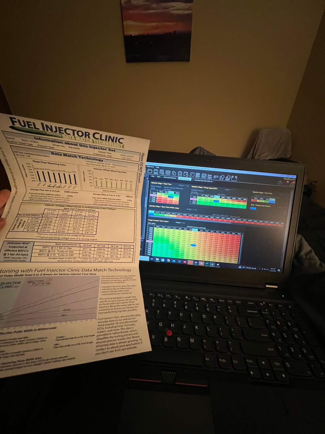

I have a decent amount of questions. My harness is a reworked 2500 harness (early adopter smdh). I have 25 A HCO powering injectors and a bunch of other misc things like sensors and whatnot. Is it possible to assign a output to more than 1 thing? Or let the software know that a certain output or application is getting power from somewhere other than a pin out on the vcu?
I got a base file from you or someone else on here I believe that I have loaded in with my injector characterization data. I'll dive deeper into what is keeping me from firing up when I get the car back to my place

Well instead of being a responsible adult and cleaning up the barn to get out of it, or adding the timing mark with welding wire for the tuner on the 30th, I decided to fiddle with the car a bit
I calibrated a bunch more sensors and got it using the onboard map, set the fuel pressure sensor correct
I can get the car to fire over once or twice which I assume is in batch for fast starts while cranking. Also in between attempting to start I saw ignition coil voltage drop to like 1 volt at one point. Also got over current dtc's for all hco 25A's I assume is because voltage was dropping too low
Ignition angle was initially 70, I tried 364, 441, and 710 and saw no change. I zeroed out crank fuel correction and confirmed injector data was correct
Here's a quick short of it
I need to get the car out tomorrow as this is not my barn. In the meantime, any ideas on what to try next?
