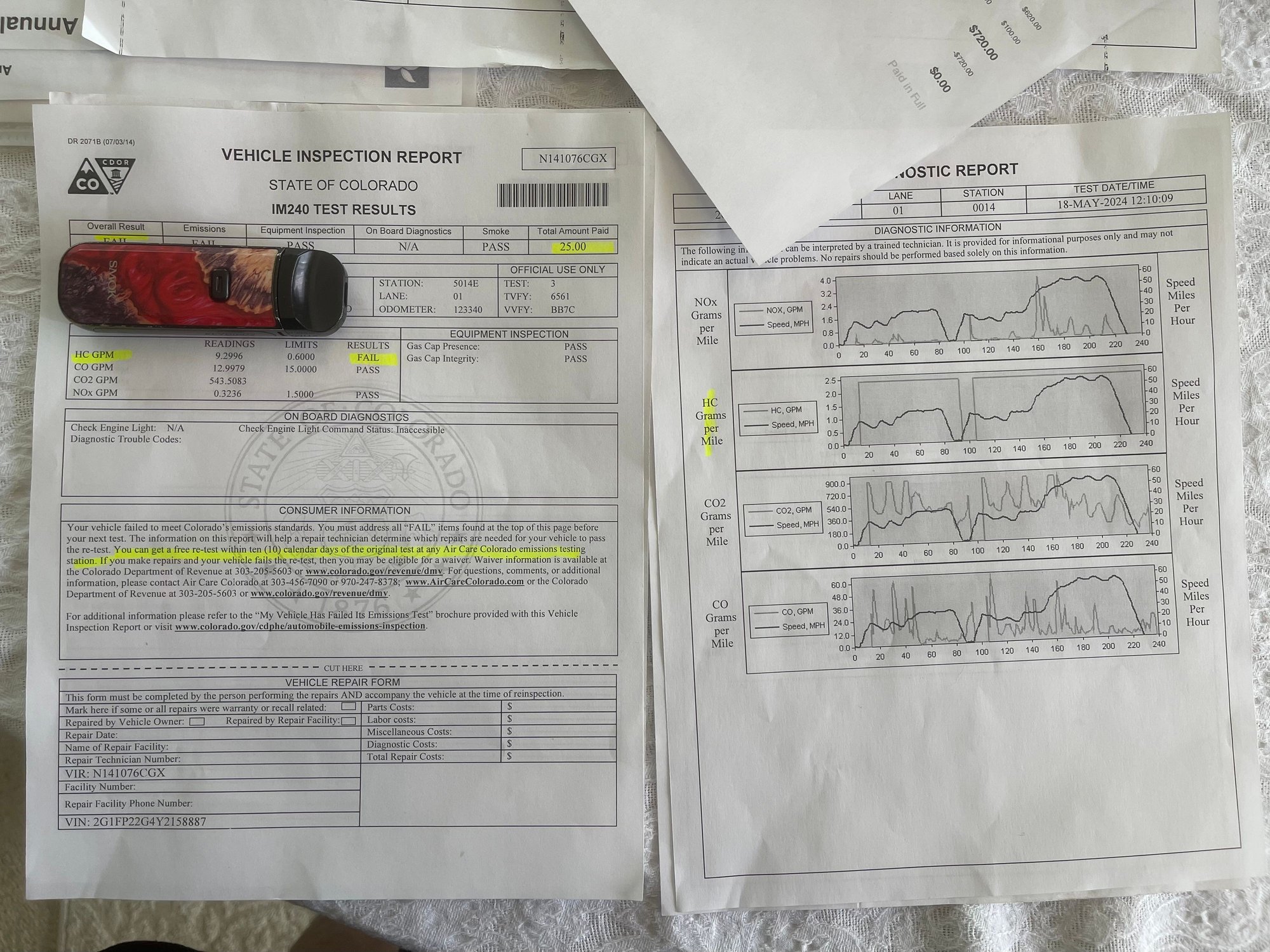

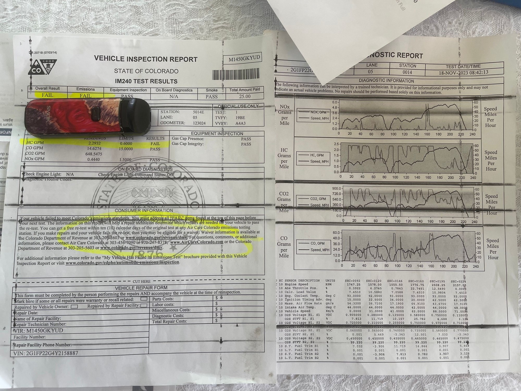

Hi folks. I live in an area of Colorado that requires a smog test to register my Z28. I’ve failed 3 times at this point.
The engine is a 383ci iron block built by Thompson Motorsports in Texas. Specs:
-Trick Flow 225ci heads
-Forged internals
-Custom 232/238 @ 112 cam, .6296/.6295” lift
-Ported FAST intake with 100mm-102mm TB, MAF, and air filter box
-Stainless long tubes with cats, y-pipe and dual exhaust
The first test:
Hydrocarbons: 2.29gpm (Max .6gpm) ❌
CO: 14.6gpm (Max 15gpm) ✅
NOx: .44gpm (Max 1.5gpm)✅
Then I asked them to do it again but to lay off the throttle. Second test:
Hydrocarbons: 6.67gpm (Max .6gpm) ❌
CO: 20.25gpm (Max 15gpm) ❌
NOx: .54gpm (Max 1.5gpm)✅

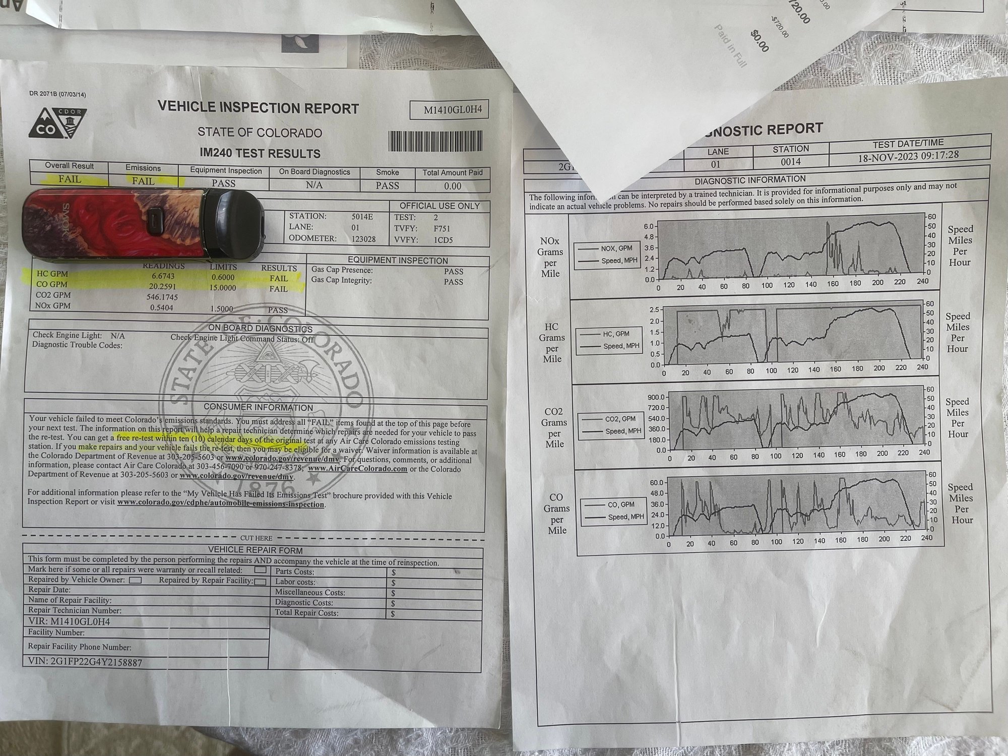

Then I went back to the tuner and he did what they do trying to fix it. Third test:
Hydrocarbons: 9.29gpm (Max .6gpm) ❌
CO: 12.99gpm (Max 15gpm) ✅
NOx: .32gpm (Max 1.5gpm)✅
Any idea on what I should do? Should I try some additives, and if so, which ones? Should I go back to the tuner, and if so, what should I ask for?
Thanks for your help!

That cam is doing you no favors.
A vicious idle lope will have it puking unburned gas like the hydrocarbon levels indicate (the first was best there, BTW).
Maybe raising the idle until it smooths out some might clean that up some.

A cam that size is not going to pass a tailpipe sniffer. Leaning out your fuel would reduce hydrocarbons, but jack up oxides of nitrogen. This problem could be reduced some by running e85, but probably not enough to come close to passing, and I have no idea what this would do to CO numbers.
