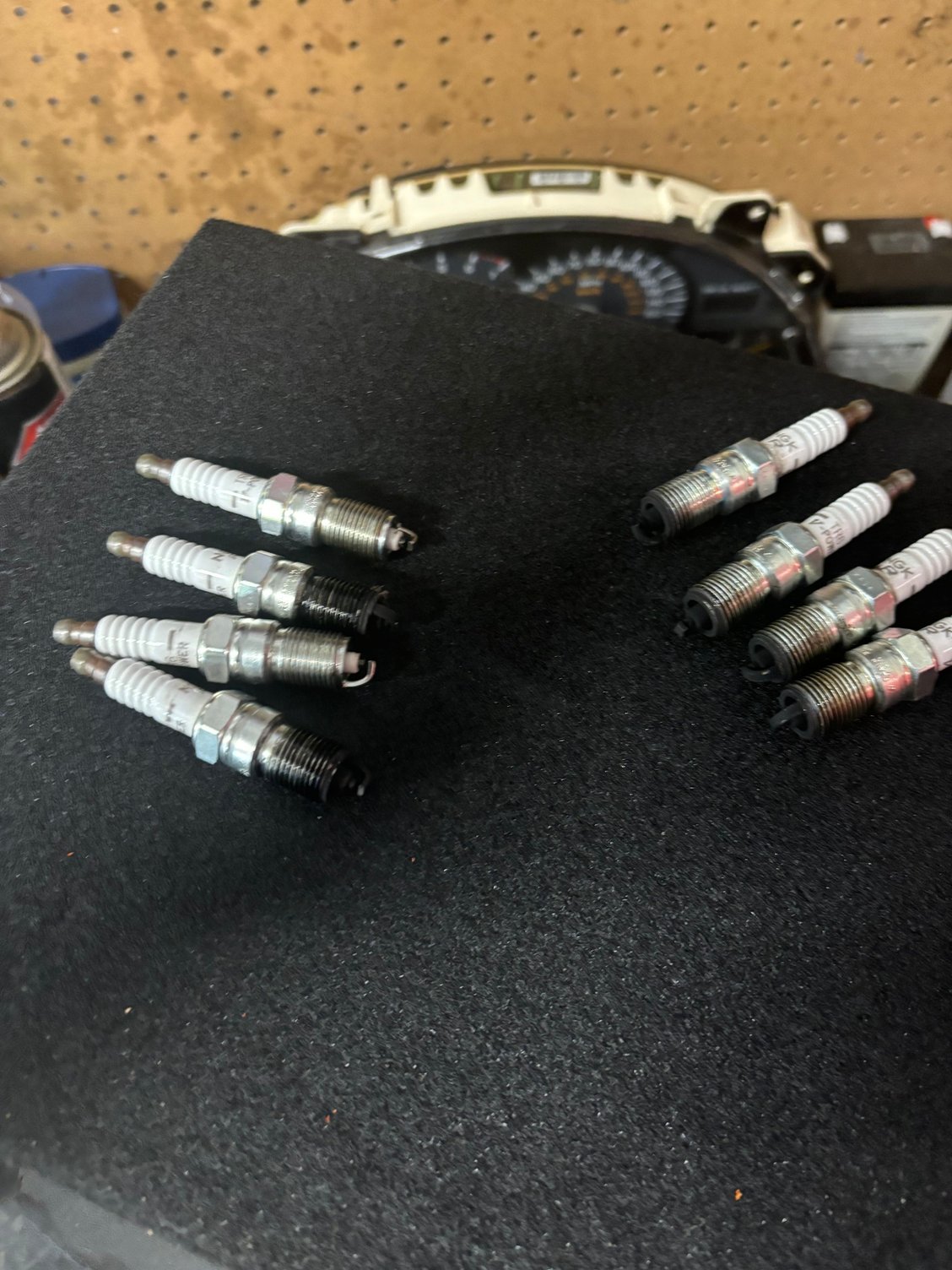

Ok so here are my plugs. The ones on the left are drivers side (bank 1) the ones right are passenger side (bank 2). They are in order not that it matters but the ones on the top are from front of the motor on back

So lay the black plugs on a black surface and take a pic??

You need to figure out why #1 and #3 are not firing at all. No way to tune around that. Since they would have had to come off to do the blower install, are you certain that the coil wires could not have been switched between 1 and 3? Once you have all 8 cylinders firing it will be much easier to figure out IF there are any other problems.
