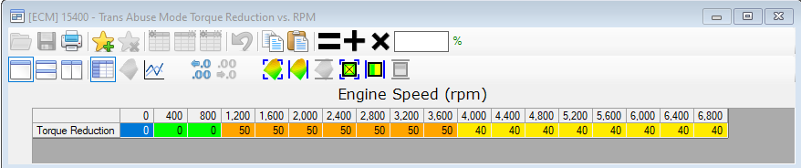

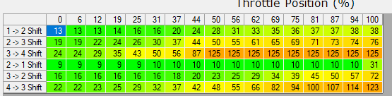

The original tuner (was new to the ls base tuning - i told him not to mess with the trans settings but looking through the tune (in HP Tuners) (and comparing it to what base tunes i could find on HPTUNERS looks like some parameters were adjusted).
and the Max line pressure DTC's P0101 + P0102 + P0103

The most likely cause would be that when you "open er up", something is causing a MAF code to trip, which will automatically command full line pressure unless tuned otherwise. This is only speculation, however, without your tune and a log of the problem happening to look at.
