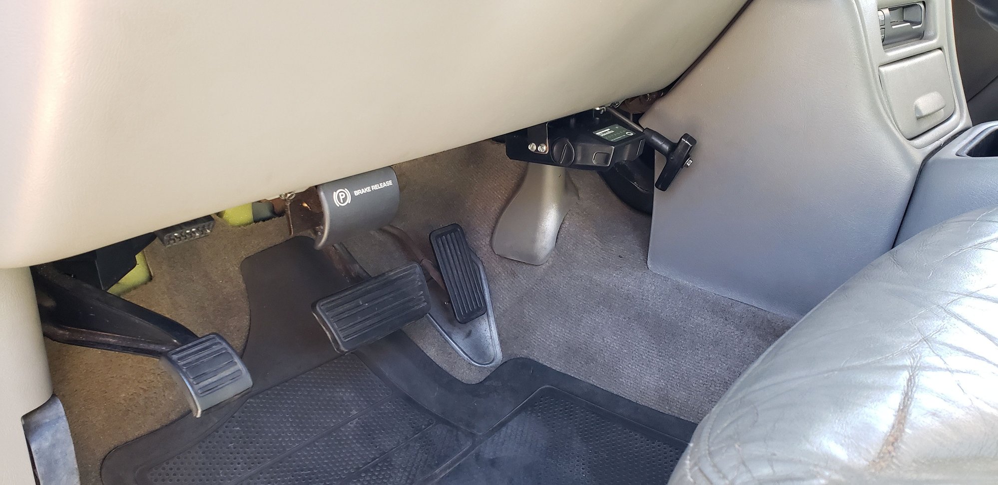

Nope, not on the 0411. I've looked into that also and then installed a manual pull lever to raise the idle on my truck for that purpose. Put it in the interior under the Dash off to the right, basically pulls on the Gas Pedal. Pull it out to what RPM you want.
