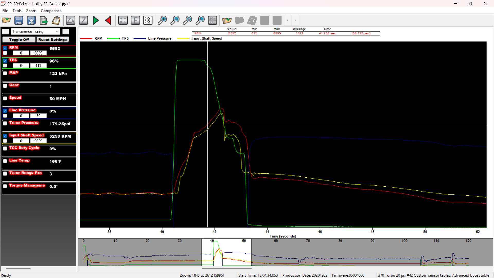

Here's a pic from my datalog and notice how input shaft speed(Yellow) follows RPM(Red)

Something else I just noticed, at the beginning of the log, both ISS and OSS stop reading completely for a second.
Old May 6, 2025 | 05:46 PM
91 Z28's Avatar
Joined: Oct 2016
Posts: 1,592
Likes: 375
From: Armstrong BC
Hmmm yea that shouldn't be a thing. If I were OP that's where I'd start before tearing it all down. If those sensors are leaving the party then he's most definitely gonna have shifting issues

I put the ISS and OSS in the chart, and they drop out multiple times through out the log.
I don't know how accurate the TCC applied PID is, but it says it's applied in 1st and 2nd gear at times.
