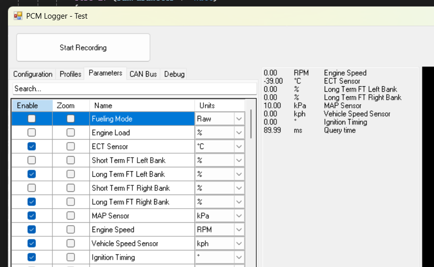

Does it work if you select these parameters? Hopefully they're supported by all PCMs / operating systems... but I have only tested P01 and P59 PCMs with Corvette operating systems.

So after unplugging the OBXProGT from truck and laptop and restarting laptop I got it talking and was able to pick some parameters and could see the info from them being displayed but it would never let me start recording. Picked the file to send it to and all but the start button never turned so I could click it.

Coincidentally someone reported the same bug a couple days ago. I don't know the root cause, but there is a workaround.
Get it displaying live data, use the Save button to save the log profile, then exit the app and restart it. The start button should be enabled.
