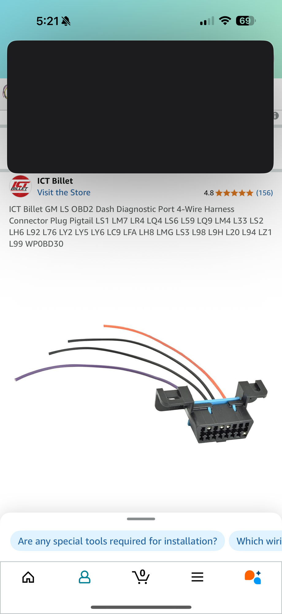

I have LS swapped a L99 out of a 2011 Camaro into my 99 jaguar XJR. I am trying to wire the OBD connector and cannot get it to read the Ecm. I have this OBD connector from ICT. I have the grounds and constant power wired and from what I can find the braided tan and tan/black wire is the data line. I have tied those together and connected to the purple on the connector and still cannot connect. Can anyone help me out with what I’m doing wrong? Do I need a different connector with more pins? Thanks for all the help in advance.

Tan/Black goes to Pin 6 and Tan goes to Pin 14. Do not connect them to the purple wire.

ok, so does anything connect to purple?

If all you swapped from the camaro was the engine and trans, then no.
