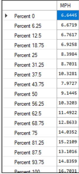

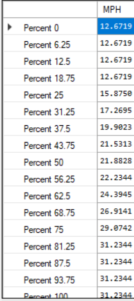

Old Aug 19, 2025 | 12:38 AM
2002Monaro's Avatar
Joined: Sep 2022
Posts: 73
Likes: 16
From: Perth, Western Australia
These are the tables for my 1-2 upshift and downshift in normal mode.
Can anyone explain why the downshift table would be all over the place? Is it possible that Universal Patcher mixed it up being a HPT file or is it just how it was tuned?
One of the few changes I want to make is holding first slightly longer which looks fairly simple.
Old Aug 19, 2025 | 02:16 PM
gametech's Avatar
Active Streak: 30 Days
Active Streak: 60 Days
Posts: 4,895
Likes: 901
From: Stockbridge GA
I could be wrong, but that just looks like someone "fat-fingered" a few spots while tuning that table. You will occasionally see tables with some random anomaly when the tuner is in a hurry and does not proof read their work. Also, it should NEVER be in a spot that is actually used in the tune, but some of the good pros will leave a specific meaningless change somewhere in their tune to make it an identifiable signature. of their work.
