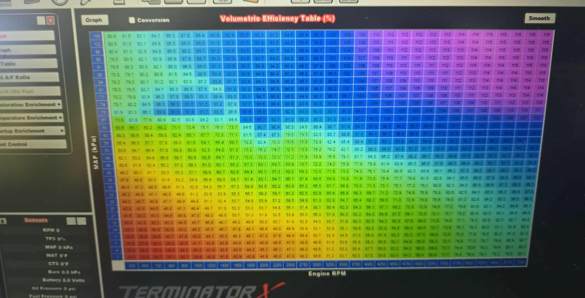

Hey everyone I've finally got my car going and I can't get it right to save my life lol. So I have a stock cube 6.0 with 11.9 CR, 239/244-112 cam,ported msd atomic intake and 102mm throttle body and I had a buddy come help with a tune and the fuel map is all over the place. I know its a big cam and I have low vacuum and I also know its gonna always try to add fuel but this is insane! Any ideas and I can post the tune file and a data log if need be.

So here is the tune and data logs and here is what I did last night, but I haven't loaded the worked out one in the car yet....well never mind I it wont let me upload the tune file even in a zip...

Why are you using those huge injectors on an NA motor?? Your base fuel table looks insanely rich in areas it shouldn't be. I'd highly suggest you get in touch with Andrew (Dr EFI) here in these fittings to get help with your tune. I'm looking at TA2 BTW. Even on TA1 it looks rich everywhere. Need to turn off "enable minimum coolant temp for closed loop". Yea you should get some help

Well my biggest issue is that i didnt have a MAT sensor so im going to grab one tomorrow and i have someone helping me and I went with those injectors because im gonna boost it next year or 2 plus do a cam change. But I appreciate it man!
