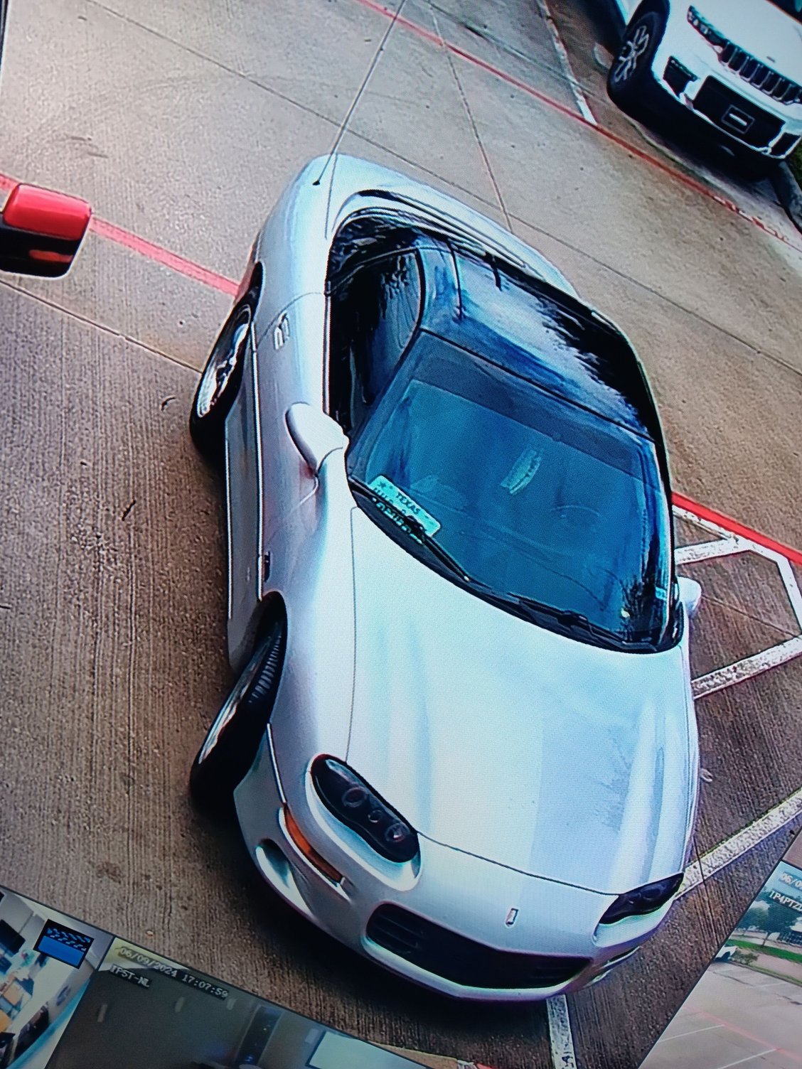

02 camaro 5.7 runs fine at idle but dies once I put it in drive and give it any throttle... ive changed : fuel pump , 02 sensors, mass airflow sensor, cam shaft sensor, gap sensor fuel filter and im stomped.... if anyone has any idea please help.... I've just about put her back together and this is draining me... New transmission, rack and pinion, water pump, power steering pump , rear ead and i had the heads reworked....
