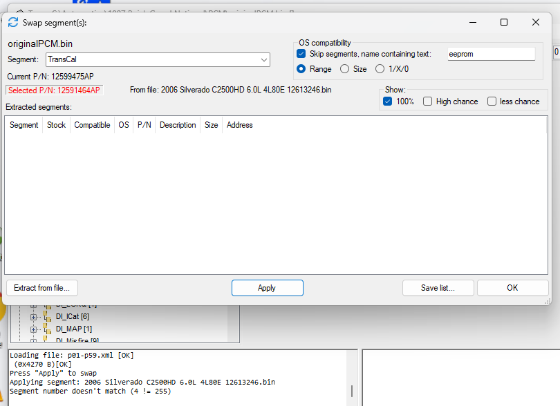

Does anyone have a 12613248 bin file with 4L80 (2007 OS) that I can segment swap from?
I am using universal patcher and tried segment swapping from other 4L80 P59 Bins like a 2003 express 4L80 van and a 2006 2500 silverado 4L80, and I keep getting the "segment number doesn't match" error. I thought the OS wouldn't matter when segment swapping P59 for P59 bins in universal patcher, but I guess not.

Thanks for the links. However that first link points to HP tuner files. Do you know where I could find the .BIN equivalent that I can edit with universal patcher?
