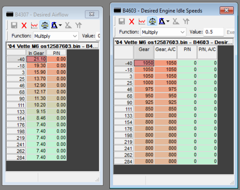

Anyway, there is a fair chance that the problem is in one or both of these two tables:
The numbers on the left columns are coolant temperature. Stock C5 values are shown in the tables. The screenshot is from Tuner Pro.
The engine needs more airflow to idle when cold, so if the tuner didn't increase those values enough then that might be the whole problem.
See how much airflow your car needs to idle when warm, see how much higher that is than stock (10% more? 20% more?) and if the cold values have not increased by the same amount, bump them up.
I think HPTuners might call the "Desired Airflow" table something else, maybe "Base Running Airflow" ? Someone who uses HPT will keep me honest here.
