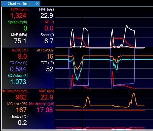

I recently built my first LS for my 1998 Camaro SS, but I'm having major issues getting the motor to idle. I've tried many tune adjustments to get it to work, but I haven't had any luck. The car will crank and start perfectly fine, then die 1-2 seconds later. There are a few things I've noticed happening:
-IAC circuit is almost maxed out at ~175 steps compared to a desirable 40-60 step
-As timing ramps in from 0deg to 18deg, RPM drops and eventualy the motor dies
-Me operating the throttle will not keep the motor alive; opening the throttle drops RPM. When the throttle closes, RPM increases slightly
-Sometimes RPM seems uncontrollable and will shoot up to 3000RPM, then dies
I'm thinking this is an issue with the size of the idle air circuit(Too small for the engine), causing the IAC to be open +170 steps. I can adjust where the throttle blade stops, but the adjustments seem to make no positive change. Would anyone be able to point me in the correct direction?
I've included a image of my datalog, datalog file, and tune file. I've copied the LS2 injector data onto this tune as best I can.

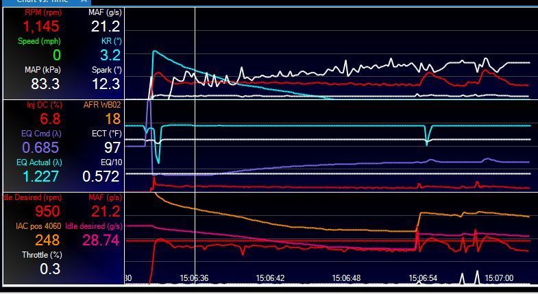

The issue now is it's running lean, or I think it is. Also, the throttle response is extremely odd: once you tap the throttle, it rises uncontrollably after I've let off the pedal. I have an AEM wideband hooked into the EGR circuit, and the gauge goes full lean during idle. I tested the sensor with the butane and a starting fluid-soaked rag, and it worked fine. I also did a quick vacuum leak check and came up with nothing major. I messed with the VE table, and it doesn't seem to have an effect.
