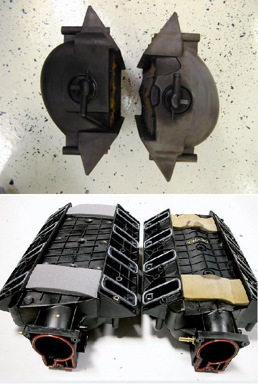

You can tell a LS6 manifold vs. a LS1 by looking at the bottom. The LS6 is flat, LS1 curved.
LS6 on the left:
