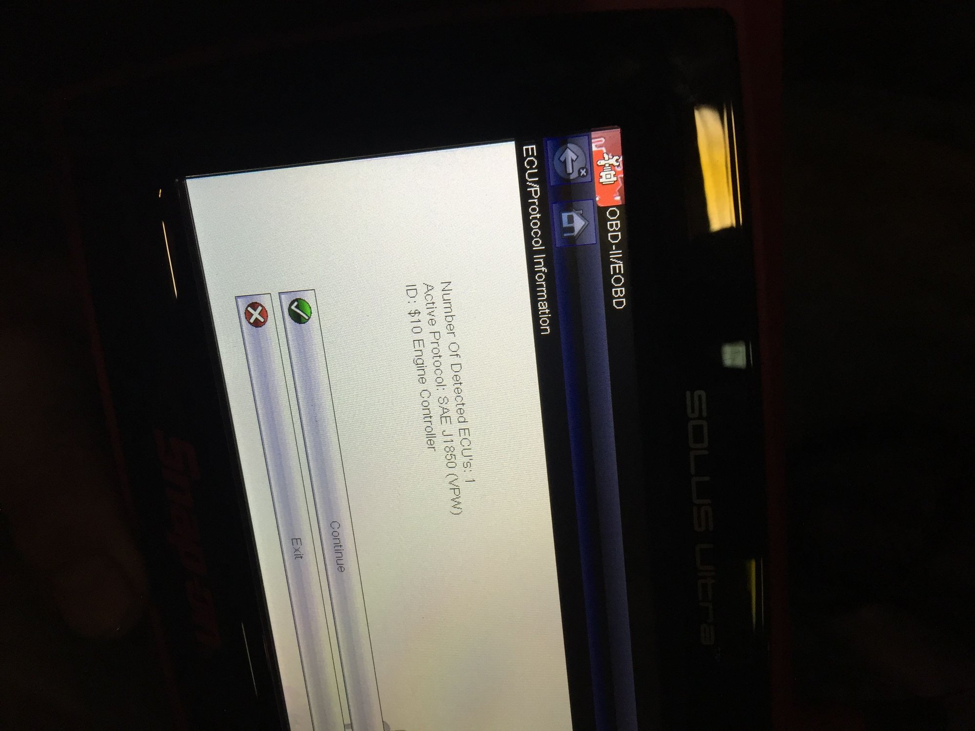

Does this code look familiar? This is what it's saying.

I'll be honest, I have no clue what the hell I'm looking at. A reader than can read ABS codes will be able to tell you if the front sensors are good or not. That said, if you don't have a "ABS INOP" warning light on your dash, then theres probably no issue with the ABS sensors in the hubs.

This post is for a friend, he says that the snap on scanner is saying engine control module, which is the computer right?
Old Oct 30, 2015 | 08:33 AM
wssix99's Avatar
Save the manuals!
Joined: Dec 2007
Posts: 12,967
Likes: 389
From: Chicago, IL
ECU is the engine computer, but I interpret the picture above to be the tool saying just that there IS one engine computer installed, which would be a normal thing.
