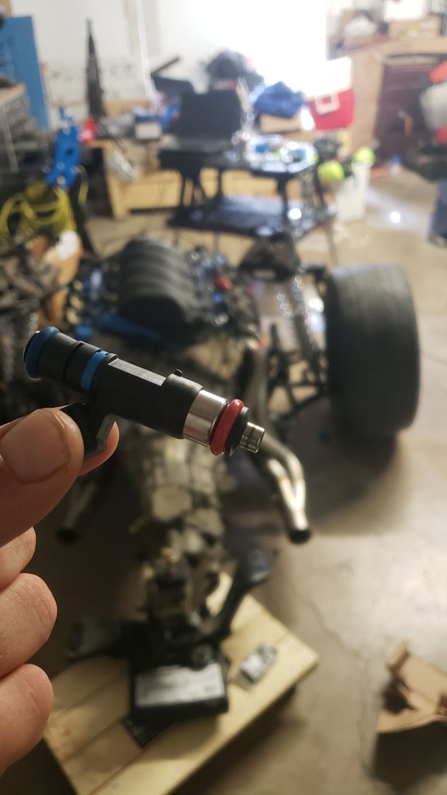

Got in my ls2 rail, I know you can use ls3 injectors with tophats, but I opted for ls2 injectors instead. Got 57#, which should allow me to use e85. Still need a content sensor to wire into pcm.

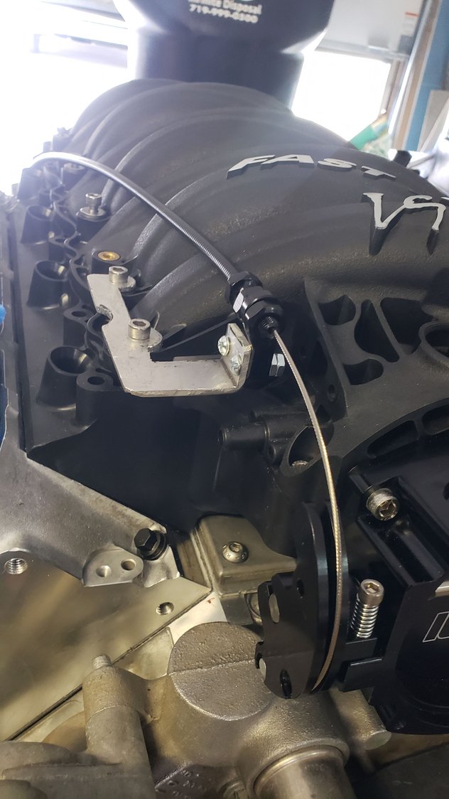

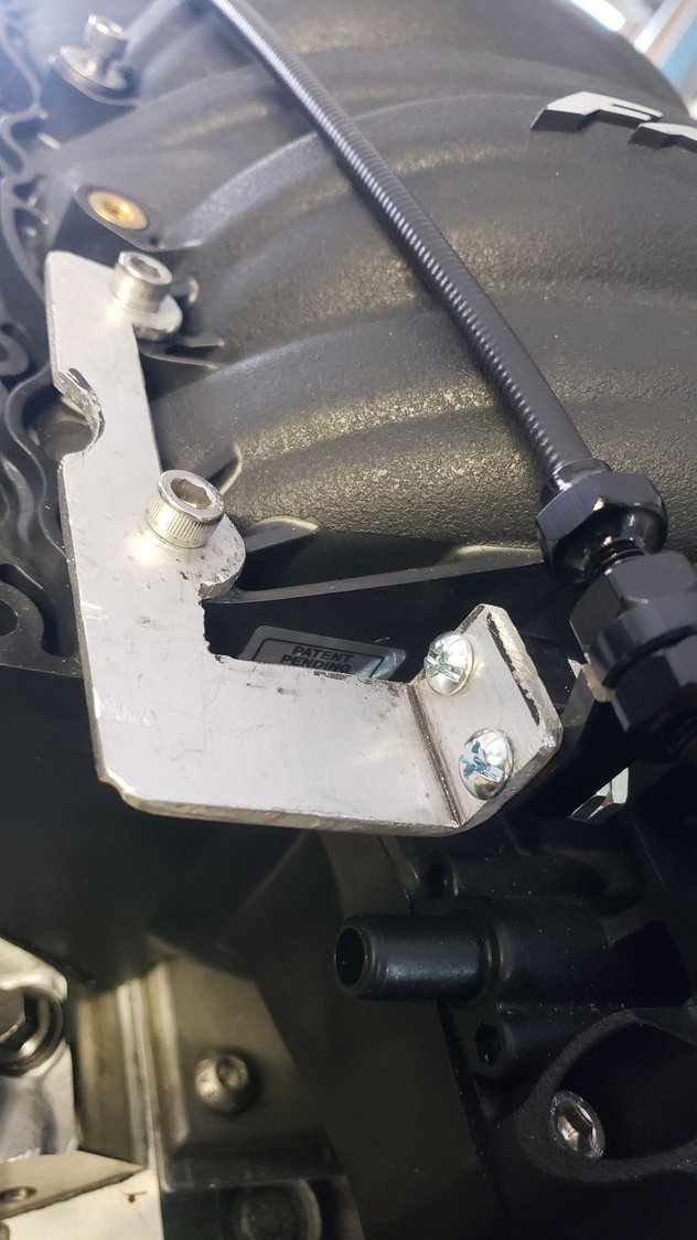

I couldn't find any vendor that sells a bracket for the 102. Plenty were available for the 92. I've heard many things about how the 102 is notoriously hard to make idle and tune, I think it has a large thing to do with the placement of the cable many of them use stock mounts. This is a mock up that I plan on modifying later to take all the slack out then again I'm also very new and kind of dumb

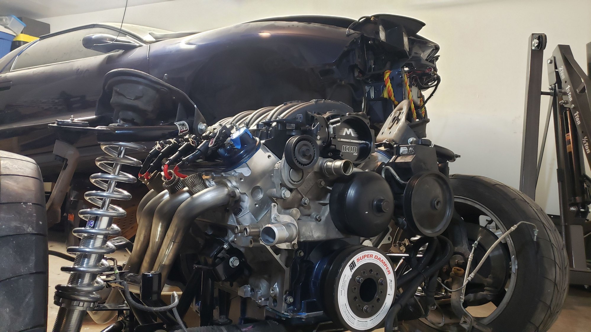

Motor installed, along with exhaust. Started her up and she sounds insane.
Gonna try to have it out and about this weekend for breakin
