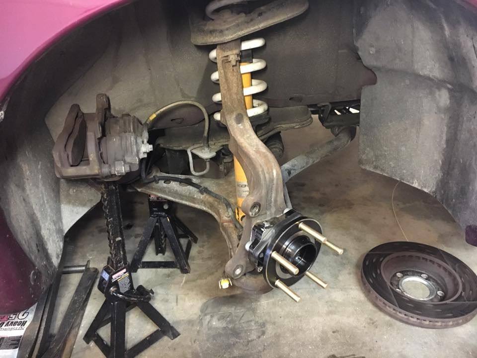

One side done

Looks good.
You should get Blaine Fab's braced sway bar brackets. Those have been known to crack over time.
