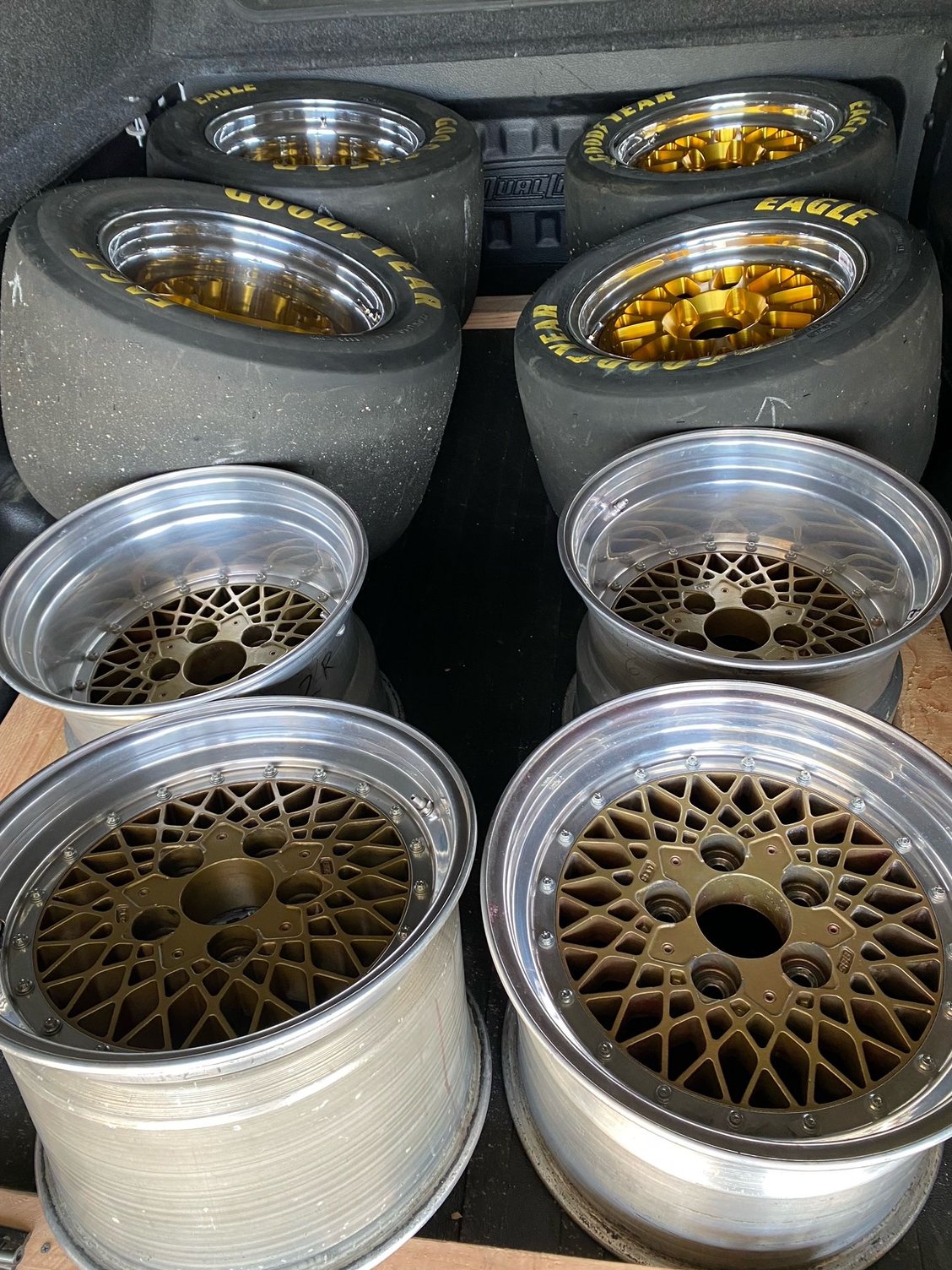

So got home and decided to restore my old set of black BBS basket weave wheels.
Good news bad news.
Good they didn't fail on the car because all 4 centers are cracked and not available till the end of the year.
I've got 12 more in the garage to crack check.
Need to have 2 good sets for my other historic IMSA GTO car.
Sheezer did nothing wrong but still got nicked.
Shopping some new affordable Jongbloed wheels now.
I know what I'm getting for Christmas, 8 new wheels.

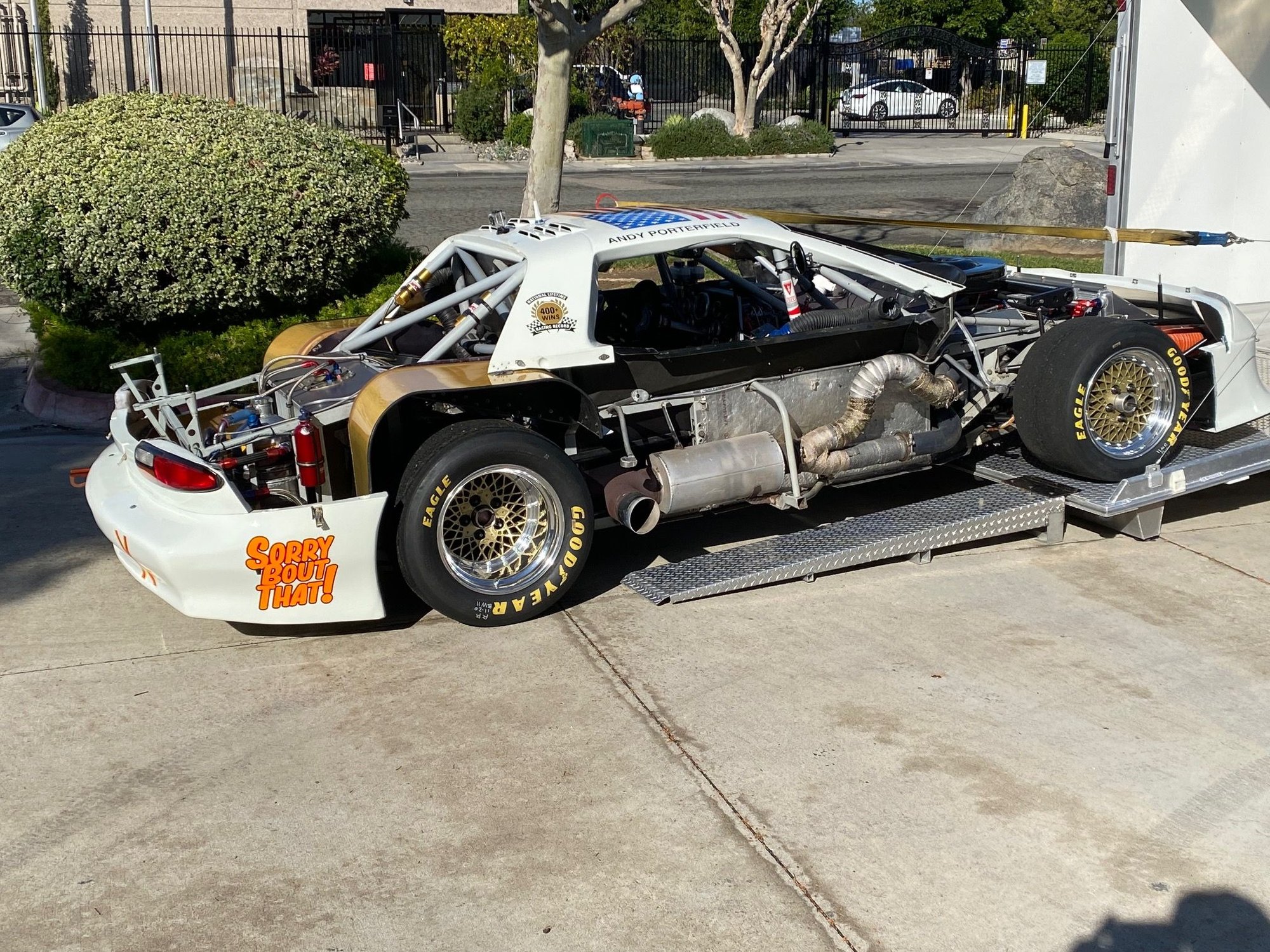

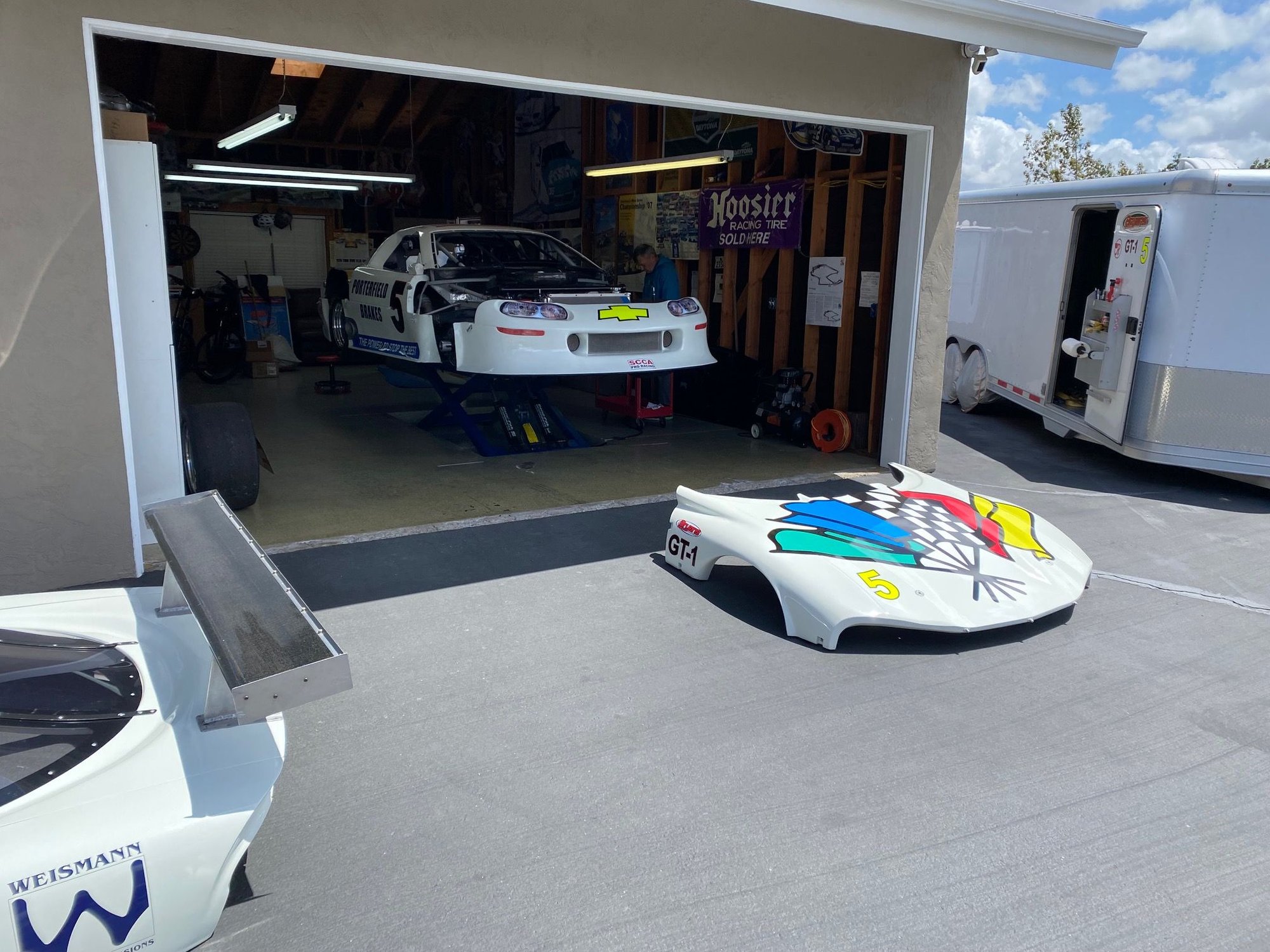

In an hour you can take off the floor, body and windshield.
Major cleaning, checking everything is tight.

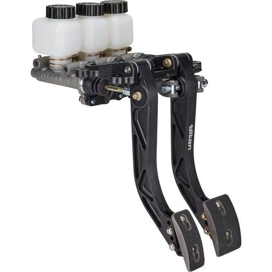

No ABS. I look at an ABS block with all the brake line fittings and have no desire to mess with that.
I had a C5Z I tracked and absolutely hated it when the brake pedal would pulse as the factory ABS shuddered.
I fixed that by installing some big front brakes and then the ABS shudder went away.
Both my cars have 4 piston calipers all around. 2 master cylinders with a manual adjustable balance bar.
I like to start out cold and dial in a little more front brake bias as it is easy to catch the car on cold tires if the front locks up first.
If the rear locks up it will spin.
As brakes, tires and driver warm up I can dial in a little rear brake and get maximum deacceleration.
I really enjoy left foot braking and with this set up have had no issues flat spotting the expensive slicks.

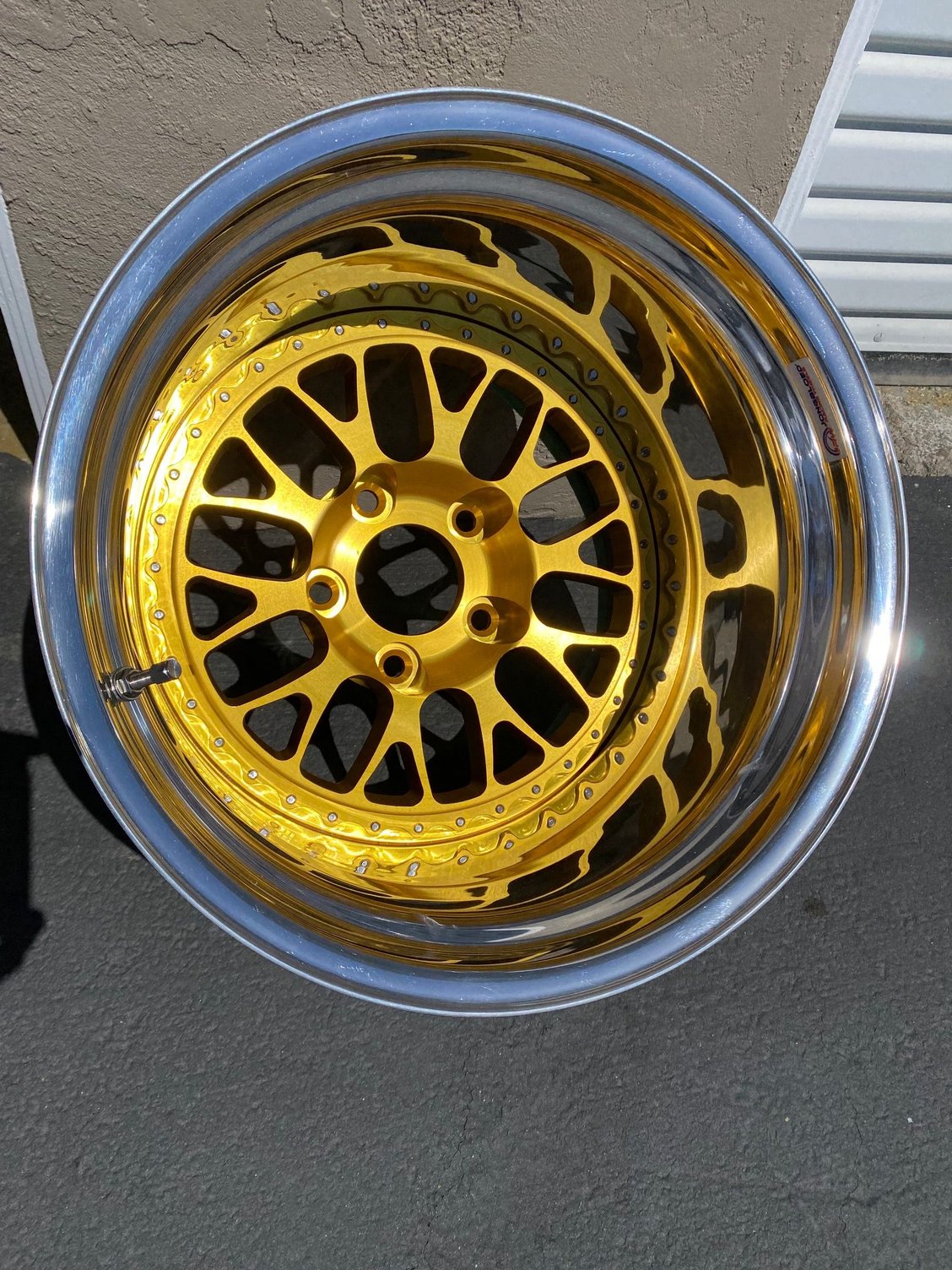

Supply chain working, new Jongbloed rims arrived.

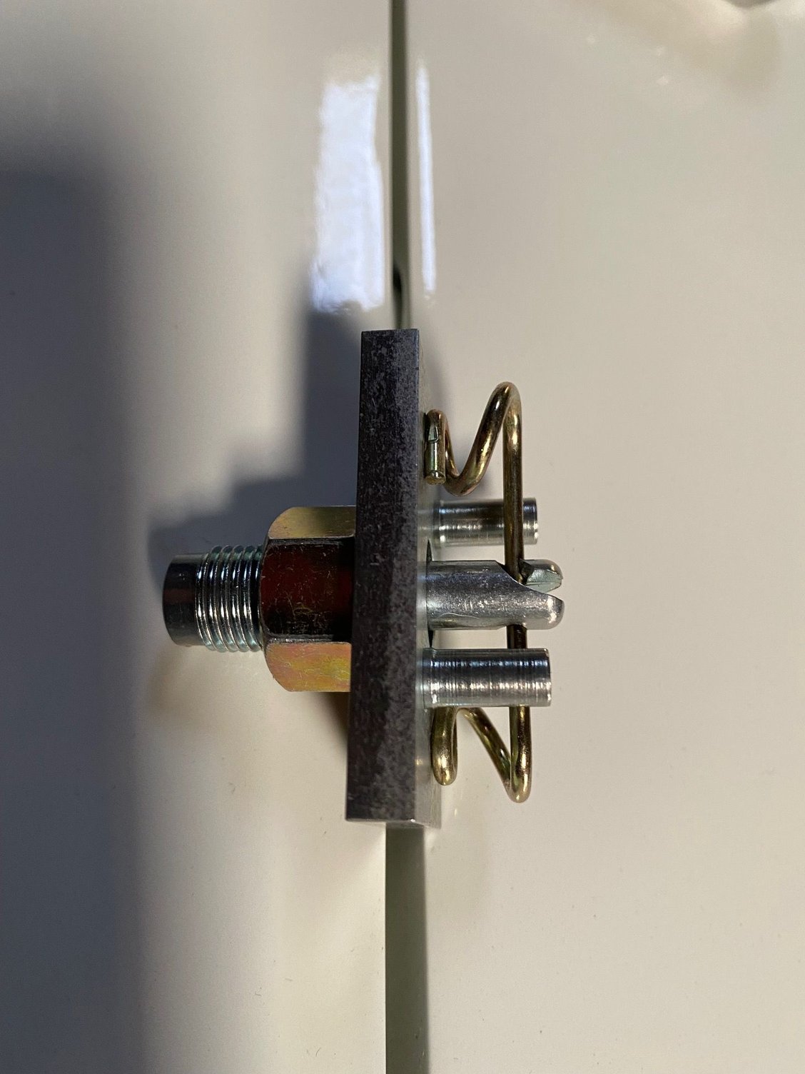

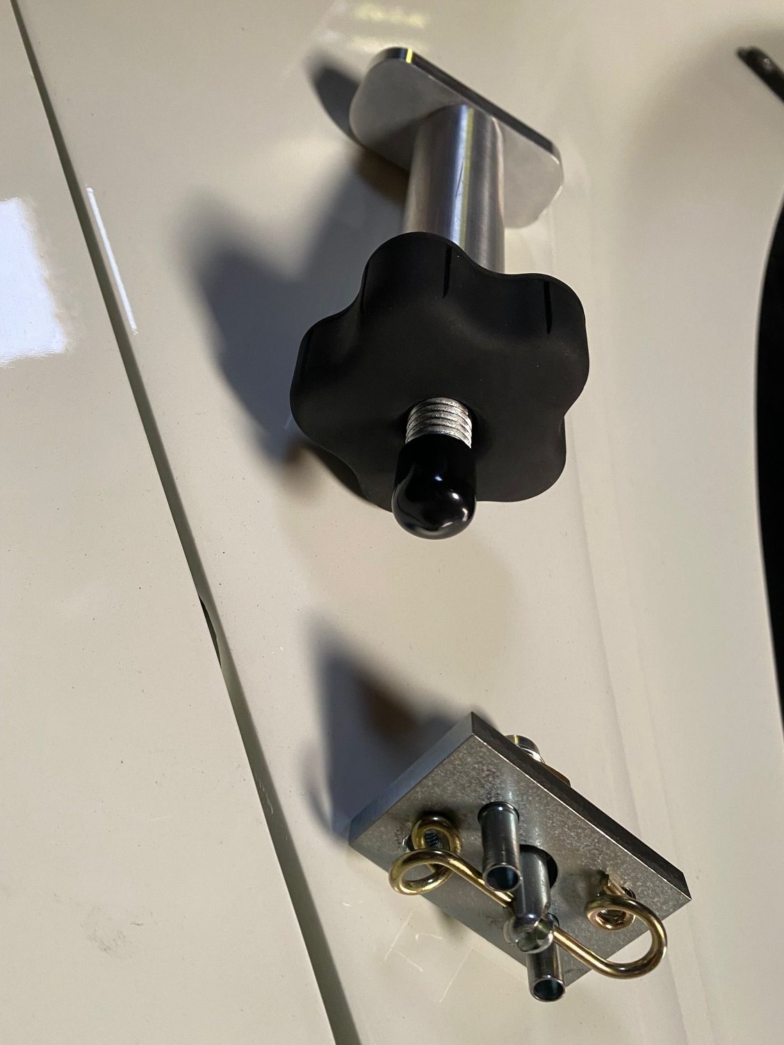

Got all the Dzus springs adjusted perfectly with this little tool.

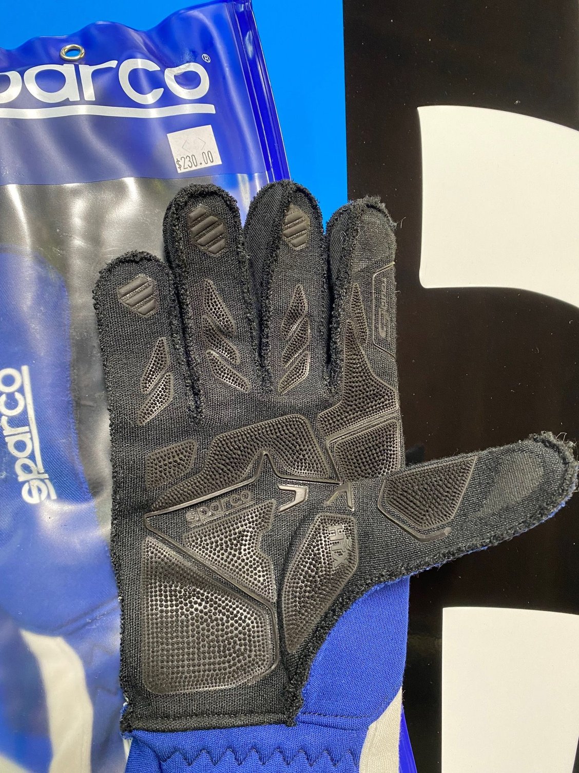

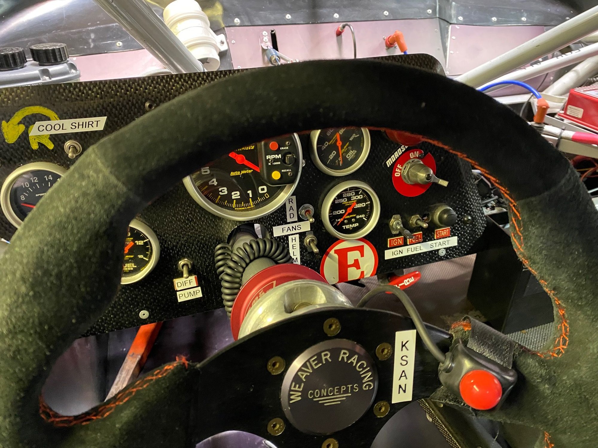

Made labels and replaced some cool shirt o rings.
Thick Suede wheel, if it gets shiny rough it with a wire tooth brush.
Perfect grip with these modern gloves.

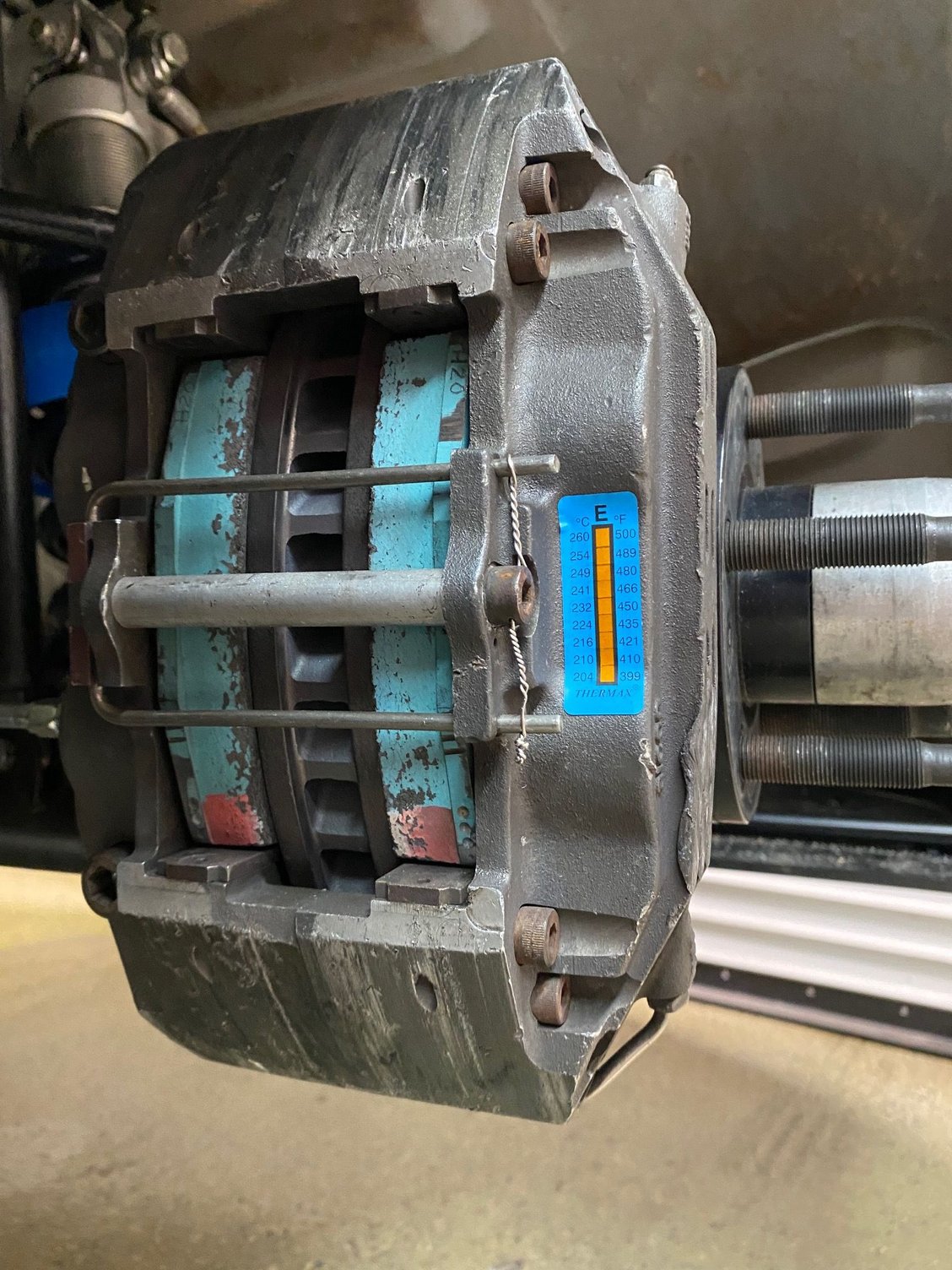

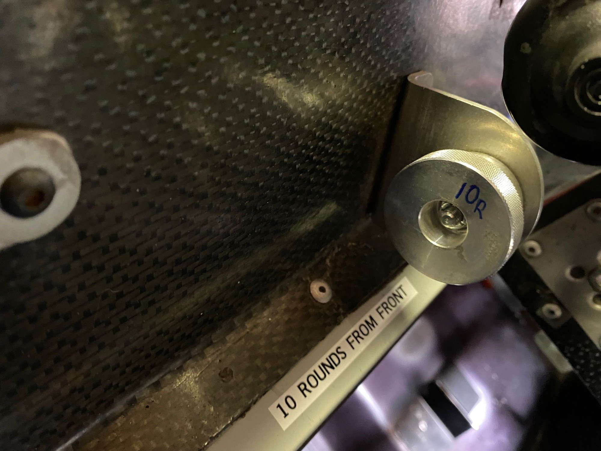

Brakes were totally rebuilt.
Added a temp sensor on the caliper and blocked the brake ducts with a little tape.
If the brake pads run cold they will not work well and it could damage the pad.
New (blue) Project Mu pads needs to be run at 500 degrees.
3 new master cylinders, rebuilt 4 piston calipers, new brake whips.
All lines (fuel and brake) swedged and pressure tested.
This summer when it gets a new engine we will swedge the oil lines too.
Got the brake bias dialed in as it says 10 rounds from the right is where there was 500lbs more front brake bias.
Good to know so we can always find home on the brake bias, and make notes for each track when I change the bias.

The new Jongbloed wheels with slicks.
Now the 4th gen has 12 wheels, 8 new Jongbloeds and 4 roller only cracked black BBS basket weave wheels.
Was thrilled to find my remaining 12 gold BBS basket weave wheels all passed crack check, they will be saved for historic racing the 3rd gen IMSA GTO car.

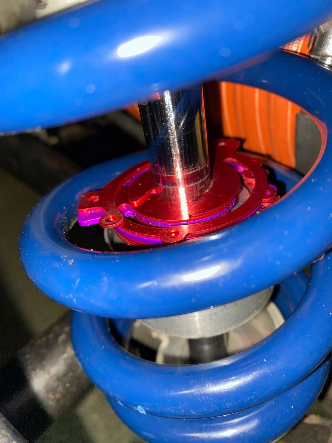

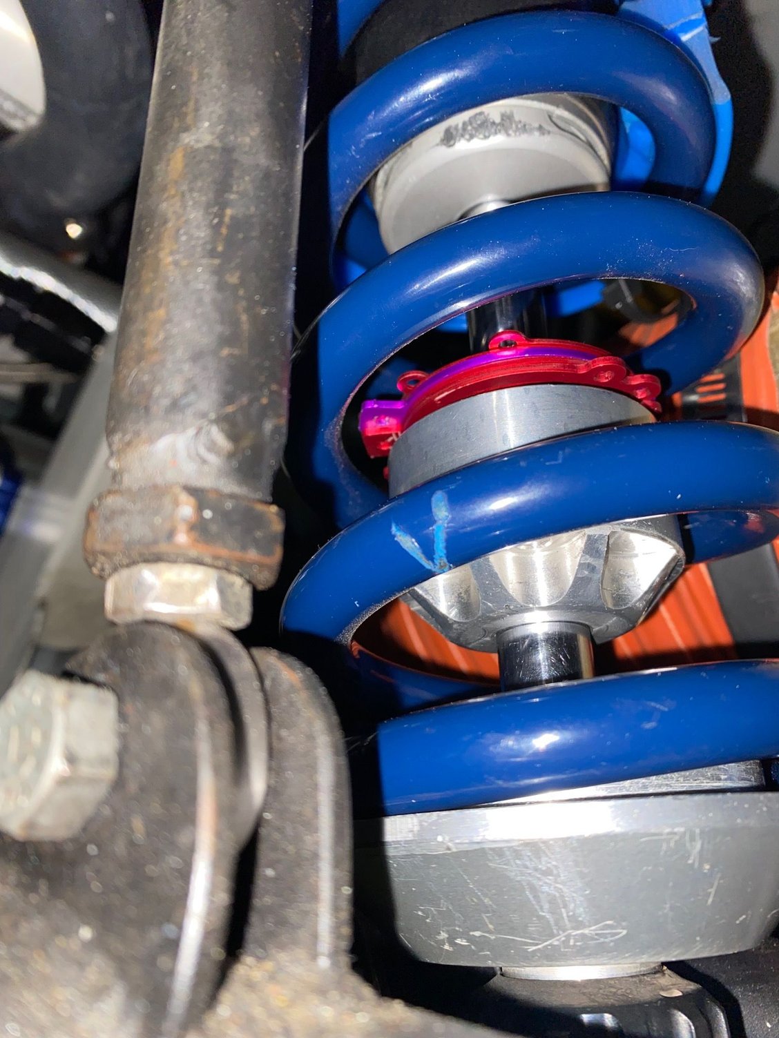

A photo of the front shock down stop.
We added more front rebound to help stop the nose lifting on acceleration.

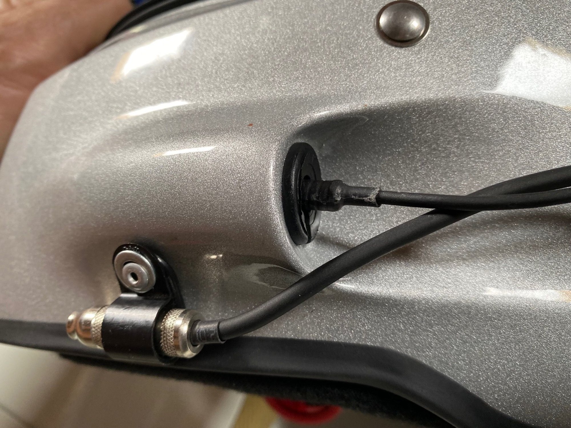

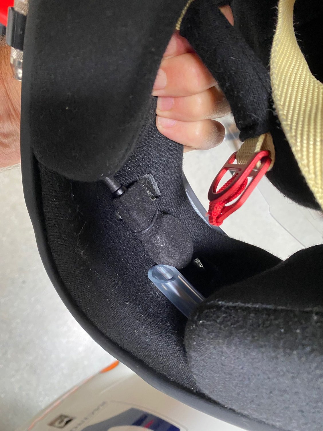

Got my helmet radio wired and ready.
Nice Stilo provided predrilled holes so I did not have to drill any holes in the helmet.
I like having a spotter as you can't really see that well out of the car, added big round side mirrors that helped.

Inquired about some new slicks, Goodyear says they will likely run out of my size this summer.
Bummer they can't tell you when the next shipment will arrive.
You know ideally we like to buy them fresh a month before a race.
So instead of getting 4 ordered 8, get them while you can.
I put a durometer on 4 older slicks and that convinced me to live large and get new slicks.
Besides my wheel management is perfect so I do have 8 wheels that need slicks.
At least both my race cars run the same size slicks.

Next Friday test at Buttonwillow.
New Master cylinders, rebuilt brake calipers, new brake whips, New Project Mu brake pads.
See photo, Added more rebound to front shocks, jacked down the front more. was still lifting the front too easy during acceleration.
