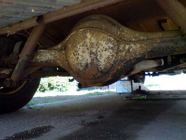

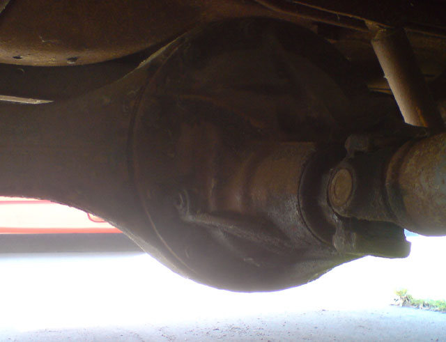

It's a rat rod for sure. It's in a 1939 Pontiac. I know its a 010 block, maybe from a early 70's Monte Carlo. It's got a LSD rear end but i'm not sure by who! Reverse threads on the axle studs if that help.
Any help would be fantastic guys!

Looks like an oldsmobile/pontiac rear from the 1950's (I believe they were a 9.3"). I am not sure that they came with the reverse threads though.

Yep looks like the olds rear and yes thay had rev threads. And if my memory is right thay only had reverse threads on the pass side.

that is an olds rear end from the 50s they did not make it for too long. i had a narrowed one in my S10 and it was hard to find parts for.

Thank you for the help! It does indeed have reverse threads on the stud on one side only! I actually left that tidbit out of my description on purpose to further verify it!

whats the difference between that and a ford 9 inch im not seein it.it just seems like the center section doesnt seem as off center as the 9 inch.

1st thought was ford 8" like in some of the late 60's mustangs. very similar to the one that was in my 65.
