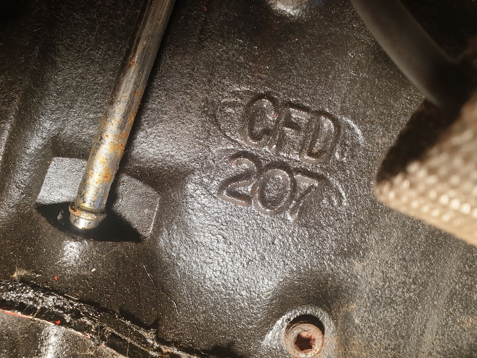

Can someone identify this number on my block for me
Can someone give me some information on these which id on my sbc

That means nothing relevant. I'm pretty sure no one can tell you what that means.
The relevant numbers that are cast in like that are the casting number by the bellhousing. There are numbers under the timing cover sometimes that will tell you how much nickel is in with the iron, You can sometimes find a day/night shift casting.
The most important thing you can find is the stamping on the front passenger side deck surface. That gives you a code that says what vehicle it came in, the CID, sometimes the last few digits of the VIN. Sometimes this has been machined off if the block has been decked.
Later blocks have the displacement size cast on top of the bellhousing area.

Casting # 14010207
CID 350
Rear main seal 2 piece
Years 80-85 (no hydraulic roller provisions)
HP 155-255
Comments: car or truck/ 2 or 4-Bolt mains, passenger side dipstick
