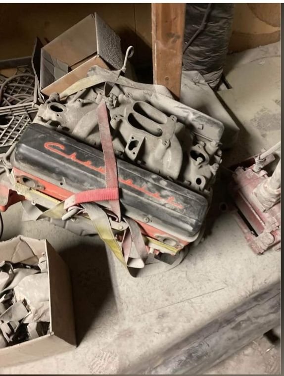

Does anyone make a 283/307/305 head gasket and what is if any concern (other than addressing comp ratio) in running a 350 head gasket since it seem this is the only option now? I saw someone mention cometic possibly makes one. Any info would be great. I have the power pack heads but may grab some 58cc 305 heads for the accessory mount.

So it looks like stk bore 4.00 is about as close as I've seen for the $$. Block is WA code on the stamp pad. 175hp C10., did they use different piston heights in these? I see most say there .020 in the hole.
