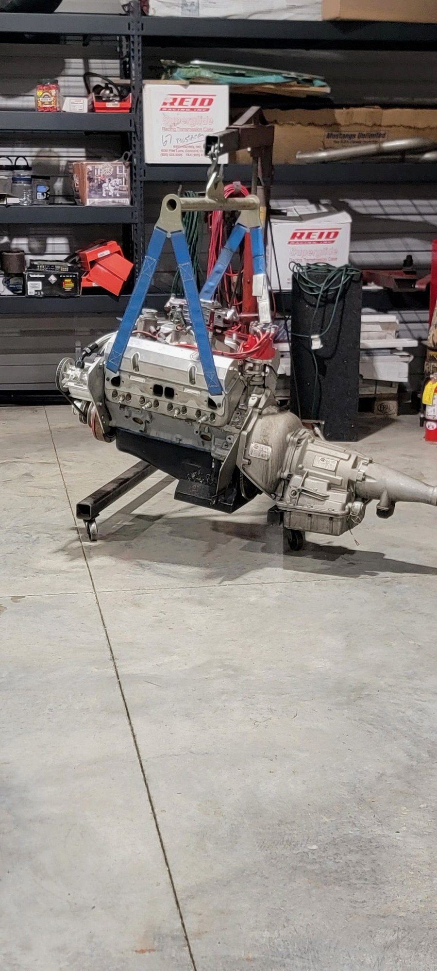

I have an unknown running SBC I've pulled from a donor car to use in my build. it is currently setup with a billet distributor and HVC2 coil. rather than spend the money on a 7AL3 I am planning to make use of the FT550 I have to run the engine using a set of LS coils.
It's my assumption I can use this MSD Cam Sync. Can anyone confirm?
https://www.holley.com/products/igni...tvzQCfn8&gQT=1
And does anyone have some SBC LS coil brackets they recommend? looking for something I could mount on the valve cover before I make some to mount them to chassis/firewall.
apologies in advance my engine knowledge is mostly ford mod motor based but this SBC was a deal I couldn't pass up.
Pic just after pulling it from the donor car:

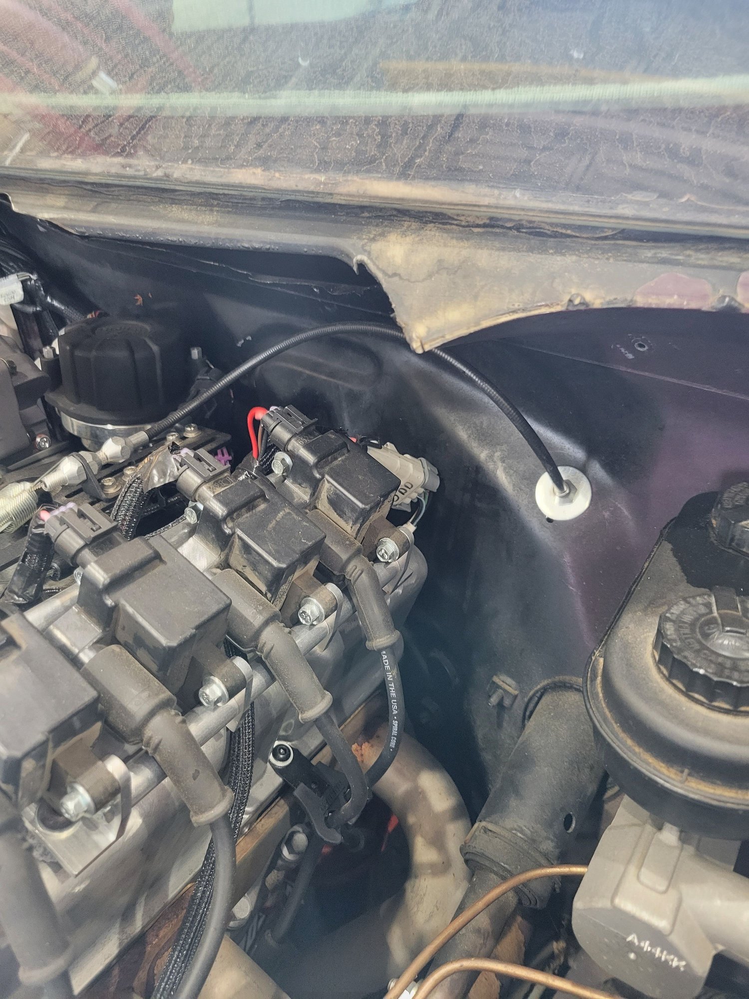

A little late to the party but I ran/run a 1st gen Holley Dual sync on my 427. I bought a set of ICT Billet truck-coil relocation brackets and some aluminum spacers, and had my buddy TIG the spacers to my valve covers after I tapped them for button head bolts.
