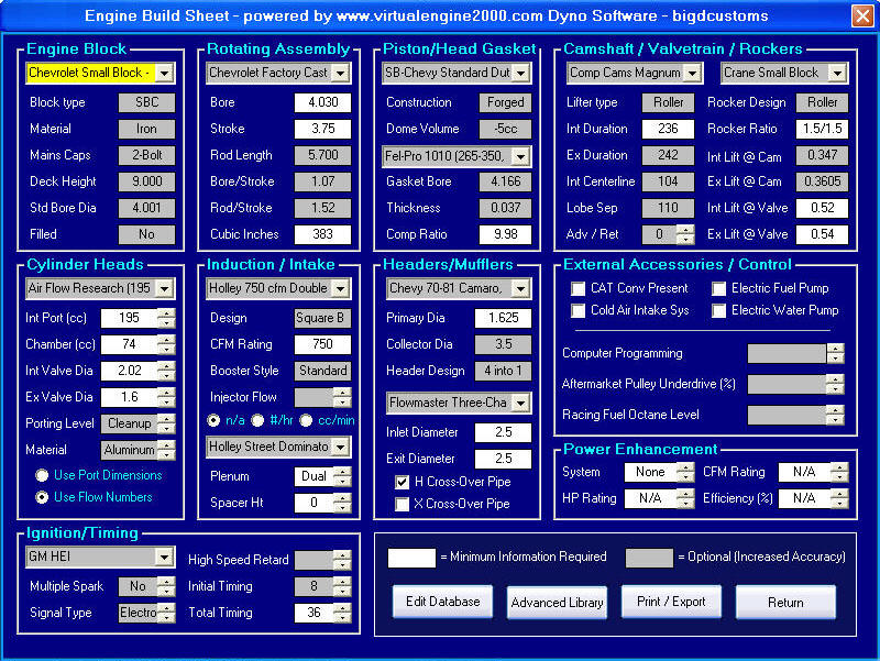

just wanted some input on this combo that i am building, hp numbers or different part suggestions would be helpful, maybe 1/4 mile projections... im looking to make 500 flywheel hp or 400 rwhp...
-4 bolt block with full eagle forged internals (9.7 compression)
-AFR 195 heads (75cc) 2.05/1.60 valves
-comp cam hydralic roller .520/.540 lift with aluminum 1.5 rockers
-stud girdle for rockers
-holley street dominator intake (idle-7200 rpm operating range)
-either a holley 750 vacum or double pumper carb???? not sure which one yet
-1 5/8 hooker headers
-700r4 with 2800 stall and 4.11 rear gears

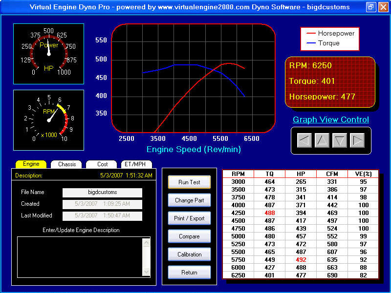

Here is the link to the 1/4 and 1/8 mile et calculator - I did not know what driver weight to input. The simulated dyno run looks like a really good combo. Nice torque curve and plenty of power.
http://www.virtualengine2000.com/Calculator.htm
