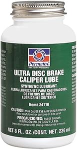

there's 2 types, PAO oil based such as CRC and permatex:
and silicone based which generally come in those little packets.
either will work. the reason you don't use regular wheel bearing type grease is because they have petroluem based oil in it and can't take the heat and will also degrade the rubber seals around the slide pins.
I believe the silicone grease and the PAO based grease are incompatible so you don't want to mix them. I think the oem lube was silicone, so if you go with the permatex or crc stuff you want to clean off whatever's on there before using the new stuff. the small jar or permatex or crc is great all around lube for everything else also.
and only use these lubes on the slide pins.
