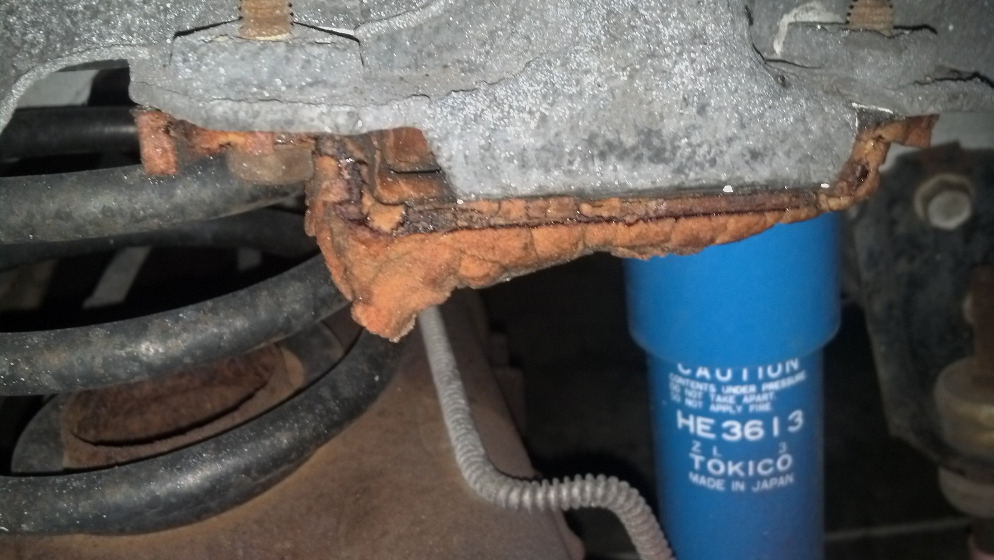

LoL, let me start over. The car is 14yrs old with 67k miles. The suspension appears to be original with the exception of the Tokico HE3613 shocks. The photo below is of the rear end.
The photo shows the worn out passenger side bump stop.
I do not know the age of the dampners but would entertain their replacement. I looked them up and they had 4.5 of 5 stars with 65 reviews. But, I would need you or someone tell me how they might be different from the Koni str.t or Bilstein shocks.
The bushings are present and intact but I am not sure how to tell if they are still doing their intended job 100%
This is a stock LS1 and i do not plan to take it to a track. It is my older guy cruiser but I occasionally run it up to 100 or so because it is Fun!!!
Please let me know if I need to provide more information or photos. And thank you!
Old Nov 4, 2014 | 06:59 PM
blackbirdls1's Avatar
Joined: Jan 2006
Posts: 682
From: Oviedo, FL
yeah looks like you wanna put a new bump stop in there, mine look like ****

That's a lot, LOT more helpful. Thank you bgw70, now I'm not guessing.
The car desperately needs new bumpstops. The springs look stock to me, and if the car isn't sagging they aren't bad. You might want to change them if you want to lower it (not sure you do, and you certainly don't have to just to make it drive better).
Tokico Blues are "ok". I have on idea who is rating them 4.5 out of 5, or what against. Most of those are just polls of folks who put them on and being better than worn out stock crap most shocks look great by comparison.
We know you need bumpstops. You need to decide if you want to change springs or not. If not I'd likely go Bilstein here based on what you are telling me you drive it like. If you are going to use a lowering springs, then I'd lean more Koni STR.T. You can use the STR.T at stock height if you wish as well, but the Bilstein's are a little more ride oriented, the Koni's more control oriented (and meant to handle lowering springs Bilstein's aren't so much meant for that).
What I would also strongly recommend is upgrading the sway bars to my 8316 front and 8410 rear (35/22 set). Bars are awesome in that they don't kill the ride, cause you scrape, and don't need killer shock damping to do their job.
To summarize: Bumpstops. Shocks to make the car more planted and tied down feeling, also slowing roll and pitch rates too. Bars to actually flatten the car out and make it roll less.
