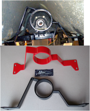

Our driveshaft safety loop offers the most clearance on the market and will work with your current long arm. We always have them in stock and ready to ship, if you have any questions feel free to contact us (309)382-6252.

This could be the solution for ARH LTs w/cat'd y-pipe, as the UMI unit would not clear the pipes on mine (SLP Dual Dual exhaust).

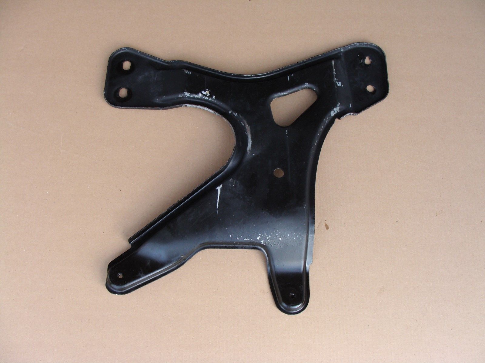

2. Is there a convertible version of this which offers 4-point X-bracing like OEM? i.e.:

Our driveshaft safety loop is not a brace in the sense of the factory brace but it is a solid unit and we only offer the one mounting version.
