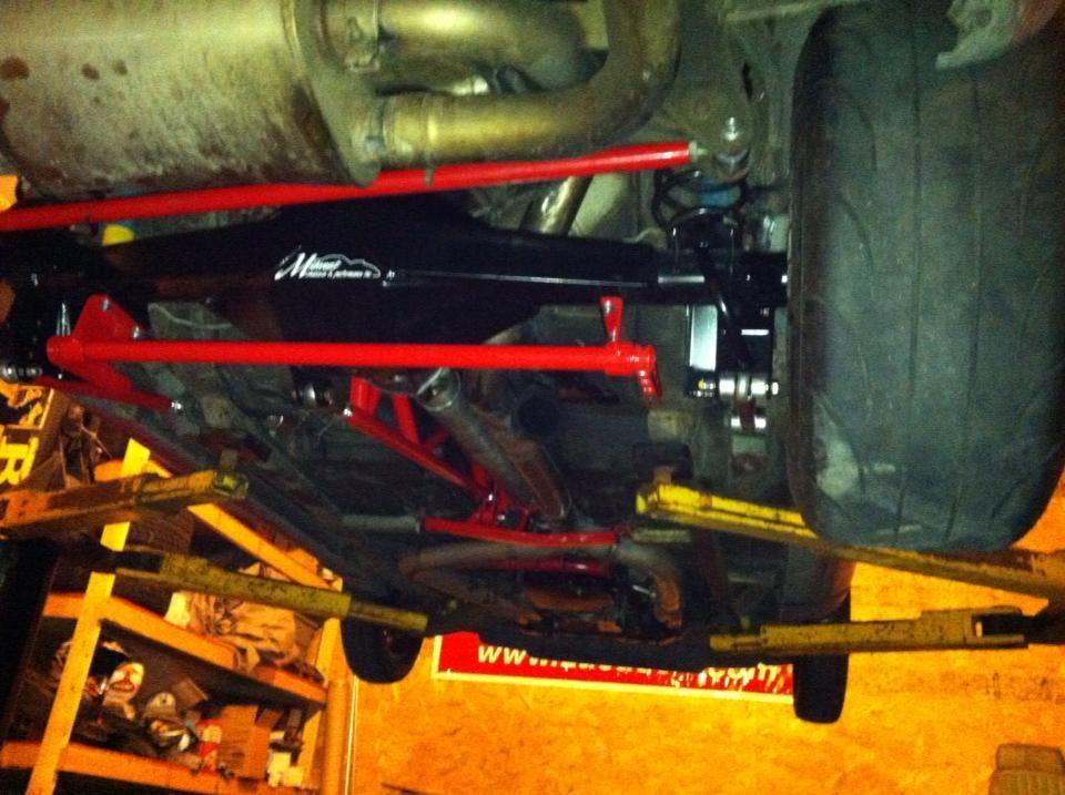

it sounds much worse then it is, one of these days its going to catch on something bad.
In the mean time I am looking for one that sits higher or goes above the drive shaft
Old Apr 17, 2015 | 03:03 PM
BMR Tech2's Avatar
LS1Tech Premium Sponsor
Joined: Apr 2008
Posts: 4,173
Likes: 19
From: Tampa FL
You mean like this?
http://www.bmrsuspension.com/?page=p...480&superpro=0

Old Apr 18, 2015 | 09:20 AM
01ssreda4's Avatar
iTrader: (96)
Joined: Aug 2007
Posts: 24,241
Likes: 89
Didnt realize we were talking about something like that, why would someone design it to go under the exhaust like that is beyond me. Well, ya see something new everyday.
Old Apr 18, 2015 | 12:41 PM
MyFirstLS1's Avatar
Joined: Apr 2009
Posts: 365
From: Orange county, ny
Yeah exactly what I need. I'll see if I can find a buyer.
