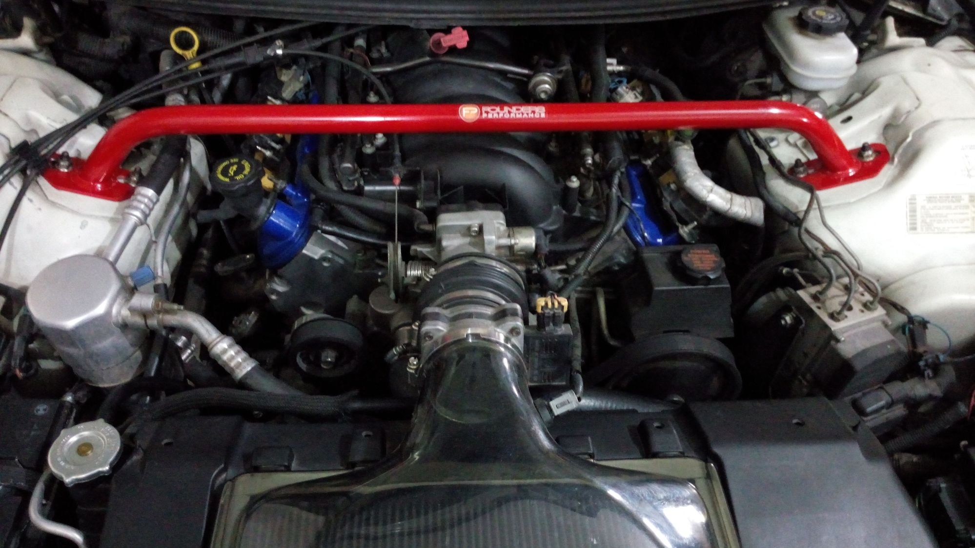

Thanks guys, it really looked like a lost cause given the apparent big gap, but thought I would give it one last shot before getting rid of it, and I followed these instructions that I found in a similar post here in the forums:
Here we go again....you CANNOT get the shock tower brace in place, unless you A) remove the nuts from the upper shock mount on ONE side of the car, and remove the nuts AND bolts from the other side of the car; B) loosen/remove the sway bar link on ONE side of the car; C) lift the front of the car, and push down on the wheel that you took both the nuts and bolts off. As the studs from the upper shock mount go down into the wheel well, put the STB in place; D) bring the wheel back up, and guide the studs through the STB; E) replace all hardware and lower car to the ground.
Here's the result:

Reason being is the strut studs distance apart narrows (between passenger and driverside) the closer to the end of the stud since they are mounted at an angle. once you get the mounting plate further down on the stud/ flush the gap opens back up and allows proper fitment.
Had the same issue when I just rested mine on the studs without removing the nuts.
