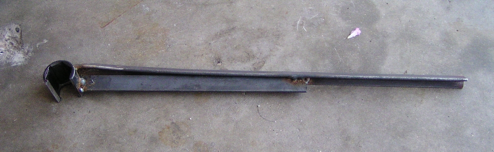

I don't know which type of Koni's you have, but my DA's (and SA's also) have the threaded rod as part of the top hat, and the top hat tightens to the top of the shock rod with a large nut under the hat. The nut has a seal around the edge of it.
If yours is the same design, maybe something below will be useful to prevent the rod from turning when you need to R&R the shock nut:
* You could try channel locks on the large part of the top hat
* You could buy a 15/16" offset box end wrench, then cut out enough of the offset box end to allow it to slip over the shock rod and over the nut (after sliding down the seal)
* You could buy a custom tool such as this to grip the nut under the top hat (not my photo, but this is what I use to remove the top hat to R&R the coilover sleeve)
