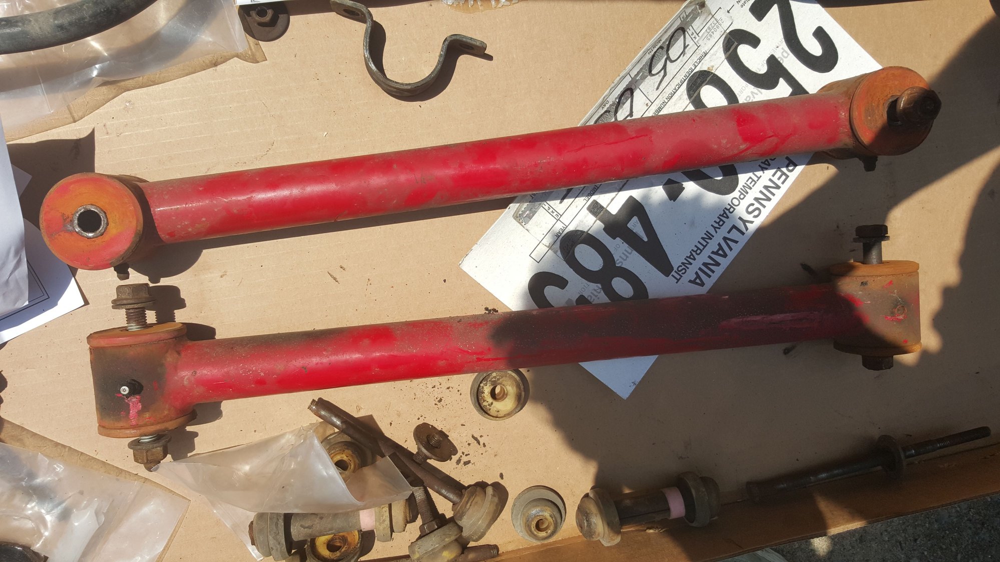

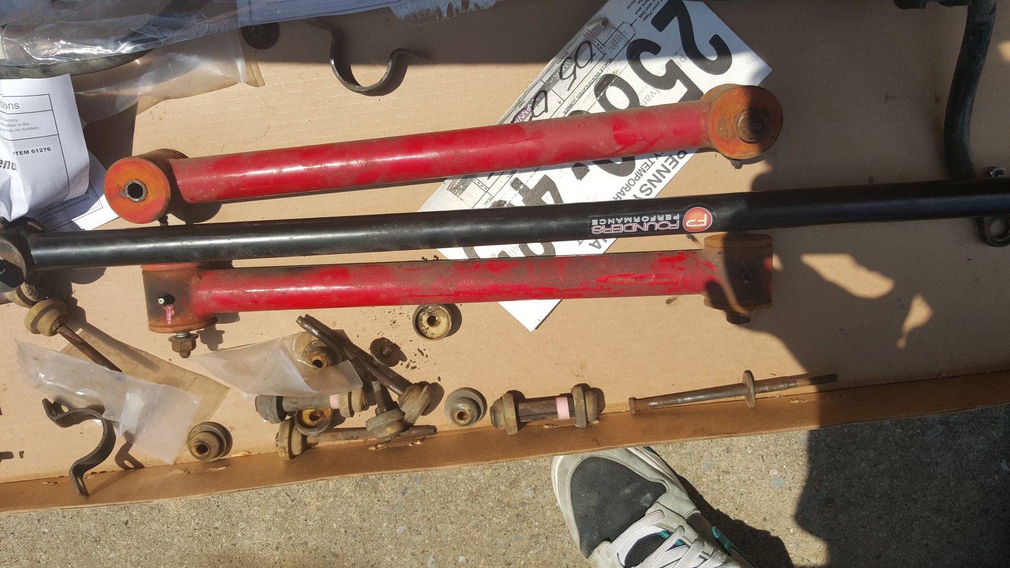

Hey, i just took LCA and panhard bar if my wrecked formula, I was wondering if they are in good condition am if I should put them on my new car. Thank you.

I'd stay away from the poly/poly LCAs due to their binding issues. The panhard bar would probably be fine, but you won't really see any improvement....

I'd have to agree with blackngold minus the panhard bar as you want to be able to shift your rear end from side to side.
Poly/poly end non adjustable suspension items is almost a waste and no improvement over just putting new bushings in the stock components, if a customer insist on poly poly LCA or PHB we can still make a set that are on car adjustable.

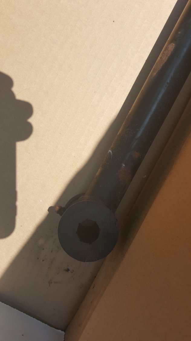

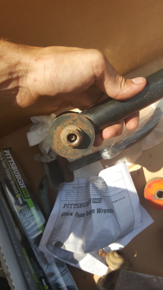

I noticed one picture of the panhard bar is missing the bushing insert also.

True, but it doesn't look like that panhard is adjustable unless I missed it.

Those arms will be fine to re-use. As will that panhard if the car is stock height. If you are lowering the car, then you will want an adjustable panhard bar. Just make sure to grease those bushings with a full synthetic grease and they will live a long and trouble free life.

I didn't have to pay anything for them since they came on the car, I was just wondering if I should swap them over to my new one. And yes it is missing the insert, the insert got frozen to the bolt.
