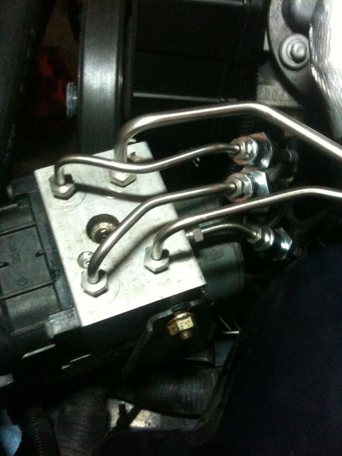

Any reason I couldn't replace the flex lines off the abs block with hard lines?
Pic of what I'm talking about:
All 4 are rusty on the other end and need to be replaced. Thinking of just routing hard lines in place.

I wouldnt but thats just me... there is a reason they are flexible at the end.. to keep from cracking and breaking from vibration and suspension shock.

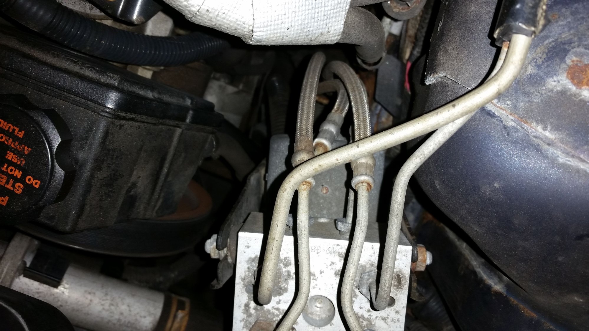

My aftermarket line are also flex so probably a reason.

Question
How do those pictured flex?!

I can see the braided part after the transition adapters

The below connection is to stainless flex line. Bad pic I know

I'm actually going ahead with just hard line with extra slack for some movement.
I just hope the bubble flares I made work or I'm gonna rage...
