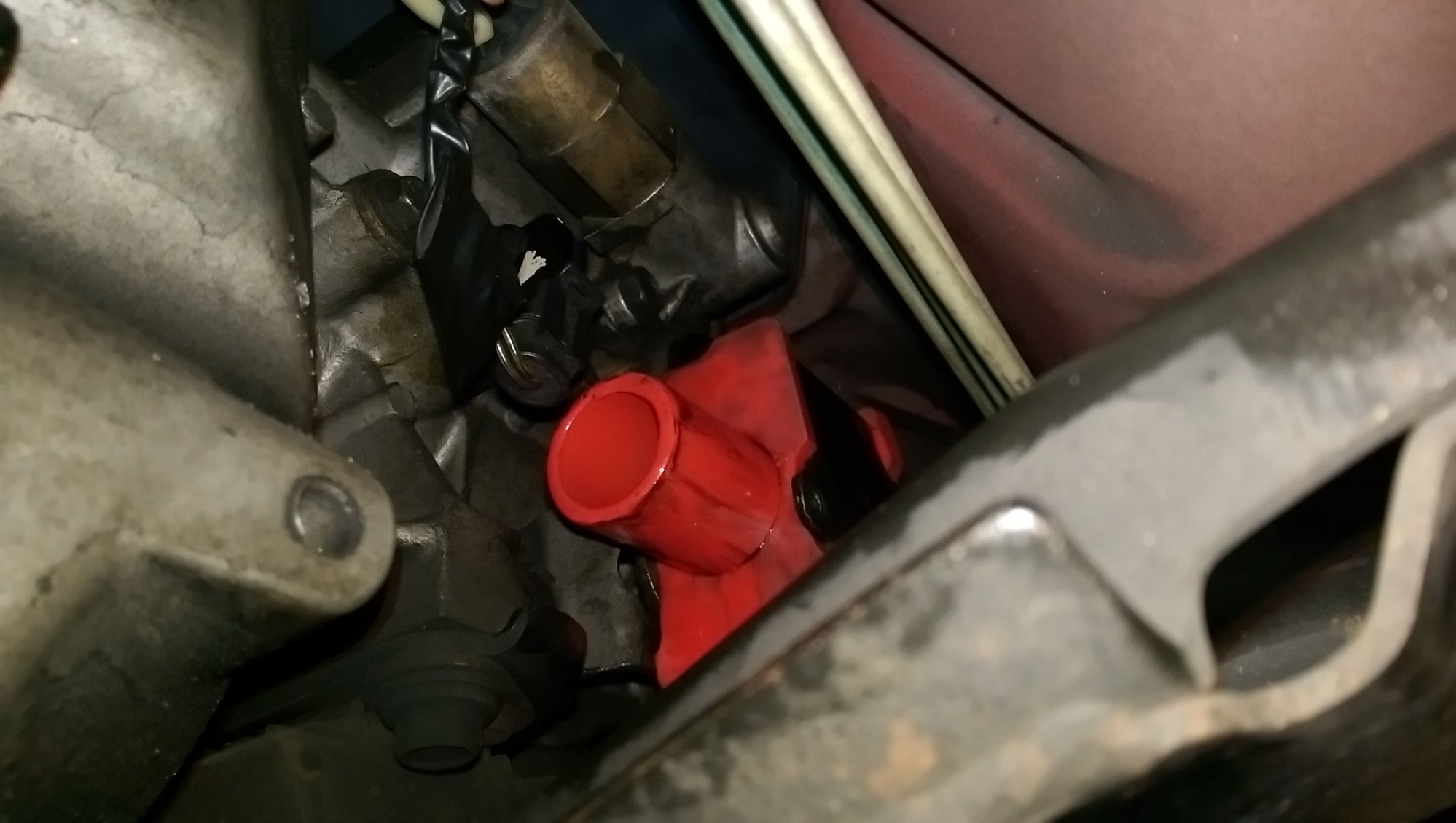

So I installed a couple of parts on my car this weekend. I will first list them out.
1. TA001 - Torque Arm, DOM, Adjustable, Bolt-in from BMR
2. RSK031 - Rear Suspension Kit, LCA's and Panhard, non-adjust from BMR
3. Strange S60 rear (Drive shaft not made/in yet)
So my question- On the tail-shaft of the transmission (M6) there is a sensor right by the end of the TQ arm. The clearance between the two is very small as it sits on the lift. I mean they are really close and I am wondering if that sensor/plug is at risk of damage if I were to run over a bump, pothole, or Justin Bieber. So is this normal or is something up? Picture provided for refrence.

Is your torque arm still mounted on the Trans? If so I'd suggest going with the Trans crossmember relocation kit. Trust me it'll save you broken tailshaft housings. Ask me how I know...
That clearance is very tight, I'm assuming whatever bushing you're might have some flex and mobility under hard acceration, might cause contact with that sensor.

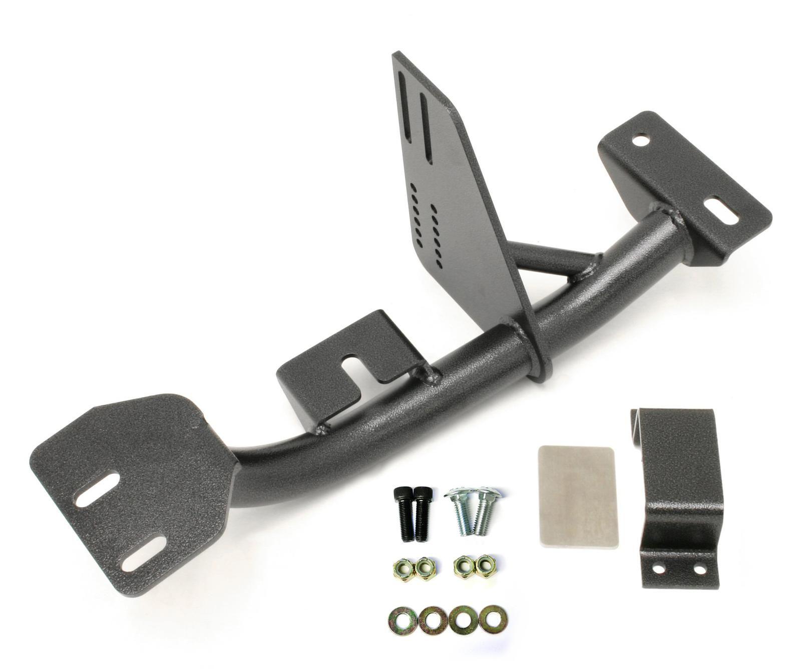

It removes it from the transmission completely hence you don't risk breaking the tail shaft. Here is the one i am using for reference.

The clearance gets pretty tight between the torque arm and that sensor but you will be fine. The torque arm moves very little front to back as the rear suspension articulates.
Like others have said it also wouldn't be a bad idea to get one of our torque arm relocation crossmembers (TCC006) to get the torque arm off the transmission as the torque arms puts a good amount of load on the tailshaft housing.
BMR torque arm relocation crossmember (TCC006)
