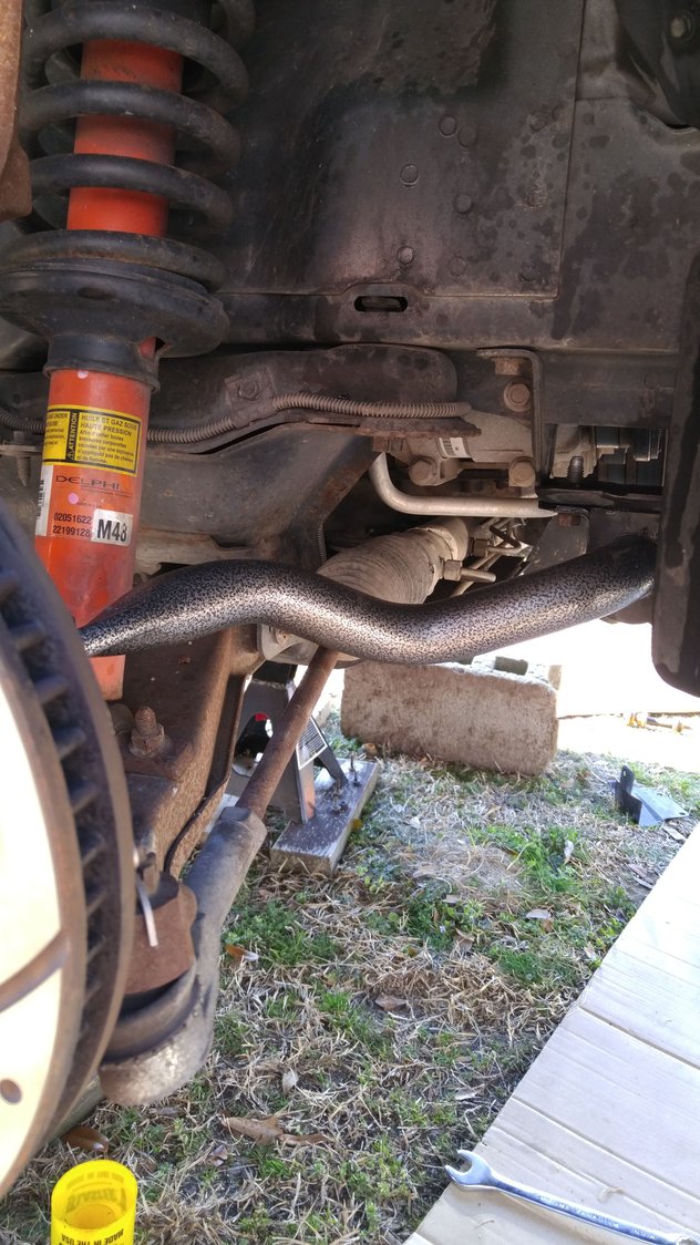

It will lock it in a bind as the suspension sits unloaded. I know because I did this. When I put the car down on the wheel the swaybar had it locked and it wouldn't budge a bit. Besides it's a straight pita to get on with the wheels up.
Here are pictures I took when I was trying to figure out what was wrong as I could tell that something wasn't right. The ends of the sway bar should be point fairly parallel or slightly upward with the chassis and not down like in these pictures.
This should be mostly parallel with the car.
See how the end of the swaybar is being pulled down by the uncompressed suspension? You don't want to tighten it up like that.
The bushings sure didn't like it.
