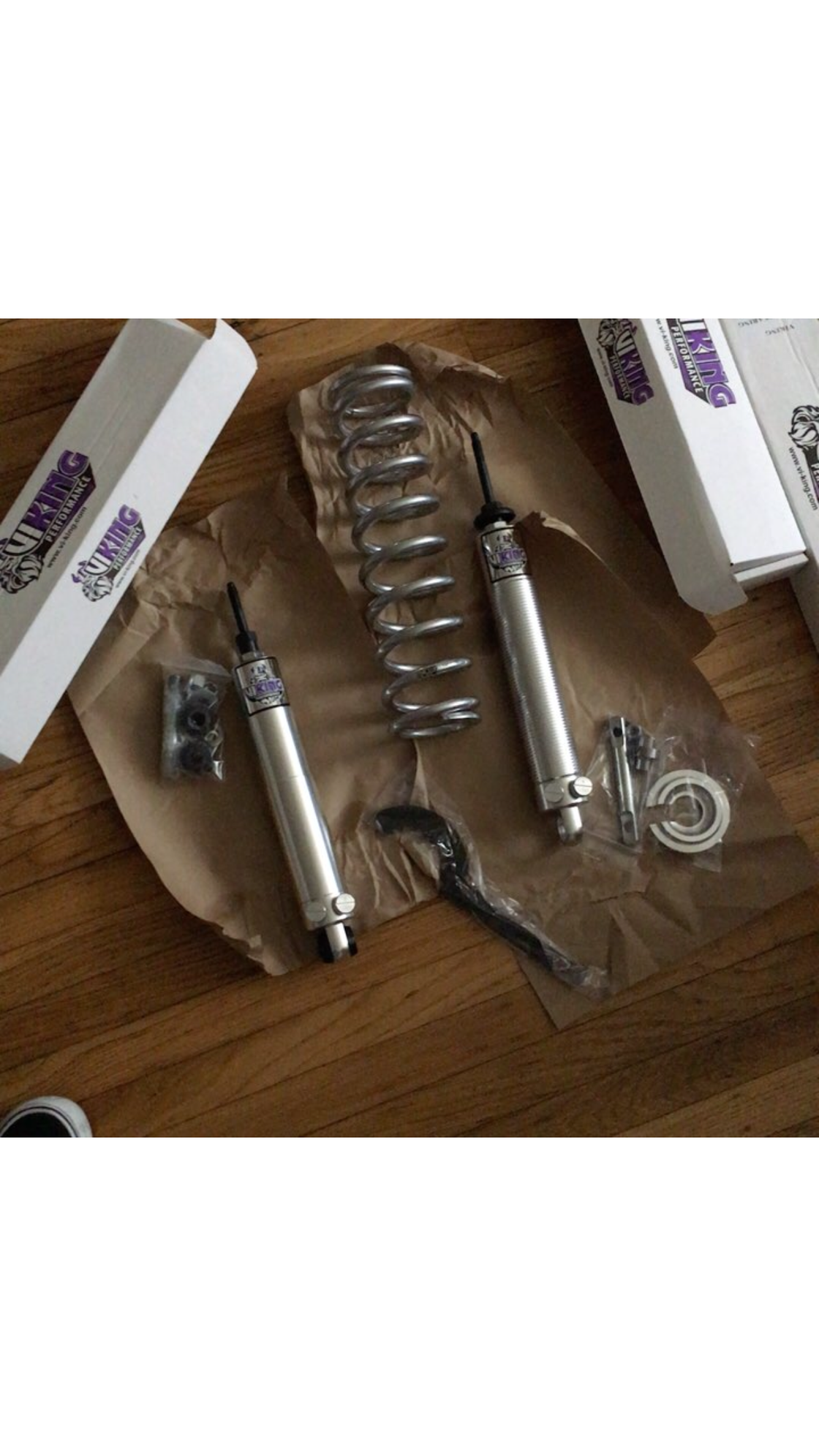

What 60ft times should I expect from these struts and shocks. Front Spring rate is 300lbs. Car is 98 Camaro SS with minor weight reduction. Specs are ms3 cam, 241 heads untouched, ls6 intake, th400, 3.90 gears on 100shot through nitrous outlet plate. Tires are 295/55/15 MT drag radial.
Part# A206-300K bearing mount on struts.

There are a ton of variables to consider with this. Front shocks and springs are only part of the equation. Rear suspension is going to play a major role in this. These shocks and springs though have been good to 1.2x 60' times, assuming these are the Warrior series. Crusaders are good for even quicker.
Assuming everything on your car works properly, with your mods I would expect somewhere in the mid-low 1.4 range
