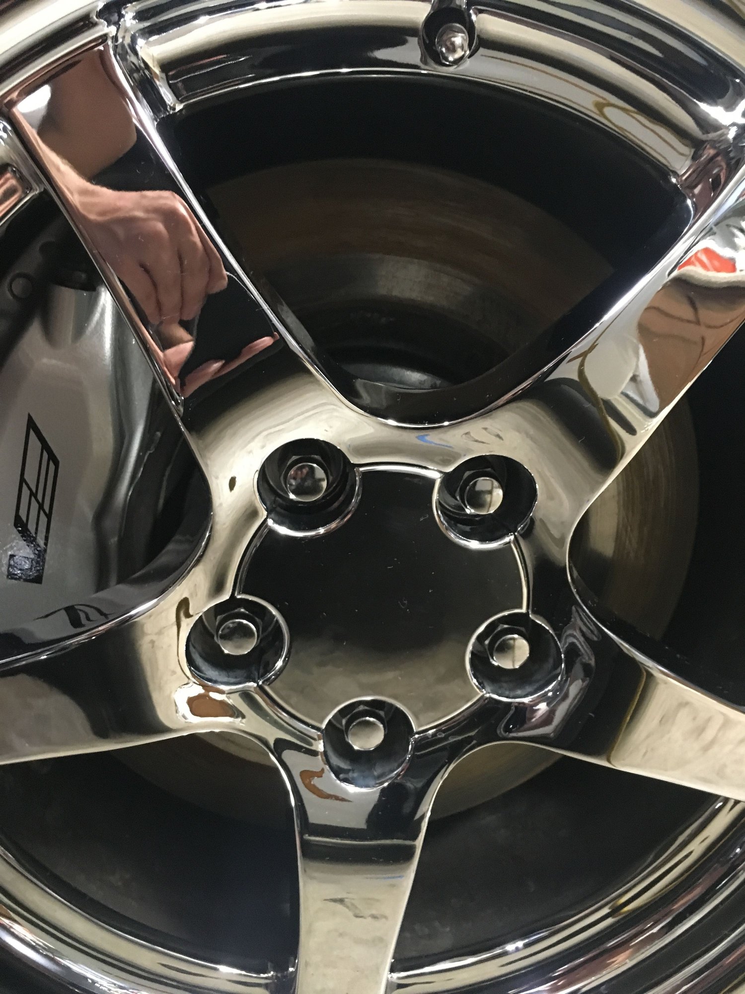

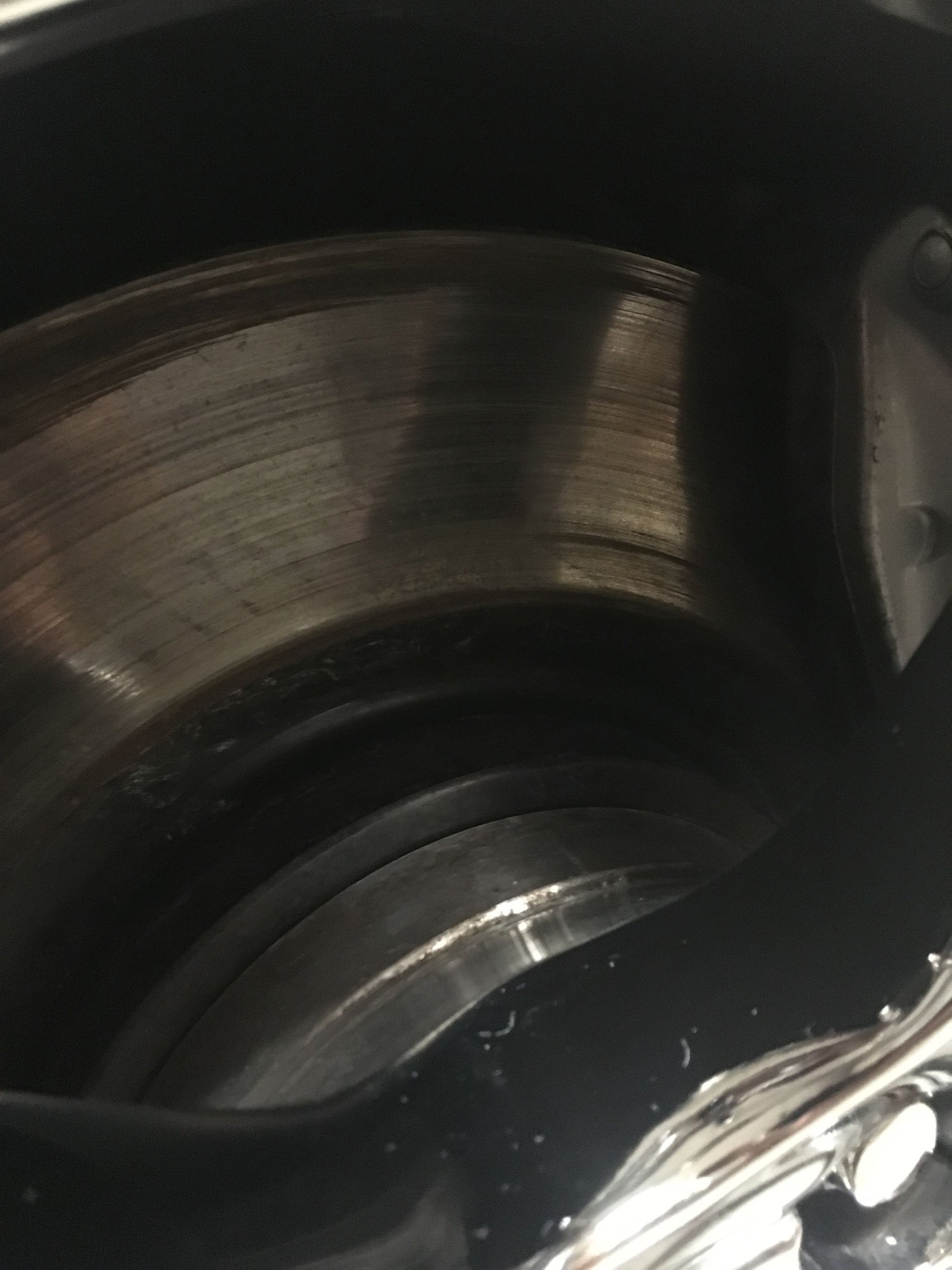

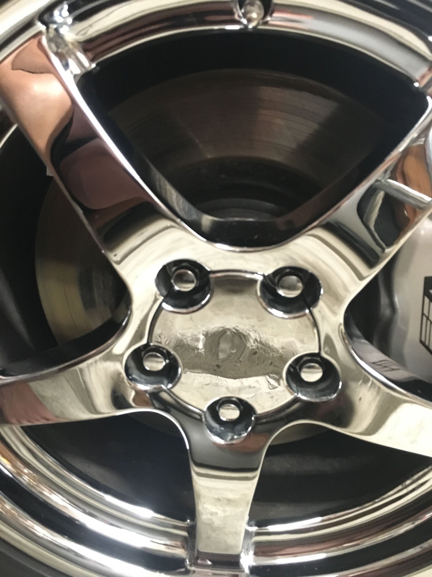

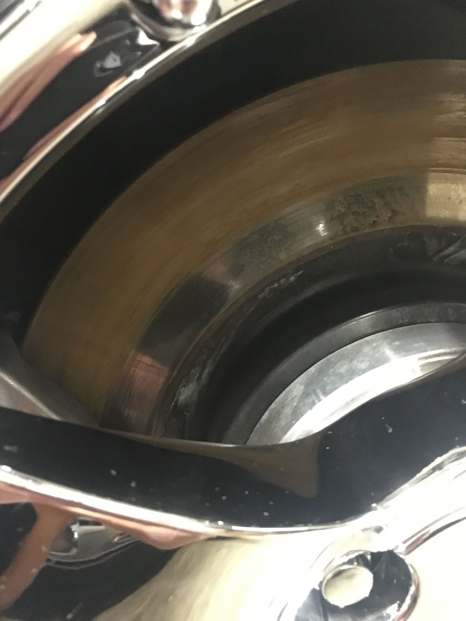

Ive always had a pull to the left when braking even before I did the v swap on my f body. With the v brakes it just became a little more evident and I didnt think much of it. Tonight while washing my car I use a chrome cleaner that has acid in it which makes my rotors rust very fast. I went to move the car into the garage and noticed this. The passenger side pads look like they're only making 1/4 contact with the rotor. I didnt use much pedal pressure but it should still be making full contact like the driver side. Anyone know why?

What rotors are you using? Z06 or Camaro SS rotors? On F-Bodies the Camaro SS rotors are the "correct" rotors as the Z06 rotors are not quite large enough in diameter to make full contact with the pad, but I believe this problem is different either way. It really sounds to me like you have warped rotors.

I am using the correct camaro ss rotors. There is no pedal vibration when im stopping so I dont think its warped.

Ive had the brakes on for 6 months lol this isnt a new problem.

Gotcha. Check the pad wear for irregularity, pistons sticking, then if that all checks out...do pad bedding process
