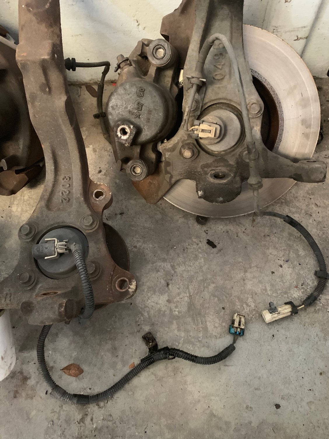

Posts: 12
as you can see, they are not

Those are definitely different. Shouldn't be any different. Part numbers online show the same. Are you sure it's a F body spindle you have? See if your wheel bearing bolts up, then you can use your wiring harness

Parts layout catalog shows 7470587 hub for 94-02
knuckles for 94-97 are 18021091 and 18060608, knuckles for 98-02 are 18060620 and 18060621
