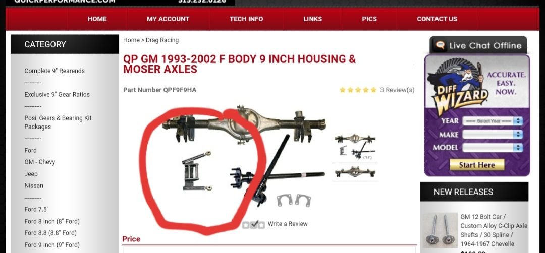

I'm using the tunnel short arm mount as well with the DS safety loop. Moser offered 2 different types of mounts. I'm using the whatever one came with my quick performance unit. Its the mount that gets bolts to the 2 tabs welded to the diff itself. 1 tab on top and 1 tab on the bottom

The one circled in this picture

Ohhhh ok. I got mine from Brute Speed, and i'm using the long arm torque arm still. I have heard a lot of bad things about the QTP 9 inch. A friend of mine years ago had issues putting his unit in as well. Have you tried contacting Moser? The guy who put my rear end in was in contact with them recently, they're still open.
