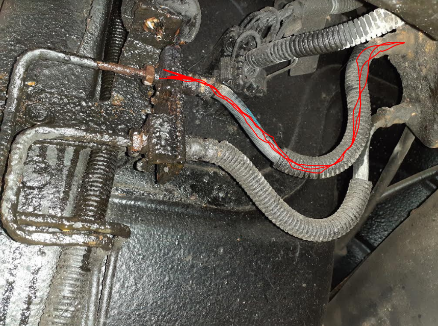

1998 Z28 Auto Camaro, the brake line pictured here is leaking massively out of the fitting on the left side where it meets the hard metal line (all the fluid leaked on the driveway).
Can anyone confirm what parts these are and also if I need two of the same as it were? I want to replace both to be sensible etc.
On RockAuto I think it is listed as the "rear centre" but I am not sure, can anyone confirm please. I.e I need to know what its called so I can order it, it is under the fuel tank.

The 2 hoses in the picture indicates it's a 'traction control' (ABS & TC) system. One single hose would be the 'ABS only' system. So you need to choose from the ones that are indicated as 'for traction control'. And since there are 3 service catergories to choose from, 'Economy' 'standard replacement' and 'high performance/heavy duty, choose from standard replacement at minimum.

I would just replace all of them. If one is leaking, all of them are due.

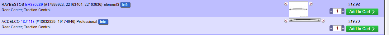

Thanks guys, so which parts do I need to replace both pipes please? The "rear centre with traction control?"
Pictured here, are these correct? Also is it correct that I will need 2 as I want to replace both pipes and both are the same? As in I buy 2 of the below and that will replace both of the brake pipes pictured below in my picture yes?
