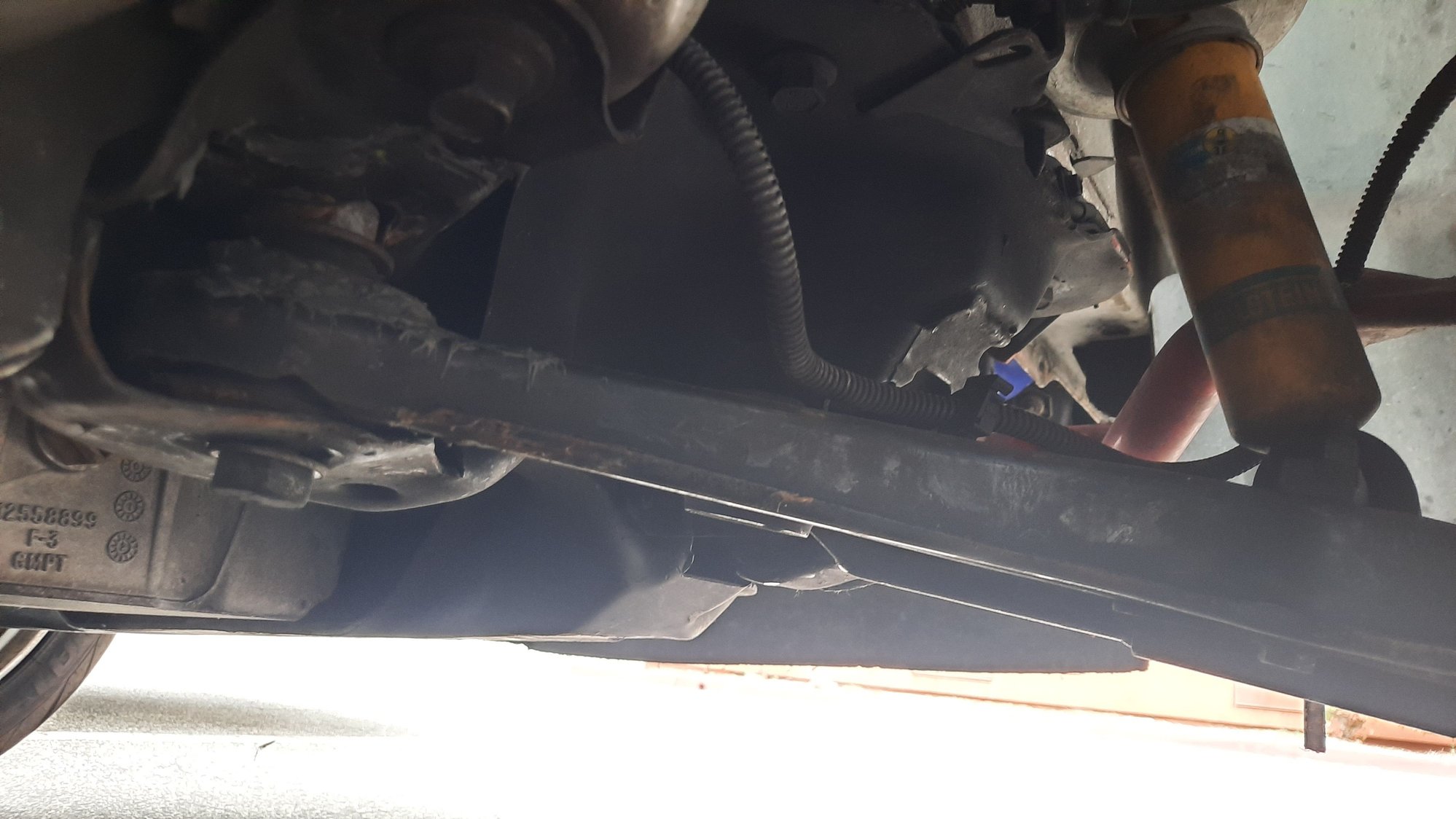

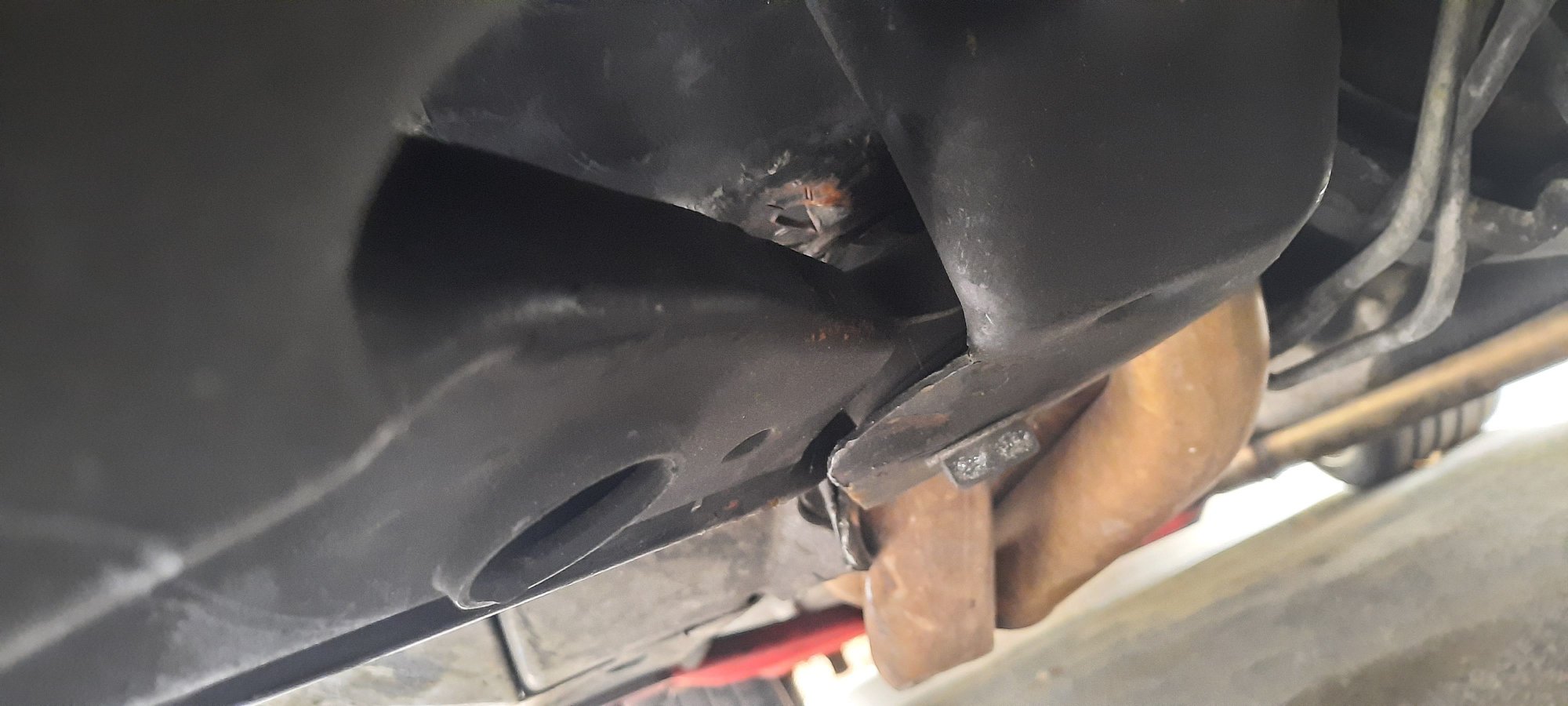

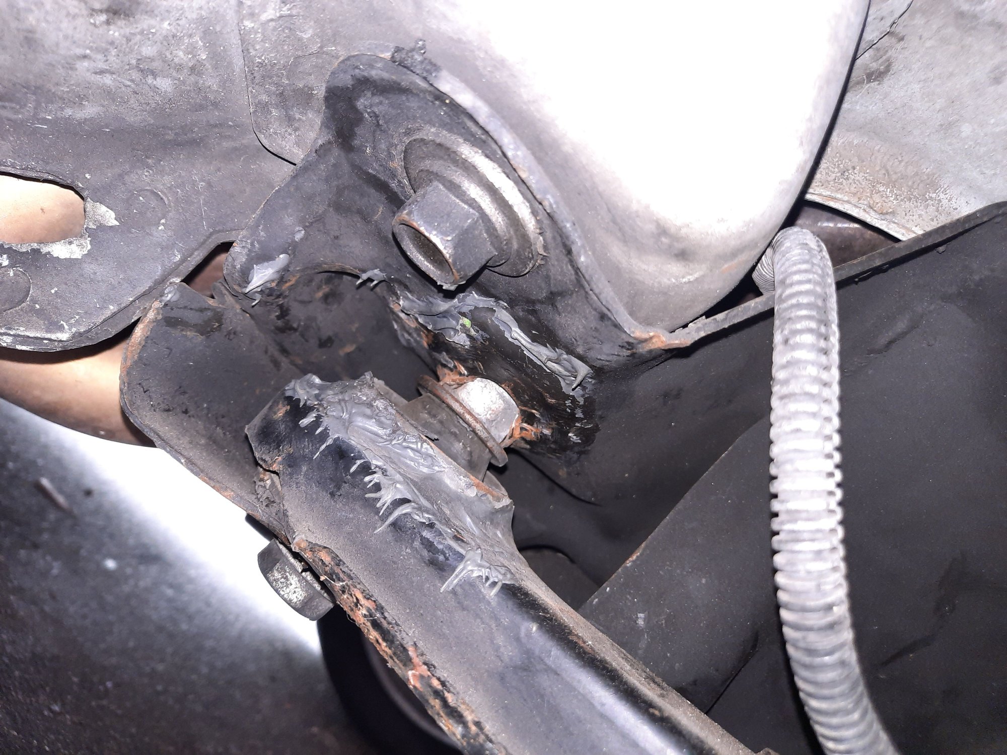

i was making a left turn and hit a curb, a buddy got a forklift and tied a chain to somewhere on the front suspension and pulled it back somewhat, in the process he almost pilled my lower control arm through part of the front subframe..
so i need to know what exactly do i need to replace to get it fixed, is it the k-member, or subframe, i do not know, thanks in adavance

That looks like a mess. Is that grey epoxy smeared all over the place in that one photo? A prior repair? In any case, short of just replacing everything (K-frame and LCAs at least) I think you'll need to take it to a frame shop to see what they recommend. NEVER try to re-align your frame or suspension using a forklift. Its a waste of time and you will cause additional damage. Was your buddies beer at least COLD when he asked you to hold it while he climbed aboard the forklift?

JB weld for the......win??!!??
