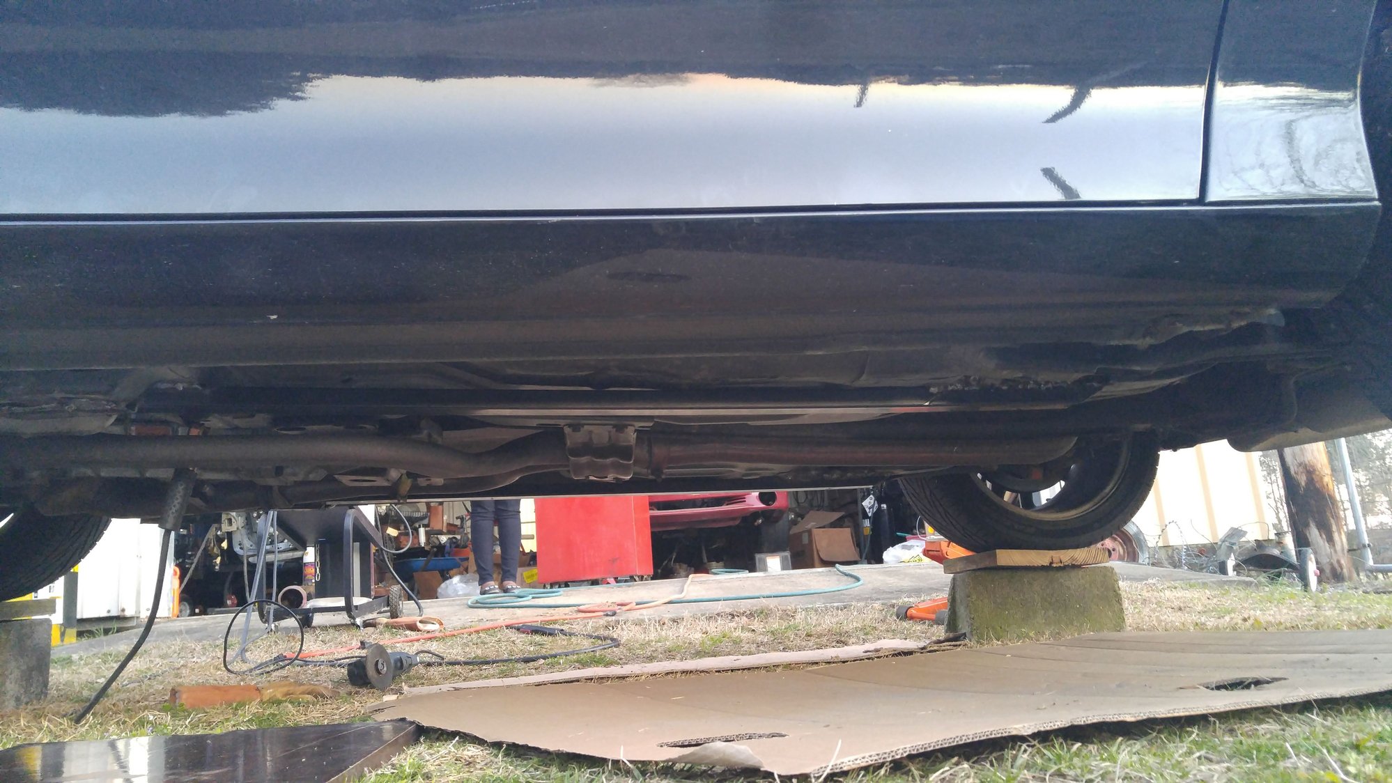

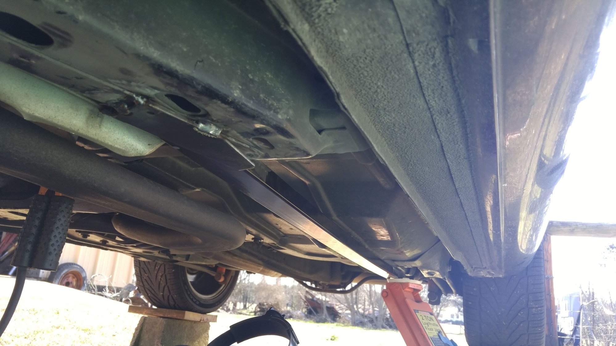

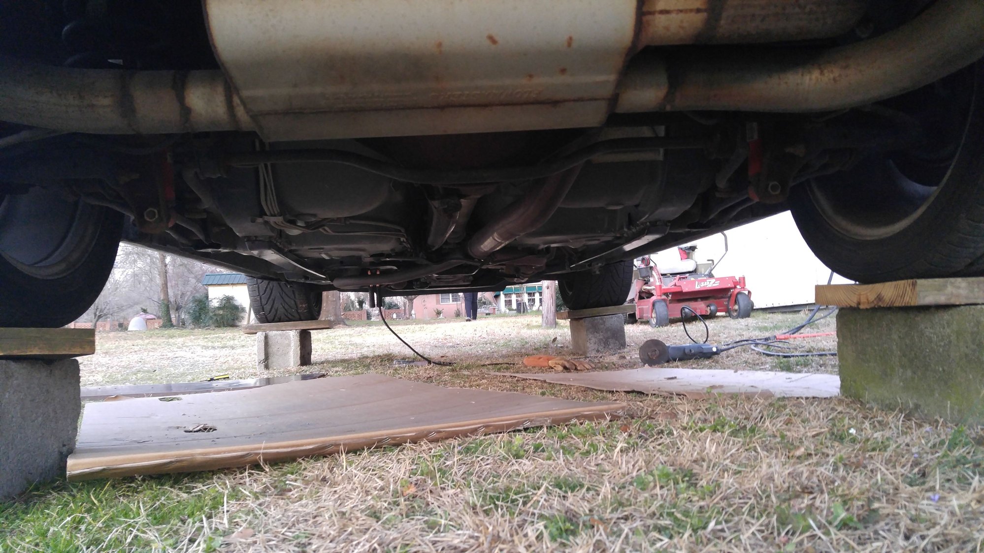

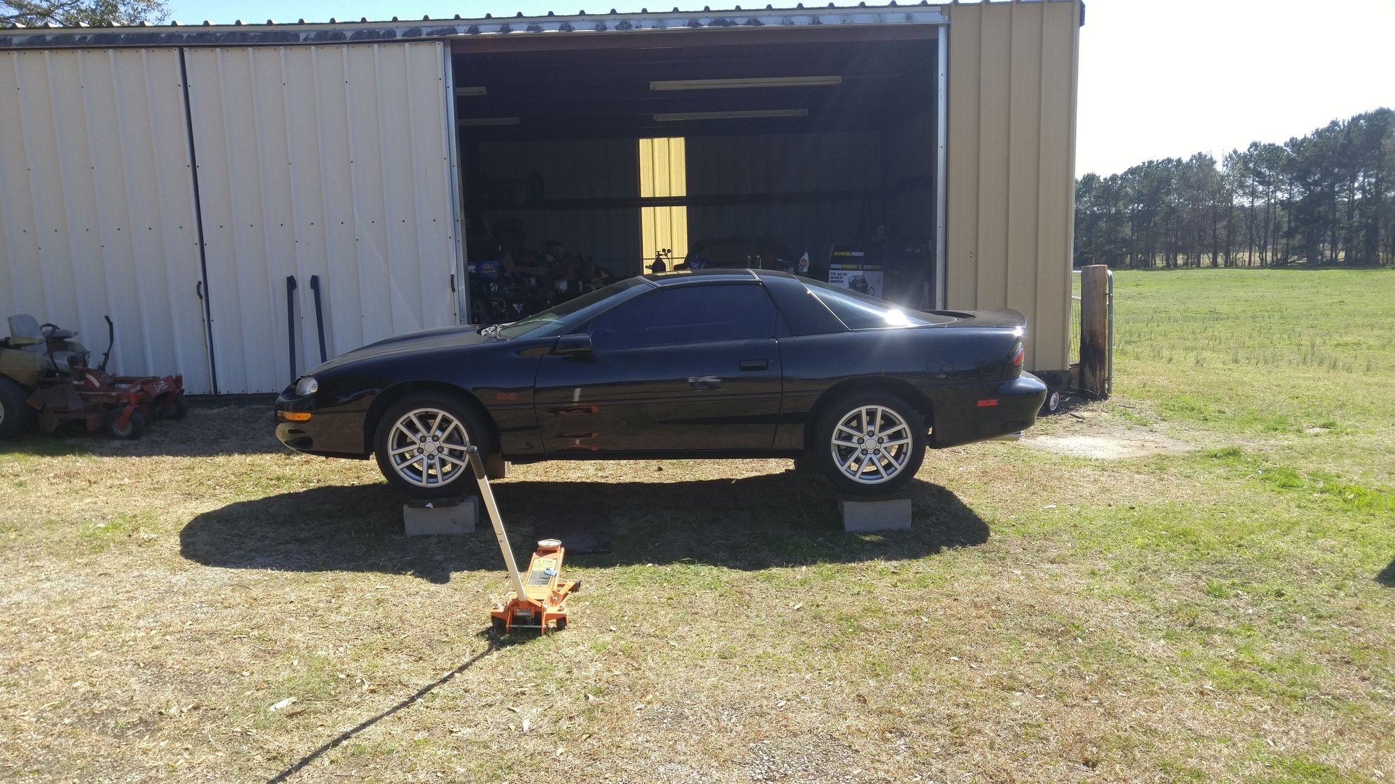

Here's what I did. Have done it with Mudstains as well. If you do something like this you make sure your setup it good and solid, and good boards/blocks to support the car. The last thing you want is for it to fall on you. Probably a good idea to have a friend with you incase something were to go wrong.

I see you went with the more effective design SFC's. Any negative side effects after installing? Did any heat work it's way up to the carpet/interior?

I run the MWC True Subframe Connectors also and there are zero negative side effects.
I did have to clearance my floor board a tit.
