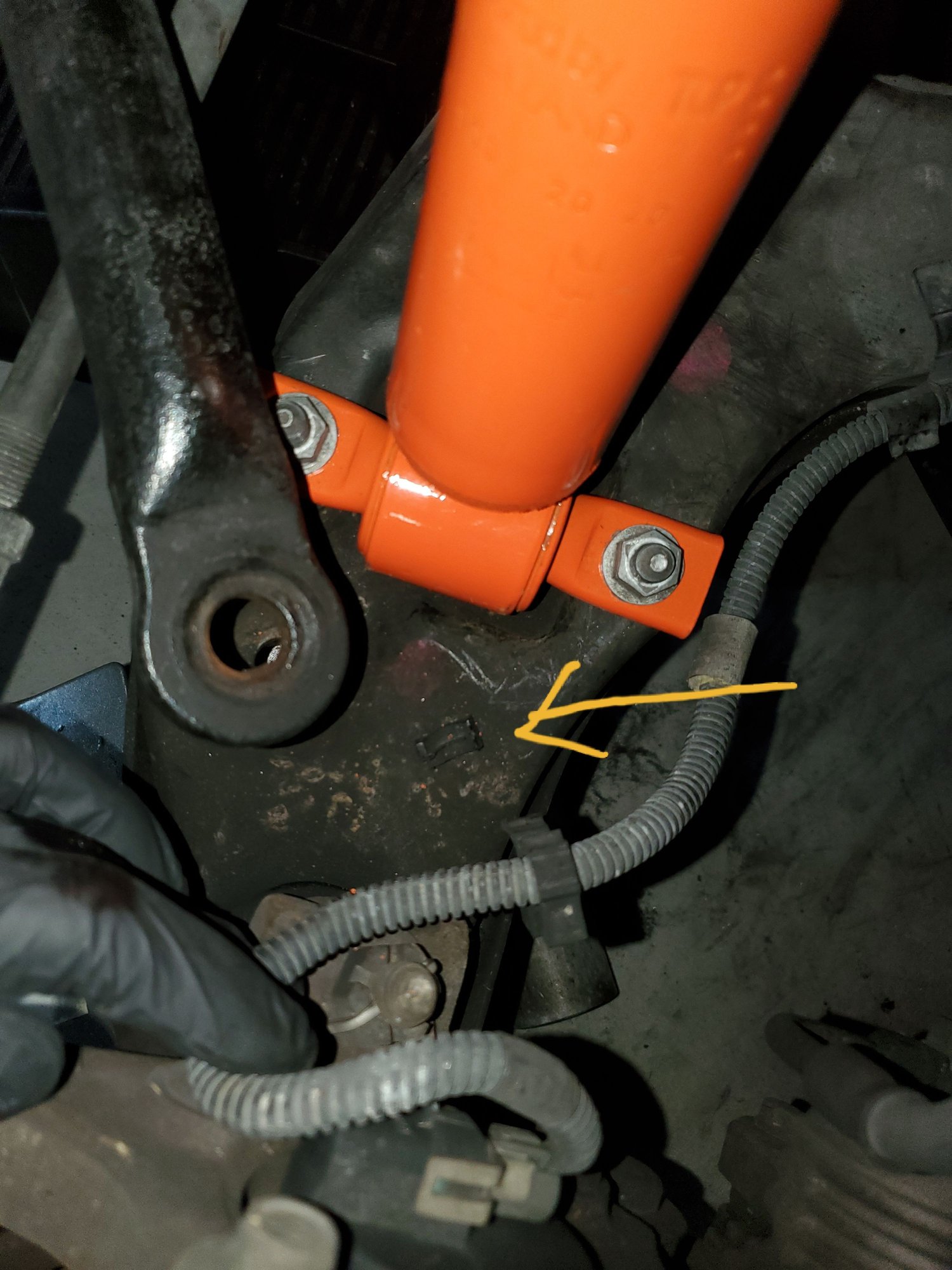

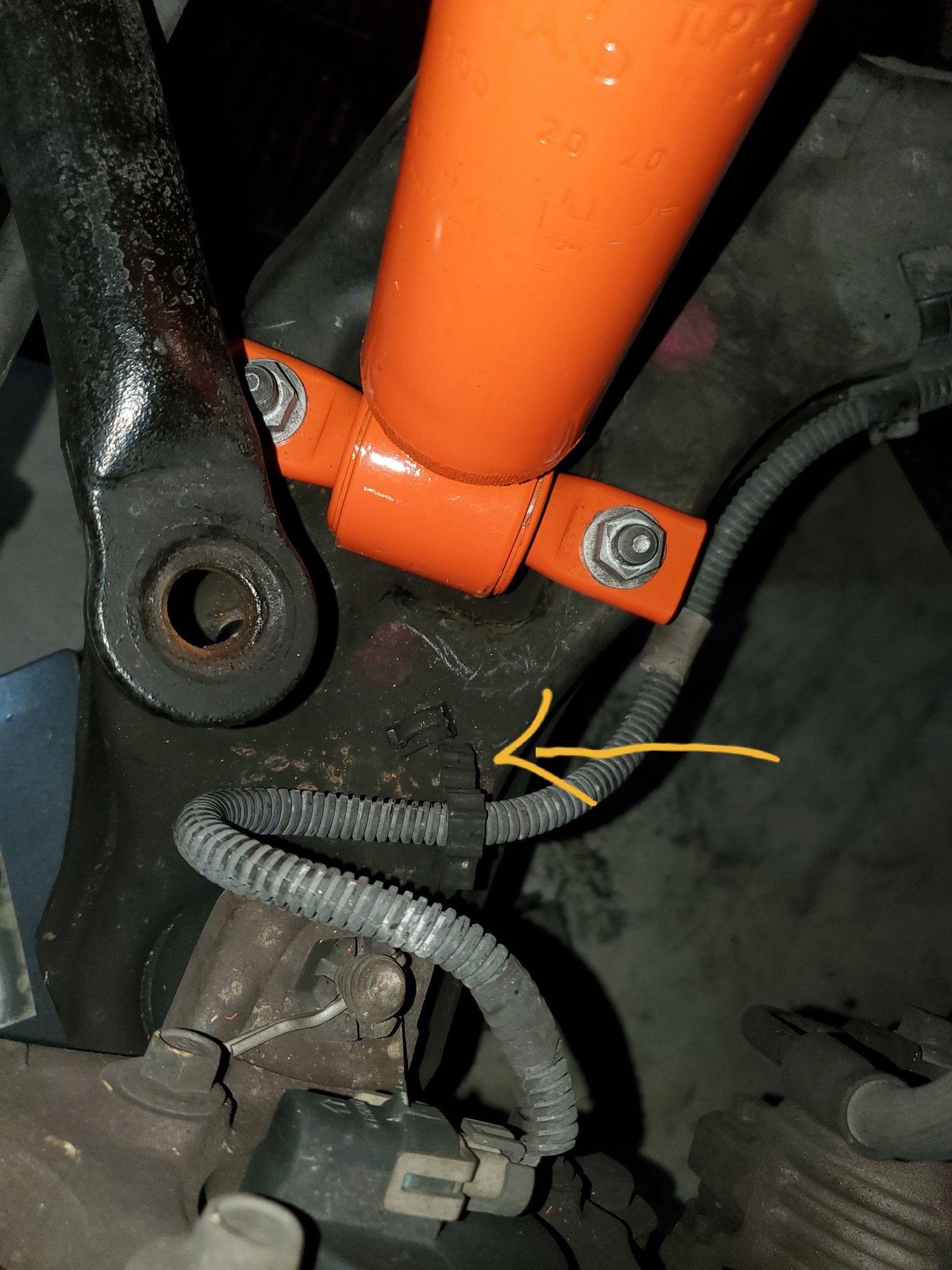

Was removing my shock out of LCA mount and broke the plastic bracket piece that holds the wheel speed sensor wire or ABS wire, im not sure which it is.
But what is the plastic part called that holds the wire onto the LCA. I need a replacement. I'm looks like it has a tab that snaps into the LCA. Thanks!
You can see the broken plastic piece in the picture.

That should be a Delphi rosebud clip. You can find them at a number of places, but this site has been good to me, they sell in smaller quantities, and their site gives enough information that you can properly match up the correct size: https://www.clipsandfasteners.com/wi...clips-s/78.htm

Great!! Thank you! I was having the hardest time finding what it was even called.
