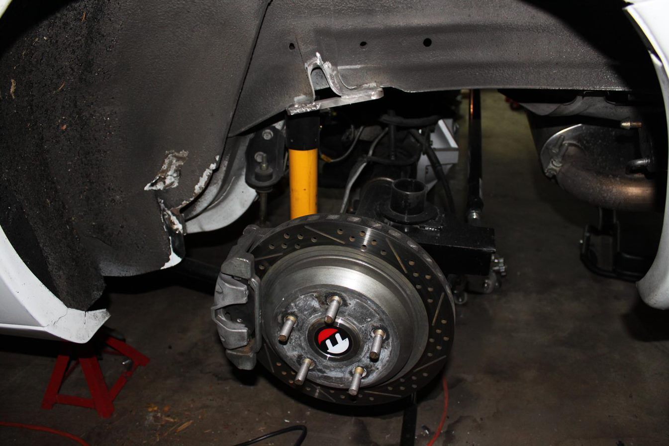

Hey. During my attempts to make my 19x12 wheels with 325 tires fit, I had to do some extensive surgery on the inner wheel wells. That being said, I no longer have the factory bump stops. What have you done to add a different style of bump stop to your cars? My car is a 2001 SS. Thanks.

I'm sure some people will tell you they're not even running bump stops anymore. Did you grind away the bolt holes also?

Yes. I had to get rid of everything. I heard somewhere that you can use some from a Jeep of all things that mount to the axel tubes. I am going to look at those this afternoon and see what might work.

I did some fab and moved them in flush.

That looks good. I will look at that option next time I climb under the car. You have a really nice cone-killing Trans Am.

I added air bags, or drag bags. Cheap option, they fit inside the coil spring. Worked great.

Hey. I have coil overs so that option is not going to work for me, but, there might be an air bag that mounts to the axel. Thanks.
