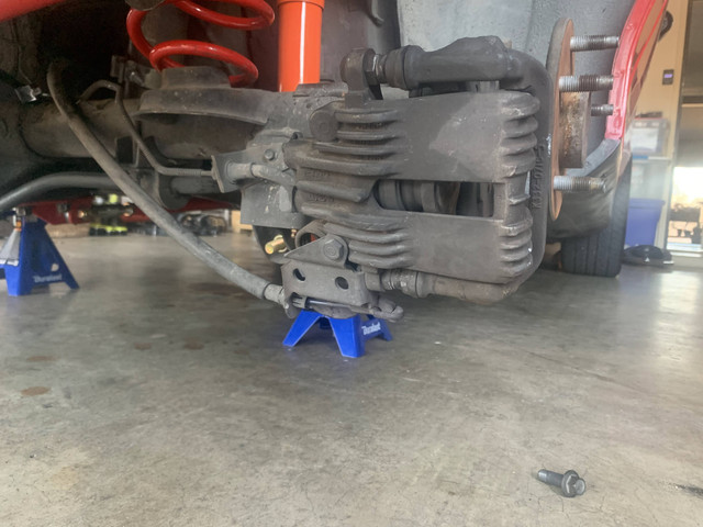

Having some issues with my rear brakes. I bought some new rotors and they don't fit.
I'm thinking the previous owner swapped the brakes for LT1 calipers. Are these LT1 calipers?

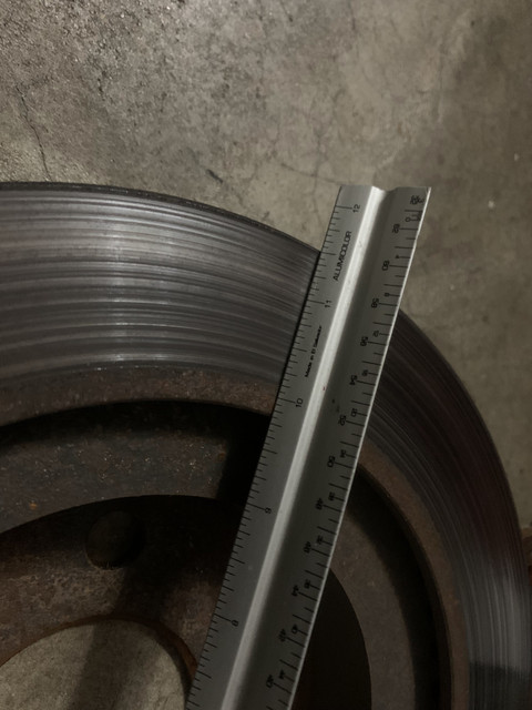

My old rotors are 11.5" diameter, new rotors are 12.0".

Those are definitely lt1 calipers. Unfortunately the parking brake is different from the lt1 to ls1. Could pull the parking brake cables from a lt1 car, or get ls1 calipers and caliper mounts. Check local junkyards.

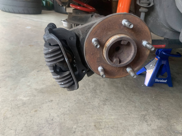

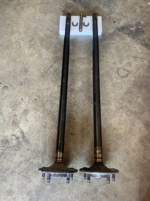

Made some more progress today. Axles came out easy. Had to beat the hell outta one of the old backing plates to get it off.
Just a test fit here. E-brake cables are on their way in the mail. Still need lines and diff fluid.
