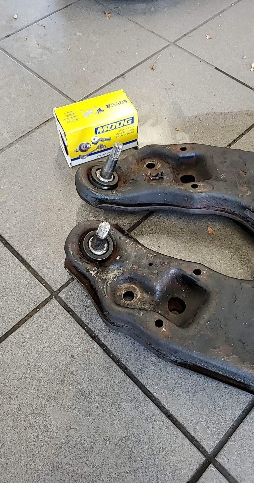

EDIT :

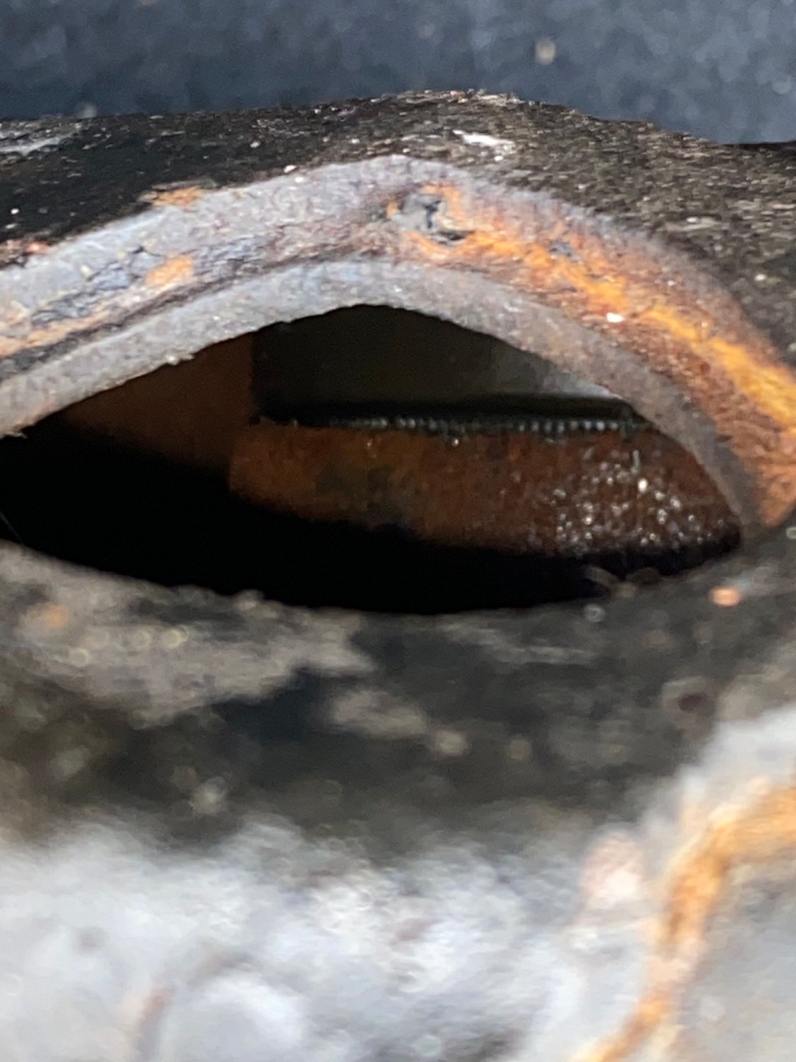

This is correct installation depth for a lower ball joint on these.
I compared the witness mark on the OE ball joint removed, can see flush fit on one side and tapers up to 1/16" as it gets over to other side.

is it straight or cocked ?

Factory one has a rust ridge that mimics this fitment. It’s perfect flush with arm from bottom but inside has that little gap on the one side
