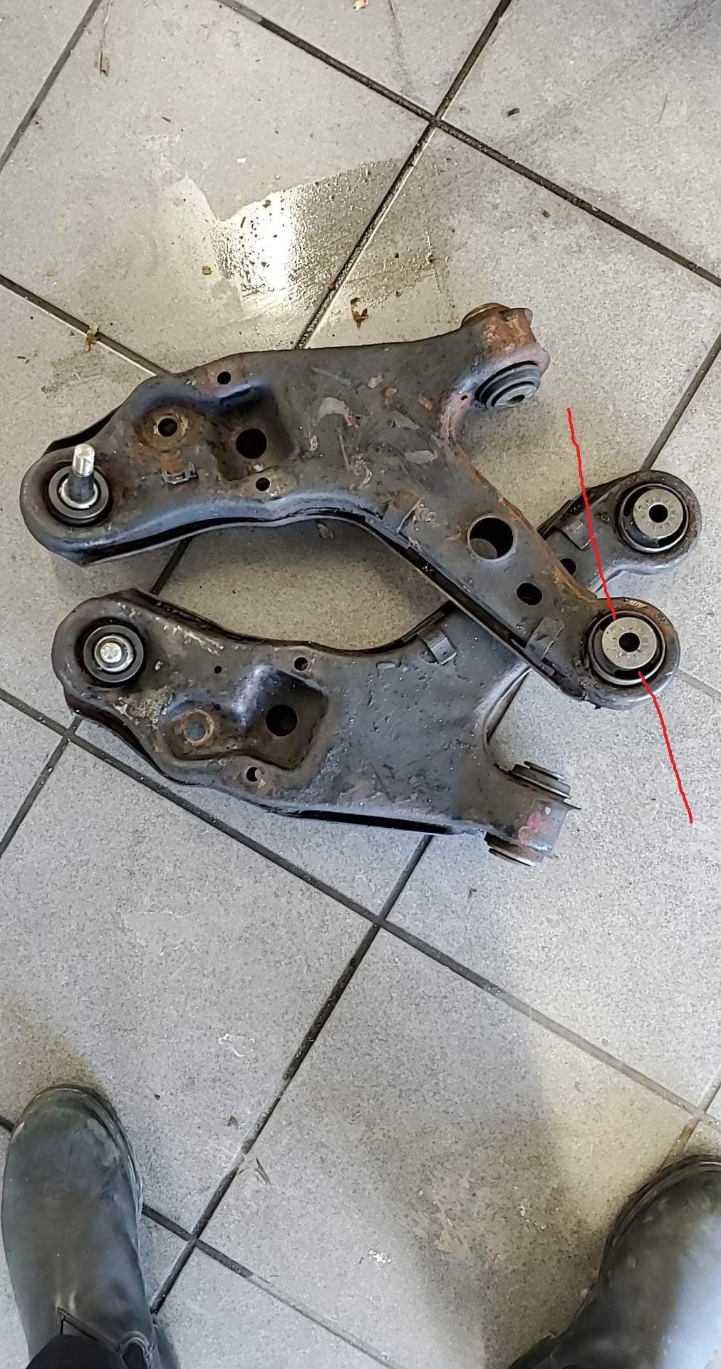

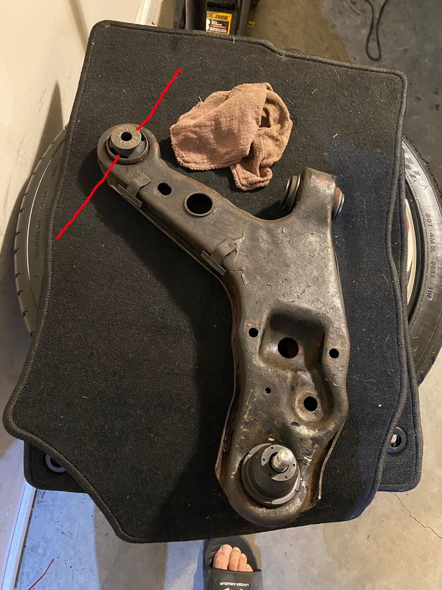

I had my lower A-Arms taken out and brough to a recomennded GM tech (I am service manager at a Honda store) and had a tech of mine suggest a tech at the local GM store he knew whos "the GM GUY" to do my ball joint and bushing pressing. So he did them, originally went to get them and the Caster bushing was 90* off on the left arm, so I left it. The right arm is about 20* off of ideal spot, but Im not that guy, so I just took it.

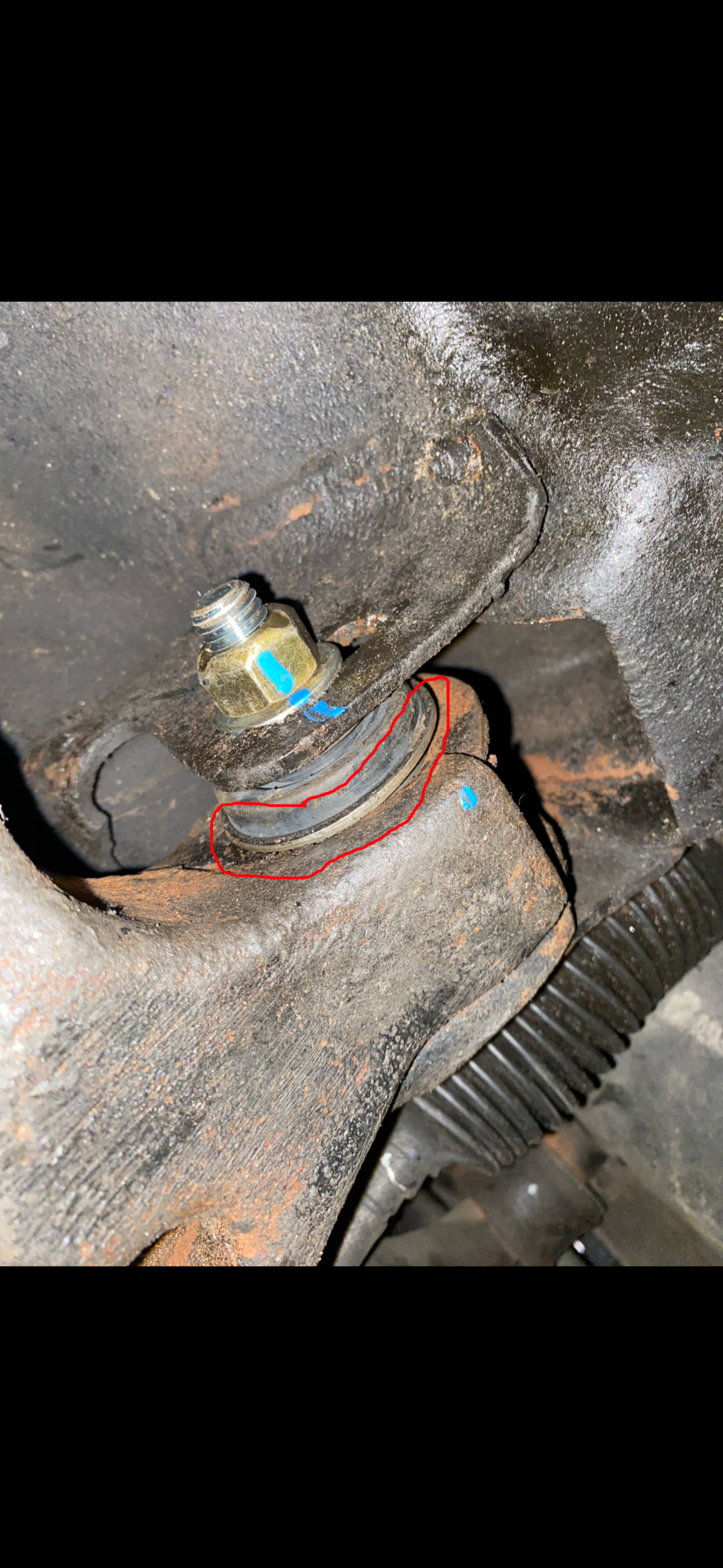

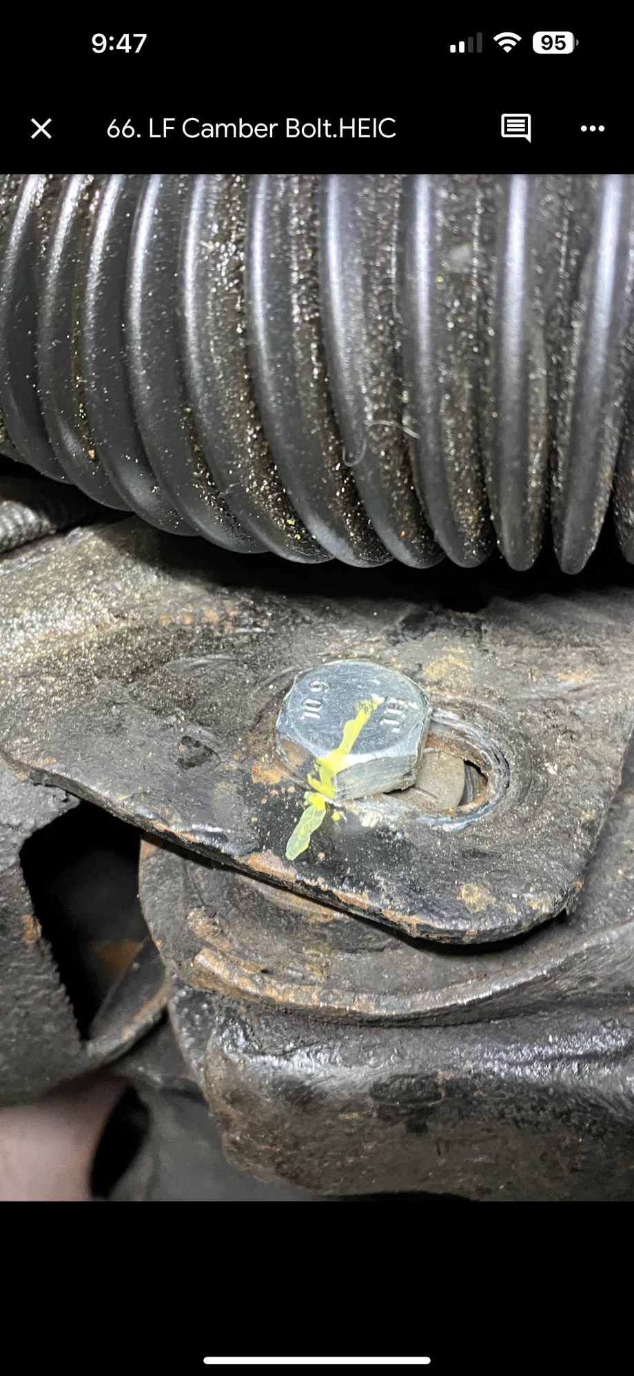

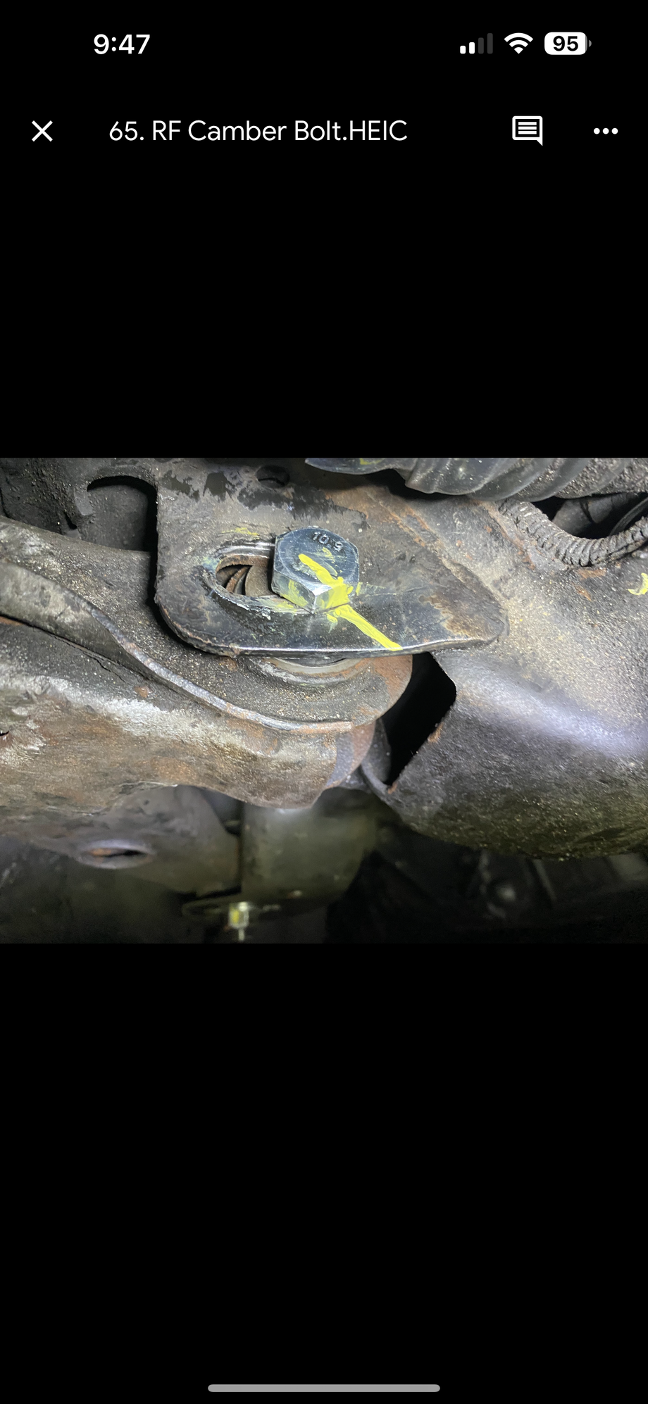

Installed both arms, and got a deal on a OEM GM J tool for alignment off of ebay. Took it to my work and my lead tech and myself attempted to align this thing, but arms kept slipping out of adjustment and wouldnt hold adjustment, and was a big fight to even get it close. Took it to a shop that does lots of alignments and has a few EX GM etchs there. As soon as he looked at it, he saw the issue. The camber bushings werent installed fully and the left one actually came un-pressed! Which would be our alignment fight explained. So having them take arms out, re-press and check all of the GM techs work and then align it... sucks when you cant trust peoples work now a days... /rant
Left side bushing depth after pressing
90* off originally
right side 20* off
Right side before taking it to shop
Left side seemingly unseated and arm against K
