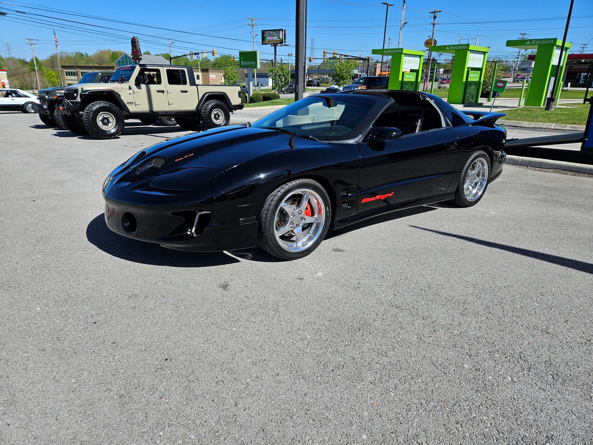

Had qa1's previously didn't care for the ride. Currently on ridetech level 2's still playing with the dial in, but much better ride and more comfortable in the turns. 18" ride with 295 35 18 in the pics.
